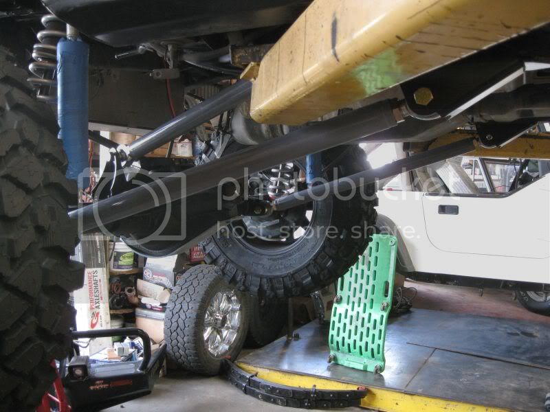

3 Link, Currie Rear Axle, Rear Coilovers and Long Travel IFS FJC Build (and more)
After around a month waiting for misc parts to show up (well still waiting on my bypasses, chormoly links, and axles) its time for some more progress.

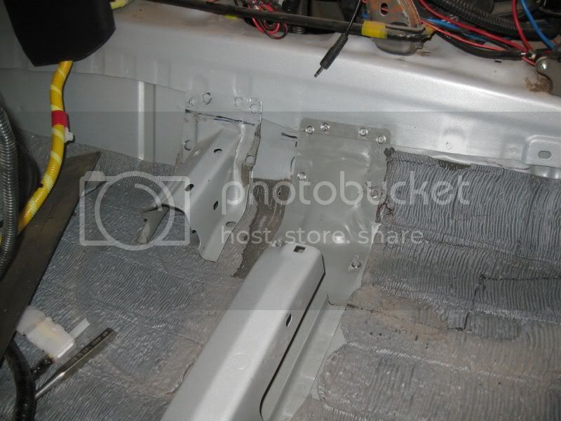

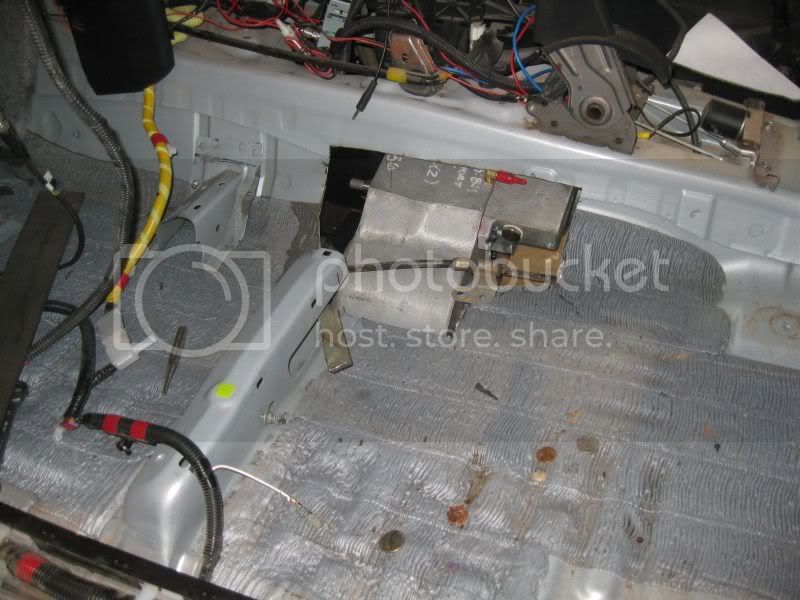

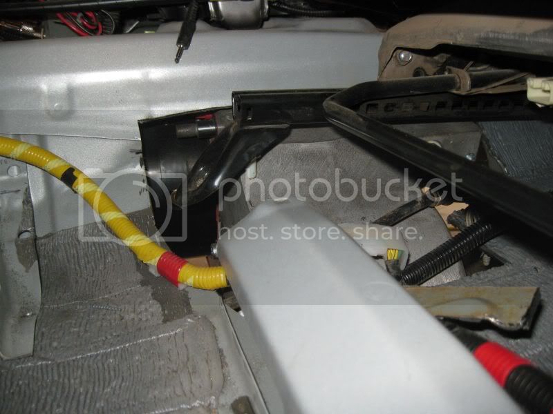

Heading up to the shop now to check out the floor which Dave chopped out to tuck the TC away a bit.​

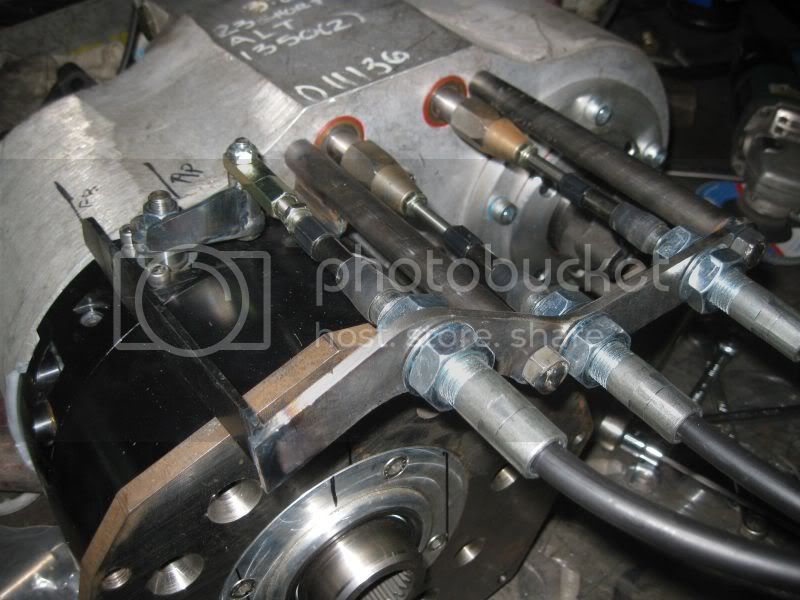

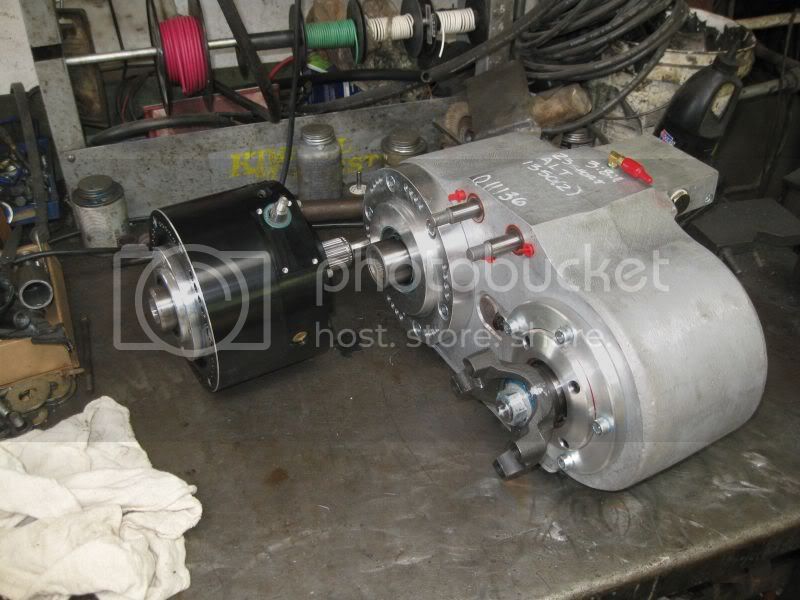

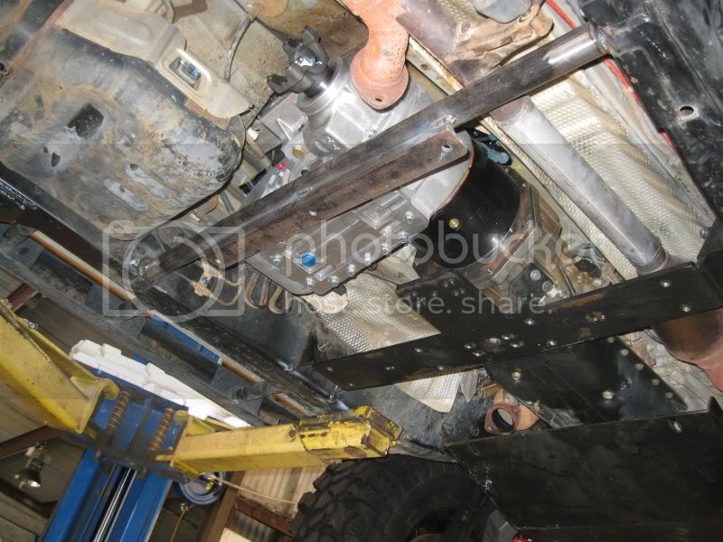

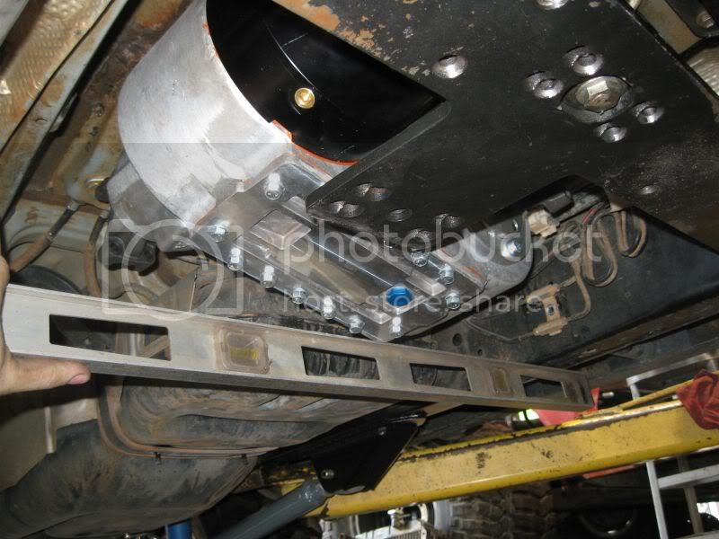

New cross member for the Atlas coming together. It'll have a bushing tied to the rear of the Atlas.
Substantially modified NWF shifter setup going on the Atlas. What they sent didn't quite work due to the adaptor plate

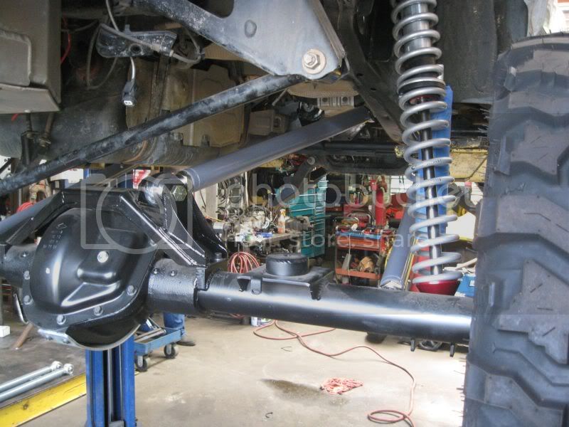

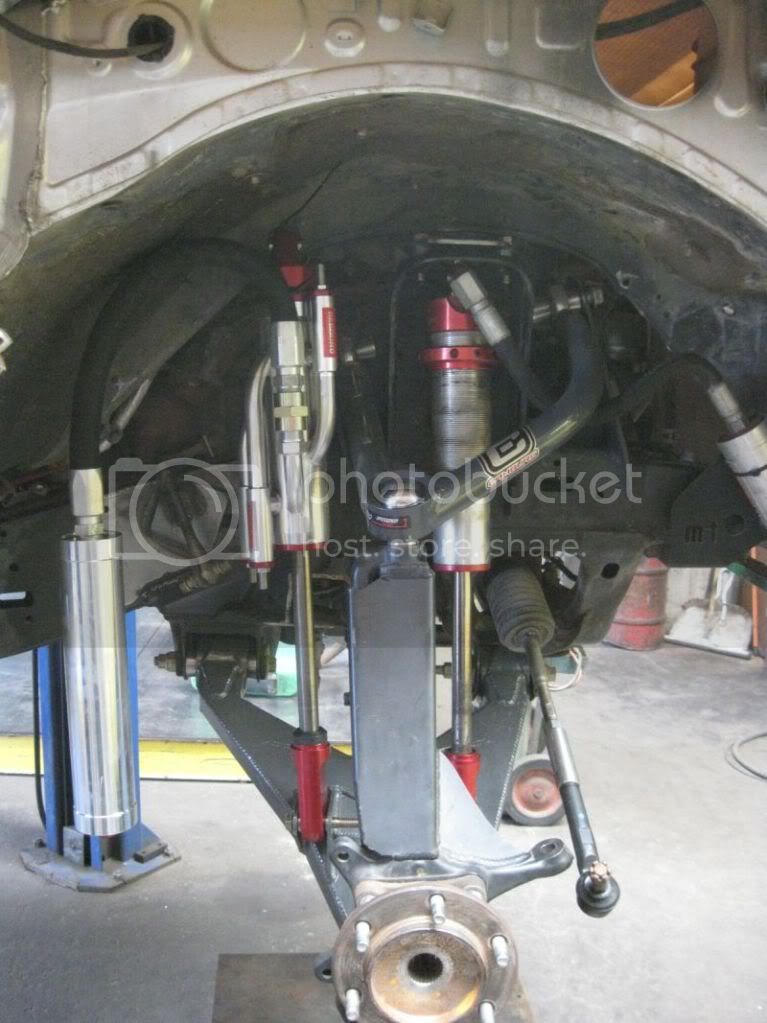

Been awhile since I updated this thread.
4130 HT Links with 1.25" heims to replace the metal tech links and bushings
Dave's working on custom shock hoops - which will be completed once we get the geometry on the axles right. We'll be using the bypasses as bumps, so we'll need to axles back to see how much travel were getting before finishing that up.
