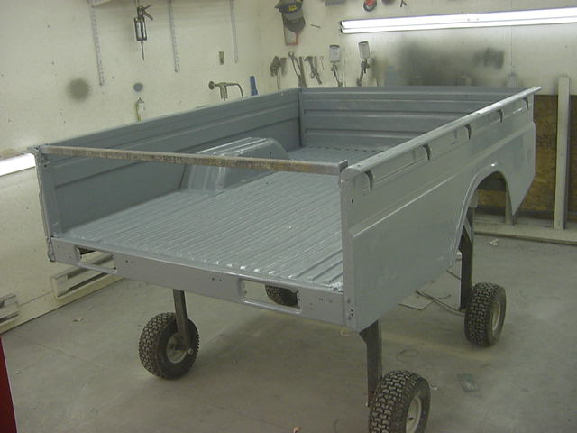

Got about 1.5 on the lpb tonight.
Nothing special, just shot a good couple coats of DP50LF on the box. Also shot a couple coats of DP48LF on my neighbors 40 ford doors.
Primer will be dry tomorrow, hoping to get back to the doors and stuff in the next day or so.
Matt

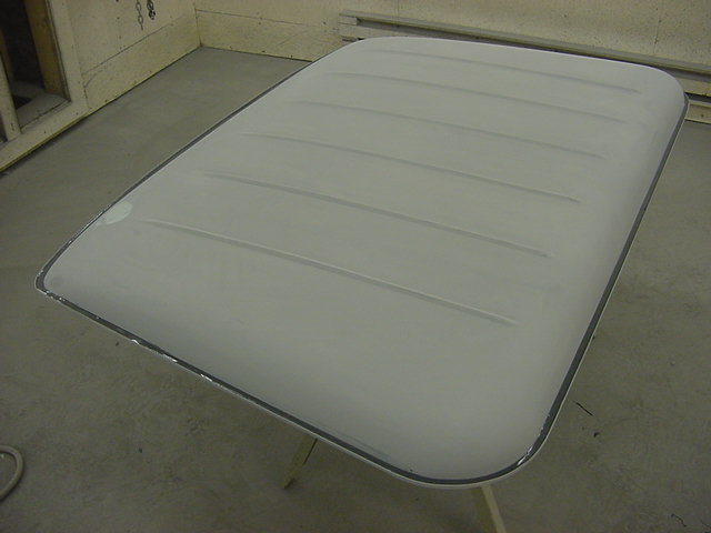

About 8.5 hours on the lpb today, nothing special and not a lot of pics.
Pretty much sanded all day. Blocked pretty much everything out to 150 except for the roof cap. That I got blocked out to 220, then I ran a bead of SEM's self leveling seam sealer around the drip edge. Then I wet sanded out to 400...should be ready for base/clear anytime I'm ready which should be in a day or so.
The other stuff got another coat of ureathane primer, more block sanding tomorrow. If all goes well should be able to block everything out to 220 tomorrow and then it's ready for paint. If not, more primer and more sanding.

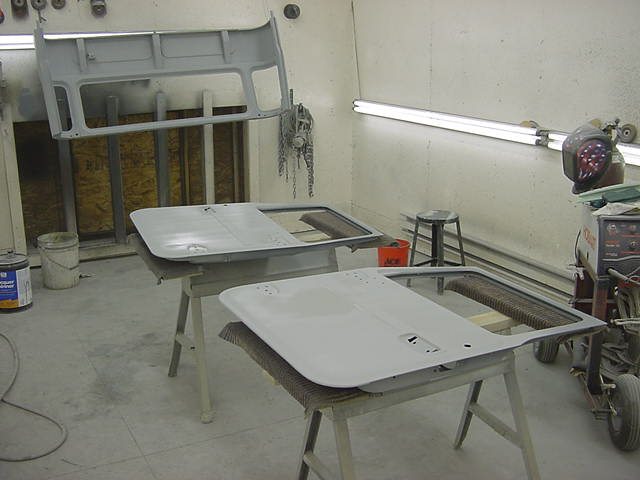

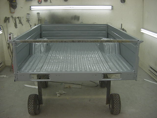

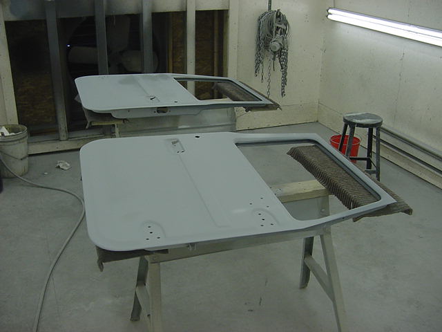

Got about 9 hours on the lpb today. Nothing special, but moving ahead.
The majority of the day was spent sanding. Got everything blocked out to 220. The rear cab and hood are as good as there going to get, they look pretty decent. I plan on shooting 1 light coat of epoxy prior to shooting base. The doors need 1 more coat of ureathane, they were close....but 1 more and they will be perfect. So those got a couple coats on the outside and will have to be blocked out again tomorrow or Tuesday.

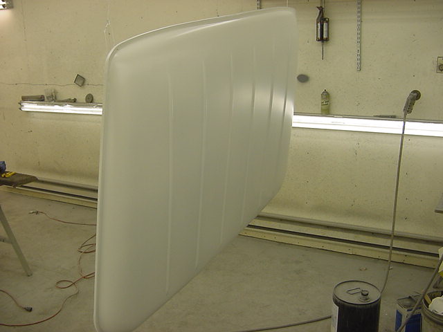

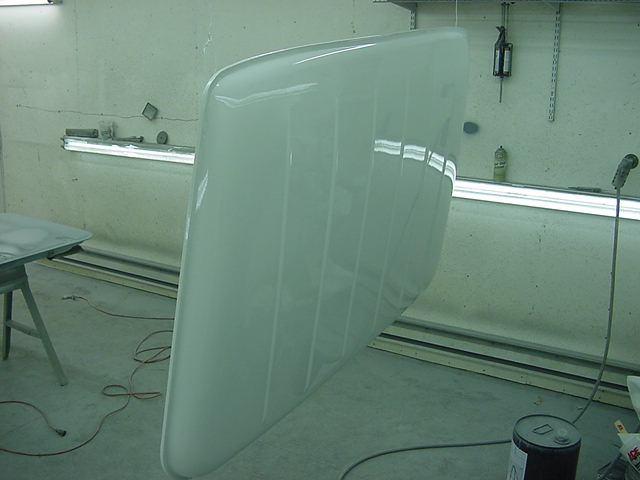

Managed to get the roof cap painted. I actually shot a coat of DP48LF (white epoxy primer) first. Let that dry for about an hour and shot a couple coats of base, same base I used on the lv...had a lot left in the can so figure I better use it up. 2 coats of DCU2021 clear after that. Turned out pretty nice, couple runs towards the bottom so I will be sanding and buffing tomorrow night, but shouldn't take more than an hour. It's about -20 below zero right now and when the fan is running it cools down the booth in a hurry, hard to keep warm while painting when it's that cold.

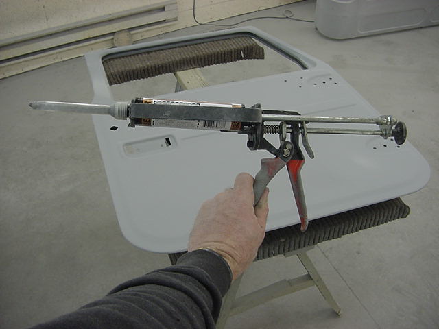

Couple other pics for Membersfield. I think 1 of them is high build self leveling and the other is the regular seam sealer. I used the regular stuff on the bottom of the roof cap where that piece is spot welded to it. Figure it wouldn't hurt to keep a little moisture out of that area. The self leveling is just what it says, you run it a trough and in a few minutes it levels itself out...works pretty good. The other one is a pic of the gun you need to apply it.
