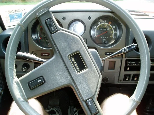

Matt I have used a steering wheel from a FJ60. It's smaller in diameter than yuor stock one, the stock horn works and it says landcruiser. The turn signals don't automatically turn off though.
I suppose you wouldn't happen to know the dia.?
I'm liking these ideas, just not sure if it's enough?
Thanks, Matt
I've got a 60series Sahara wheel on mine. is 1inch smaller than standard wheel and soft touch. Much nicer feel
Pretty sure 75series wheels fit to.
fj60 wheel
Yeah, the fj60 wheels are pretty good. Especially if you put the leather wrap on them.....

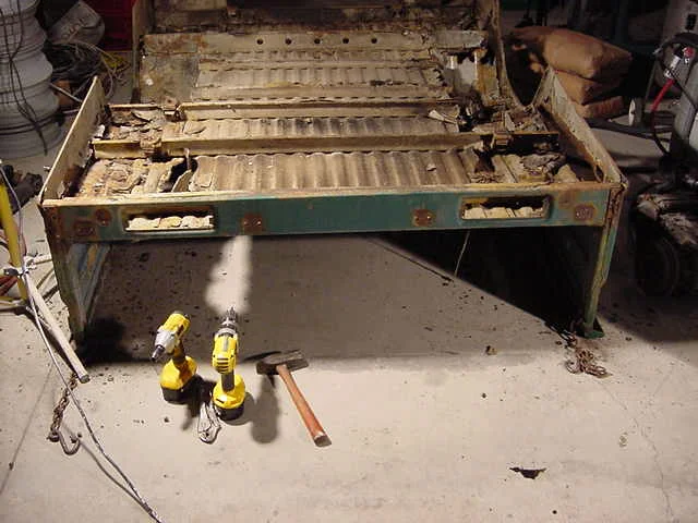

About an hour or so on the lpb tonight...really nothing accomplished.
Currently in a winter storm warning up here and supposedly some significant snow fall is coming tomorrow. I guess I figured all the other parts were inside, and I didn't want to be digging the boxes out of the snow in a few weeks.......so they got bumped in the schedule.
Had a couple of my neighbors come over and give me a hand. Flipped over the good box upside down and set it on my cab stand and then rolled it inside. Then flipped the orgininal box over on the ground an hauled it inside. At least now I don't have to dig them out of the snow.
I am going to remove the rear valance on both boxes and get the 78 valance installed on the other one. Although it doesn't look like it because there is undercoating all over it, the 78 valance is in really good shape.

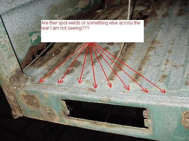

Question: Are there spot welds across the rear of the bed on that piece?? There are 4 bolts on each end that need to be removed, I can see how it is going to come apart there easy, but not sure how it is fastened across the rear length of the bed? If it is spot welded, there not jumping out at me?
Man, that 78 box is shot...............:rolleyes:
Thanks, Matt
As far as I can recall, yes, there are. I have a dent in my valence right at the tail light and I tried to remove it for ease....and I gave up because I didn't want to drill right then.
Matt, On my 65 the spot welds were right between where the humps would be if they were continued all the way to the rear of the bed , and i think there were some down each side also. I will see if i got a pic of that from mine.
Got no pics, but i think you get the idea.
