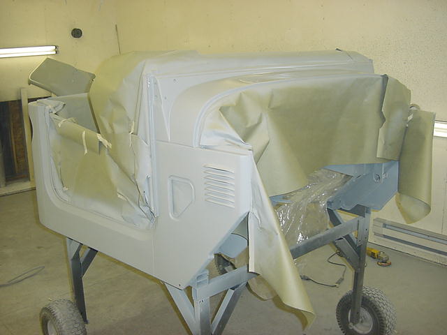

Got about 3 hours this evening on the lpb.

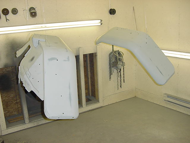

Sanded down the new fenders I had got from Cruiserdan with 80 grit and the DA. After that, hung the up and shot a good coat of epoxy primer, bottom and top. I rolled the the body back in and papered up around the edges. I have been sanding on the inside of the cab and didn't want a bunch of ureathane primer overspray.
Shot a couple coats of ureathane primer on the fenders and the cab. I will have to block out the fenders with 220 grit still, but the cab now has a coat on it for wet sanding. I still plan on spraying the inside of the cab with a coat of epoxy primer.
Hope to get the cab upside down in the next couple days. Have a lot of seam sealing to do on the bottom before the SEM sauce, but hoping to be shooting SEM on the bottom of the cab and fenders by the weekend.
Matt

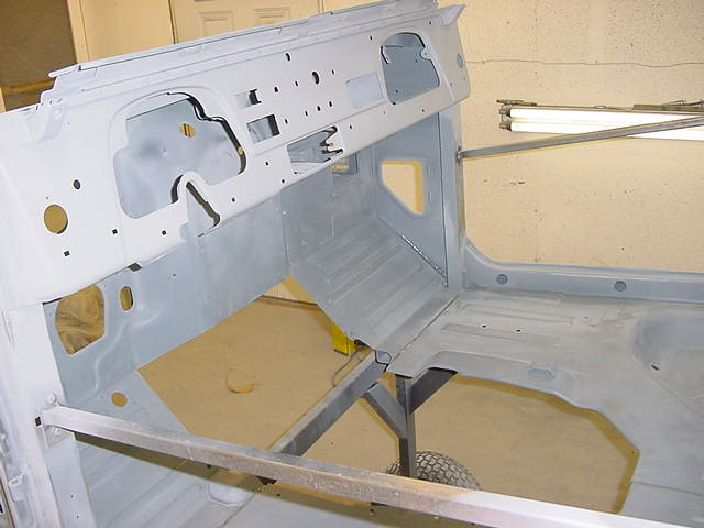

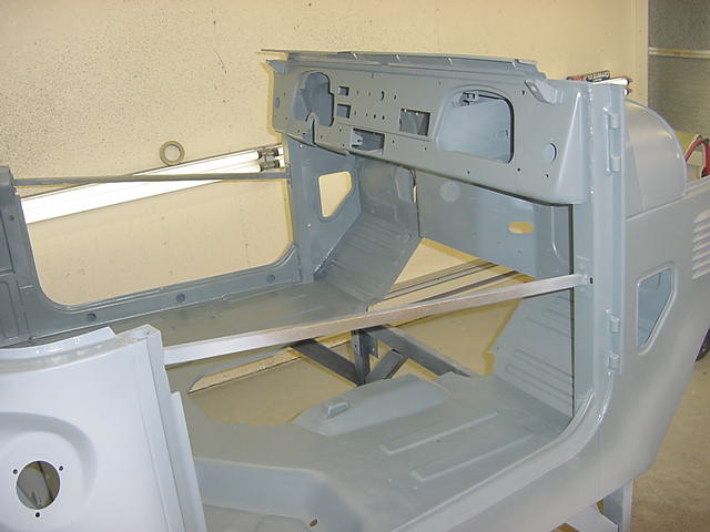

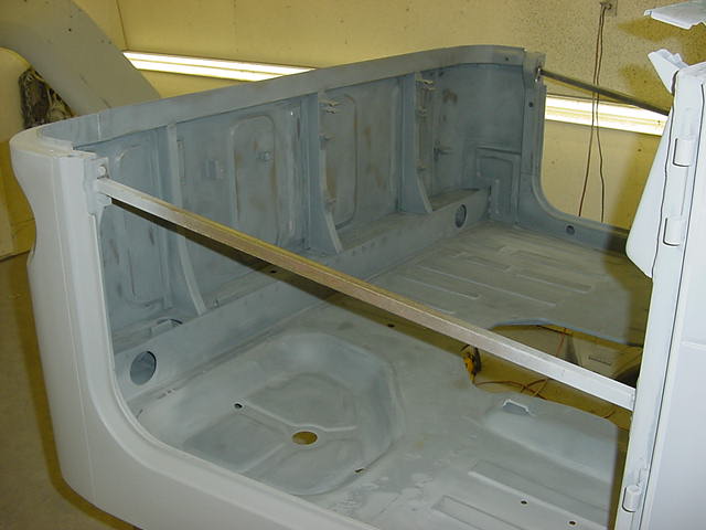

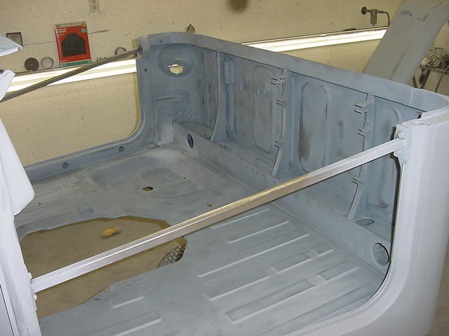

Got about 2.5 hours on the lpb tonight.
Got out in the booth and blocked out the fenders with 220, that took almost and hour. I have been sanding the inside of the cab with 220 and a scotch brite pad. I spent another hour so making sure I had hit every corner, included the firewall...outside and inside. A little anal rententive on my parts since the inside all gets covered up with floor mats and seats.....but, I just can't help myself.
Got everything wiped down and ran a tack cloth over everything. Then shot a coat of DP50LF on the inside of the cab, firewall and fenders. Few pics of the before and after shots.
Also picked up some needed material from the auto parts store today. Clear, harderner, base and single stage ureathane...without the binder. Took the lid off the base.....you get the idea. ;) Man that is one ugly color :D
