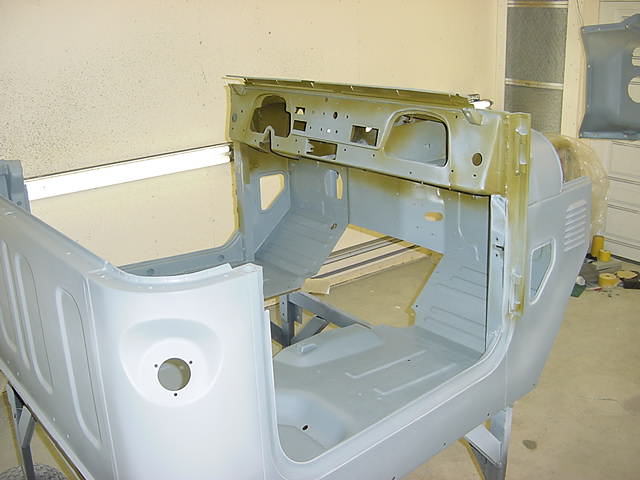

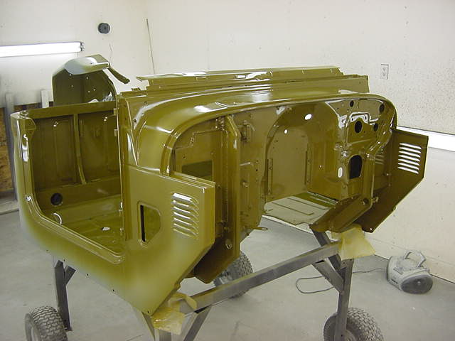

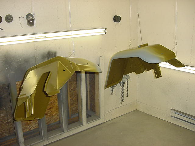

Got about 2.5 hours on the lpb tonight.....nothing special.....
Came home this evening and started hauling parts out of the paint booth. Got the fenders and tranny hump out and then the neighbor came over and gave me a hand flipping the cab back over and setting it on the stand. Rolled the cab out and wanted to give the booth a jiffy tune up. I have been sanding in there quite a bit and like to clean up before I shoot clear. Swept everything up and blew everthing down, walls and ceiling.....then got all the parts back in.
I busted out the anal rententiveness and felt I needed to do a little wet sanding. I thought the dash and door jams could use it.....they looked pretty good to begin with, but now a little better. Shot a couple spots of epoxy primer in a few areas. After that I figure I better just wait until tomorrow.
I have to work tomorrow night so hoping to get up tomorrow morning and shoot a little base...and maybe clear, well see.
Few pics of the parts from this evening.
Matt

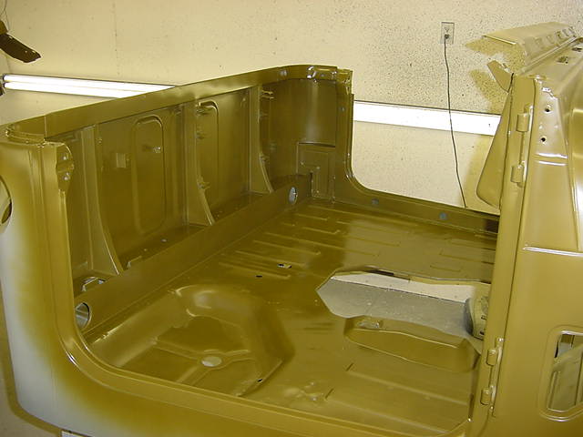

Got about 2 hours on the lpb this morning.
Have to run to work this afternoon and work late, but did manage to get the base on. The pics you see are just the base coat (color).....NO clear yet.
It would have been pushing it a little this morning if I would have shot clear so I think I am going to just wait until after work late this evening. So I can take my time and not rushed.
Base layed down pretty nice, should look good with the clear on this evening....hopefully....
Matt

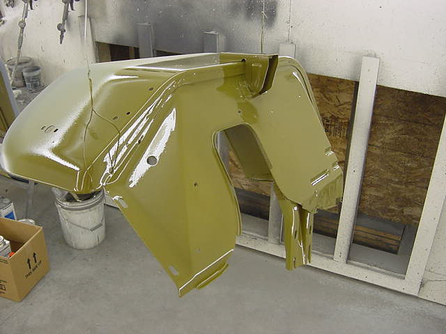

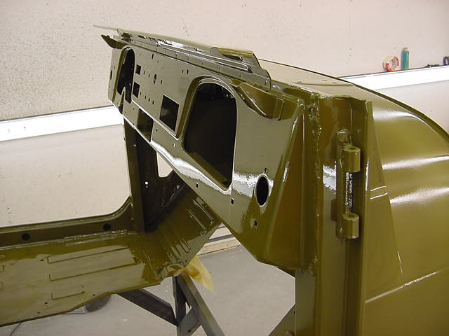

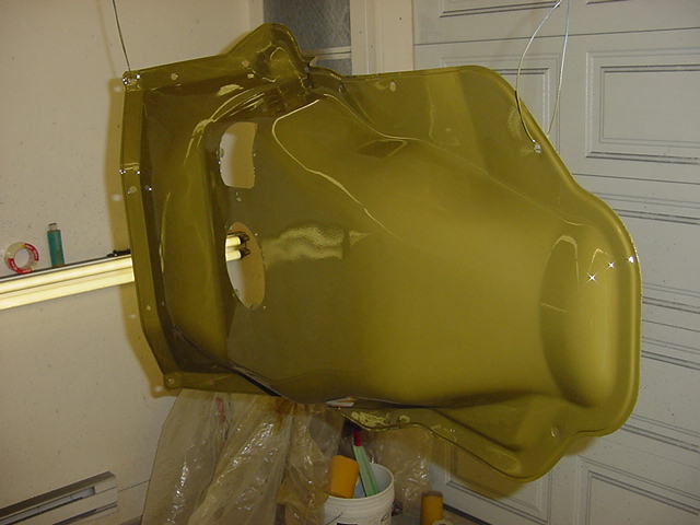

Got home from work tonight, 1 hour in the booth.
Tacked clothed everthing down, 2 coats of DCU2021.
Few pics of the glamour shots, layed down pretty decent.....should looked good underneath the floor mat ;p
Matt
