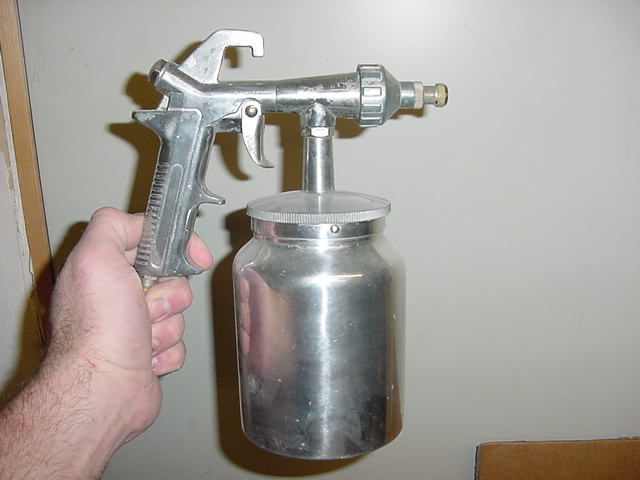

Pic of shutz gun, 1/2" tip.....a must!!

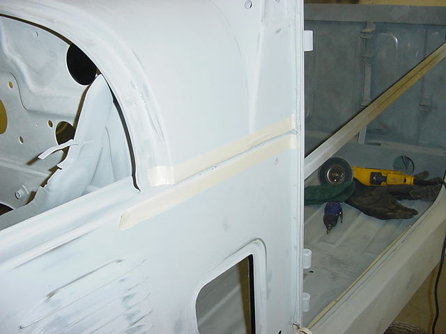

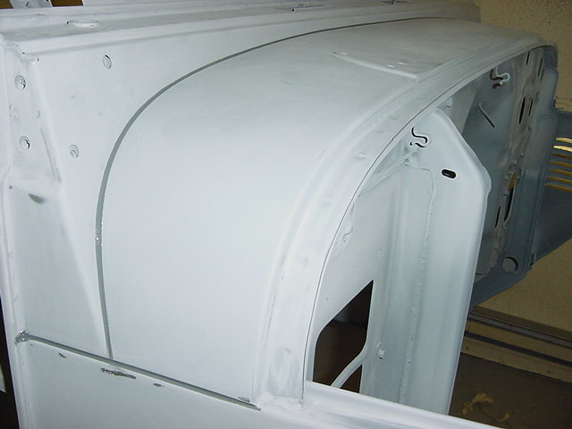

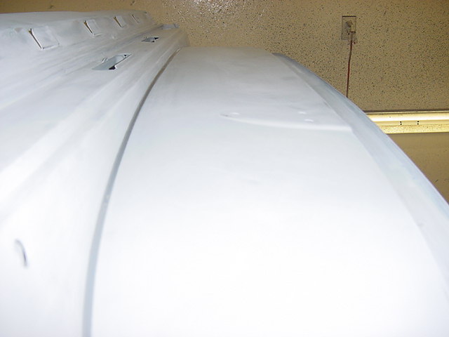

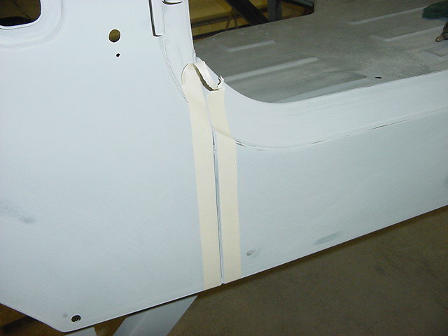

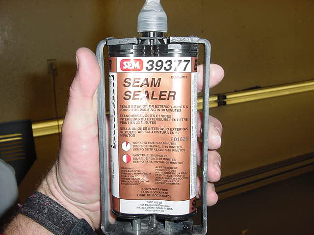

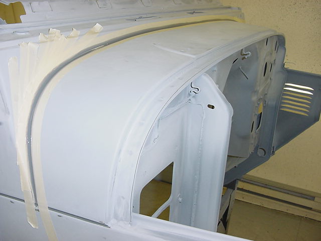

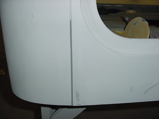

I had to work this evening so I got about 2 hours on the lpb this morning.
Pretty much applied seam sealer to the locations where it was orginally, but I had to take it out. Pics pretty much say it all. I use masking tape along each side and smooth it out with my finger. I then pull the tape to get a nice clean line with the seam sealer....I think it pretty much looks like factory. Some of the seams had the factory seam sealer still in it further up, I just faded the new stuff into that.
Also had to do some seam sealing on the inside, but didn't get any pics of that. Hoping to start doing some work on the fenders in the next couple days and try to get them up to speed. As I said before I would like to shoot the SEM sauce on the bottom of the fenders the same time I spray the bottom of the cab.
Matt
