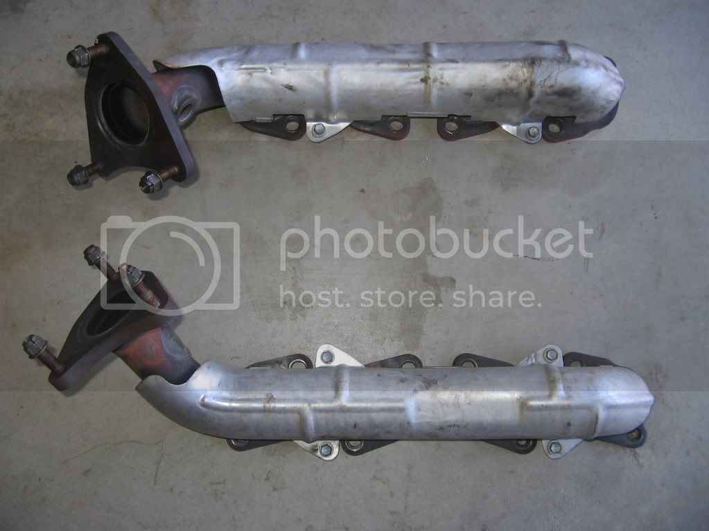

So this is interesting. Look at the illustration for the headers vs the actual image. Do you suppose that the VVTi years incorporated an OEM header? Or is it just a drawing that is different than reality? Anyone with an 06 or 07 care to take a peek inside their fender well and compare shields? Bamachem?
The collector pipes look the same so I would think it would still bolt up but the improvement might not be the same? The extra 35 hp had to come from somewhere... perhaps it's not just the valve timing.

I will try and get some pics of the 06 at lunch tomorrow.... I ordered these for the power gain, and to prevent future problems.
These pictures are of the passenger side.

It is very interesting. From the 2006 illustration, it sure appears like T added headers instead of the exhaust manifolds. In the online program, they still refer to them as manifolds though.
Even if they have a different shape, I would assume the DT headers would still fit. That is assuming there are no other changes in the engine bay that would affect clearance. have to wait and see what the pics Sr. Gringo posts. I don't have access to an 06 or 07 model.
Those pictures look similar. I bet you'll be OK. Anyway you could get the shield off and look at the manifold its self? Maybe someone should check the gasket part# on the diffrent years and see if thats the same?
I don't think the issue is really whether the DT's will fit an 06, but rather if they will benefit an 06. If the 06 manifolds are truly headers as shown then there might be minimal gain. If it's to solve a crack/leak then that would be a harder decision: spend $550 parts on DT's and labor to R&R both sides or $290 on a replacement OEM and just redo the one side.
Based upon the dyno charts we've seen for the DT's on the 4.7 and the 275 HP on the 06, I'm inclined to believe it's more than just the VVTi. Really curious to see what an 06 heat shield looks like.
