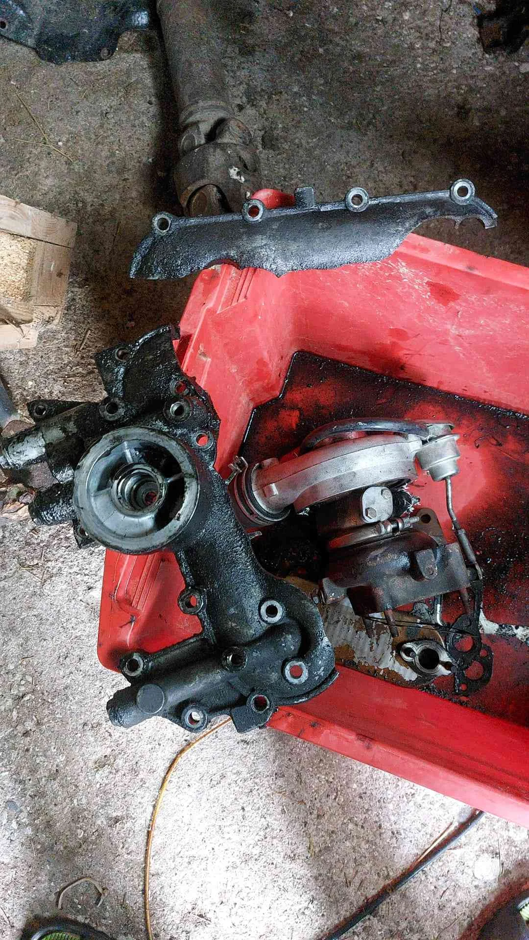

Fantastika Joined Apr 17, 2023 Threads 30 Messages 109 Location Latvia Aug 31, 2023 #1 I think i found the reason why the head was toast. The previous guy used water instead of coolant which froze and cracked this in half, all the water leaked out, the temperature gauge doesnt work so it overheated
GTSSportCoupe 2LTE abuser 10 Year Joined Mar 23, 2012 Threads 242 Messages 9,562 Location Victoria, BC, Canada Aug 31, 2023 #2 It's cast aluminum, so I doubt its repairable. I suggest trying to find a used one somewhere.
Fantastika Joined Apr 17, 2023 Threads 30 Messages 109 Location Latvia Aug 31, 2023 Thread starter #3 GTSSportCoupe said: It's cast aluminum, so I doubt its repairable. I suggest trying to find a used one somewhere. Click to expand... I bought one on ebay from some guy in Dubai for 190 eur, couldn't find it cheaper anywhere else
