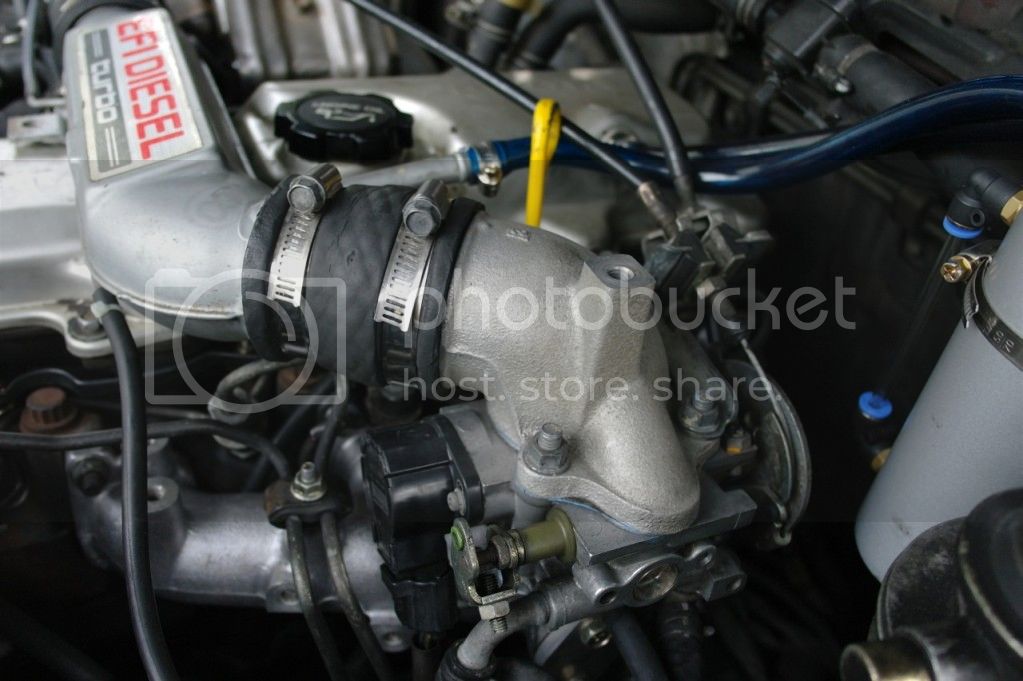

Your engine is probably being starved of air which is causing the white smoke. I think this is because you also removed the VSV which controls the second throttle plate in the intake. This is ok, but you need to force the small secondary throttle to be open all the time. This will fix the smoke immediately. On my engine, I removed the large throttle plate completely which also fixes that problem, but you don't have to do this. Here is a picture showing the part I'm talking about. It is the shaft that sticks out of the throttle body at the bottom center of this picture. Mine is hanging free because I removed the throttle plate inside. But you will need to force yours open.
