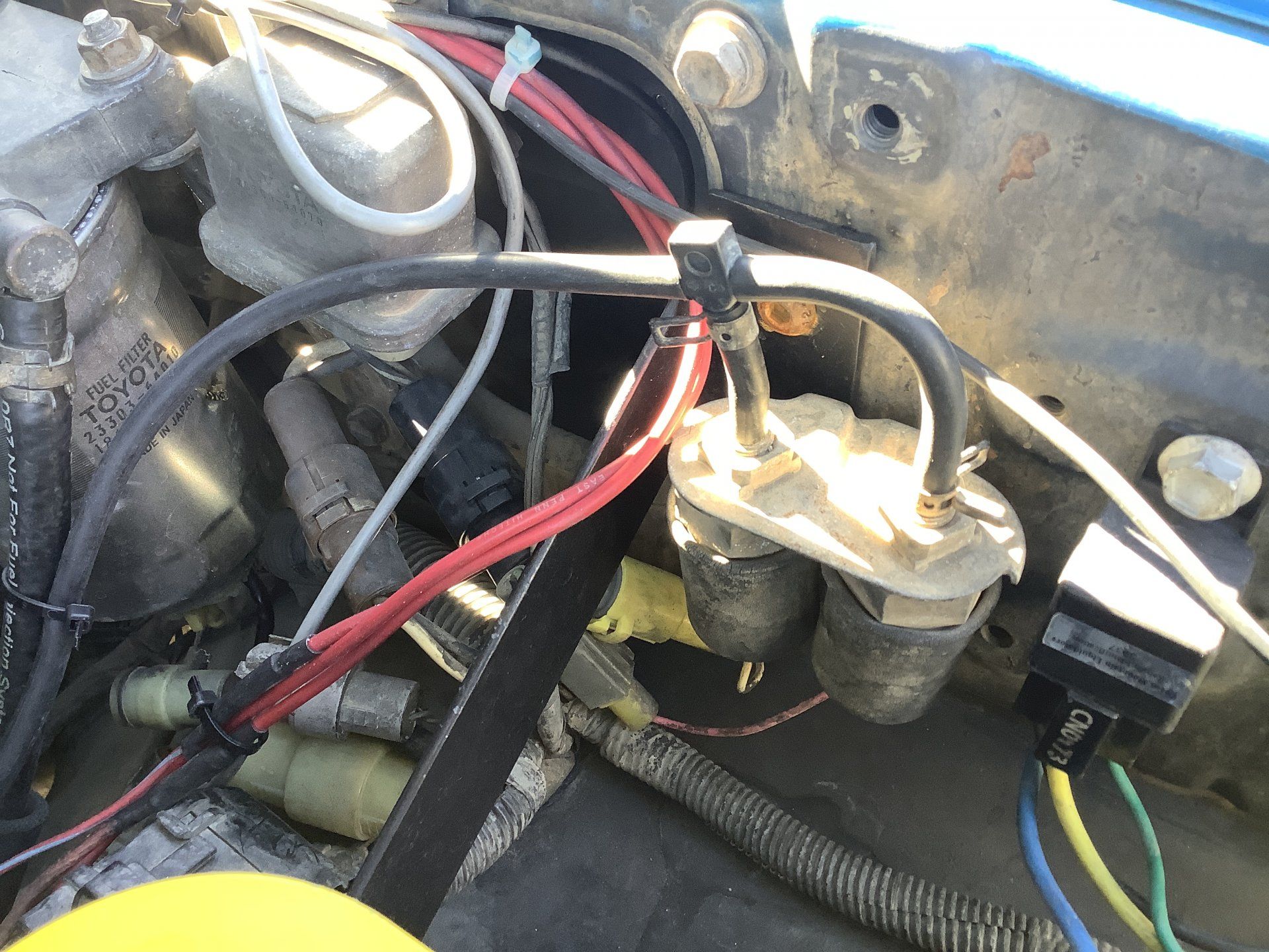

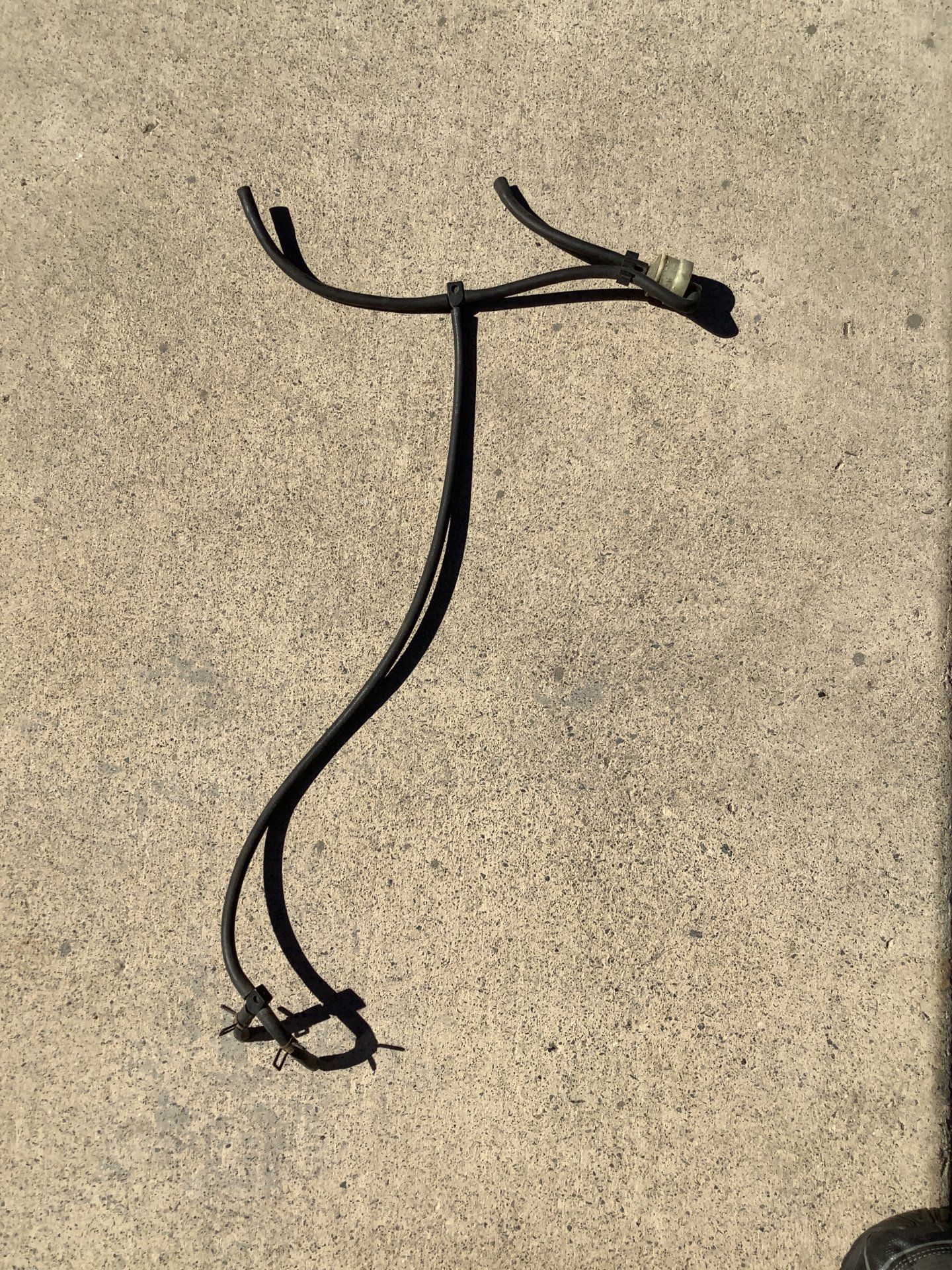

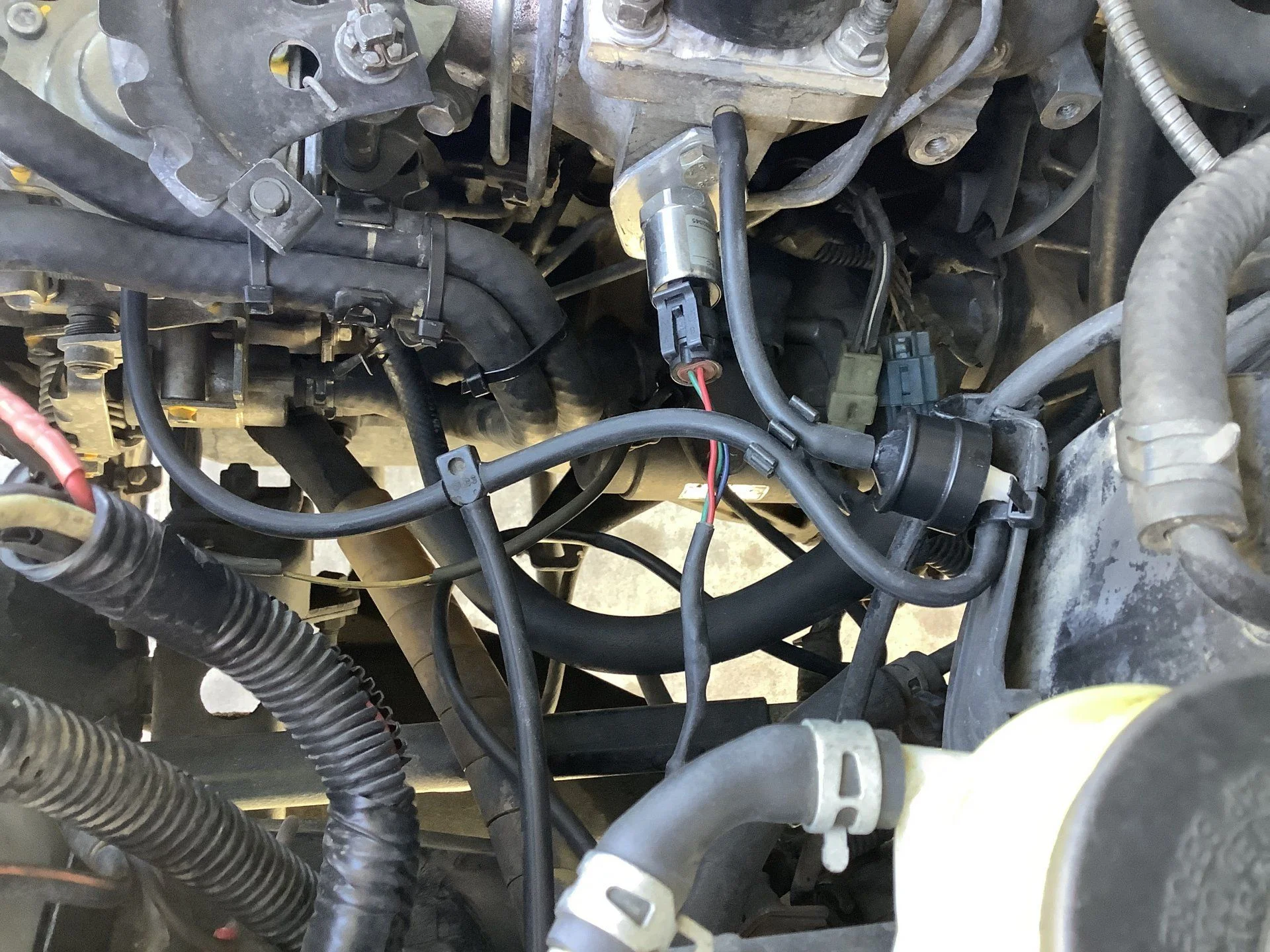

@Hilixsurf93bigb, I just did this job. Get some 3.5mm vacuum hose. and (2) tees, and a Filter.
Easy.. 10 minutes after you have all the parts.
Filter Part # 90917-11033
See attached pics.
Keep in mind, this is for a 2L-TII dropped into a 1989 LJ70.
You may not need the tee off to the turbo boost sensors in your set up.
You may be able to get by with just vacuum hose from Intake to "gas filter" to Injection Pump..
In the very, very, very short-term, you may just run vacuum hose from Intake Manifold to IP to see if it runs any smoother.
Not exactly familiar with what is under the hood of your vehicle.. you didn't post any pics (not sure if you have those sensor or not).
