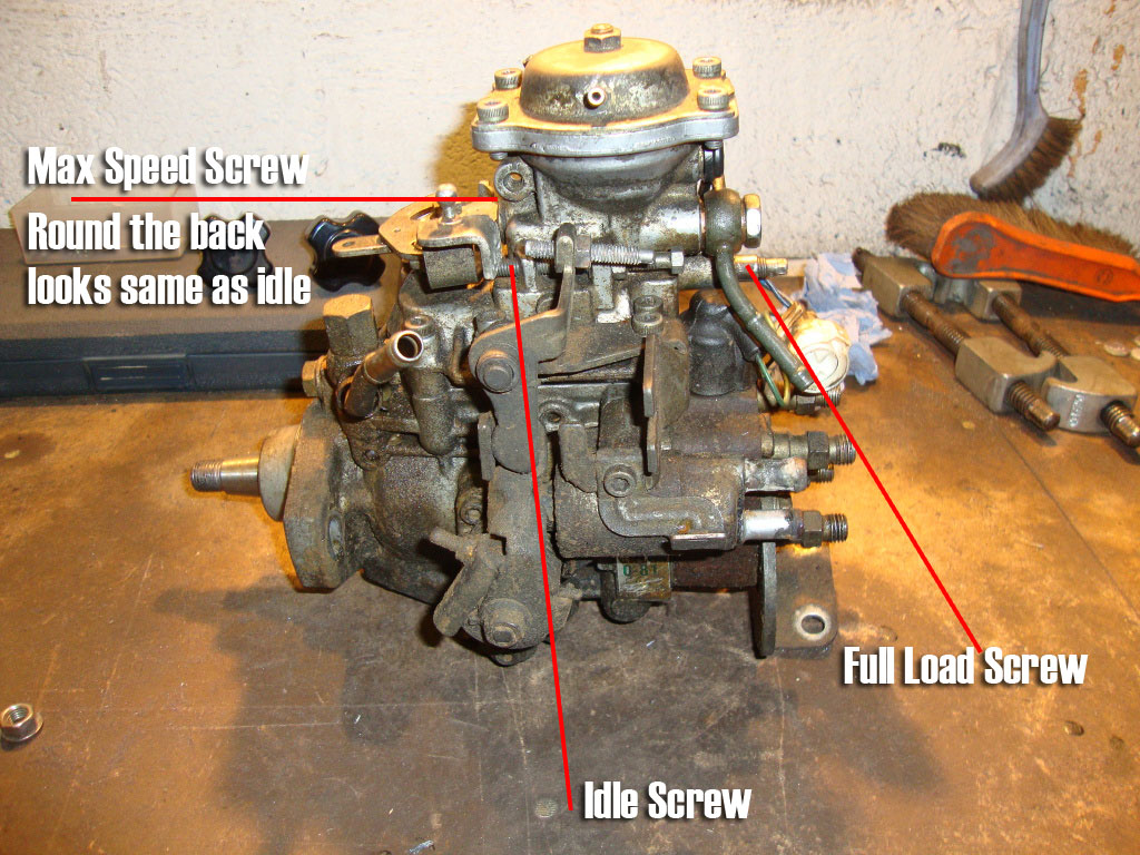

I can't speak to what the 2L-T manual says but my 3B owners manual says to start the truck with the pedal fully depressed for a cold start.
Some engines like a little extra fuel at start up.
So either add it with your foot or increase fuel at the pump.
I would adjust the pump for winter and summer with the screw. Adding fuel with engine running will increase your RPMs, so adjust idle accordingly.
Turn 1/8 to 1/4 turns till satisfied, best to mark your settings in case you screw up.
This "Smoke Screw/Full Load Screw should have a locking outer cap of 14mm.
JT & Squash, Thanks for the replies and detailed diagram.
