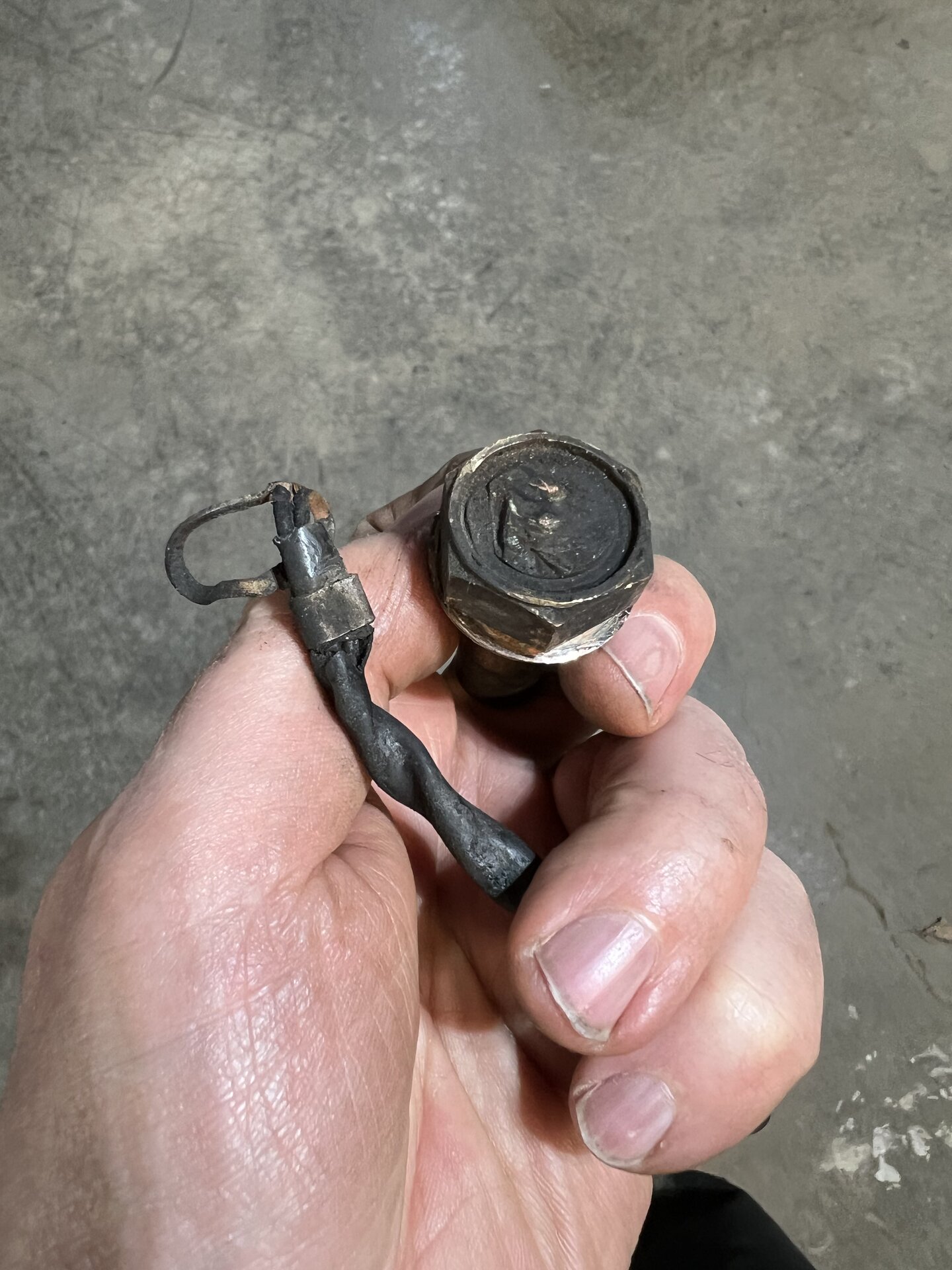

Broke my 2H tach sensor wires. Anyone know the part number? I can’t find it on toyodiy. Anyone got a spare? Anyone successfully re attached the wires? Thanks
Had the same problem. Replacement part is $$$ so I carefully removed the resin around the wires in the sender unit and soldered on new wires, then used hot glue to waterproof it again. Been running fine for 3 years now. Cheers

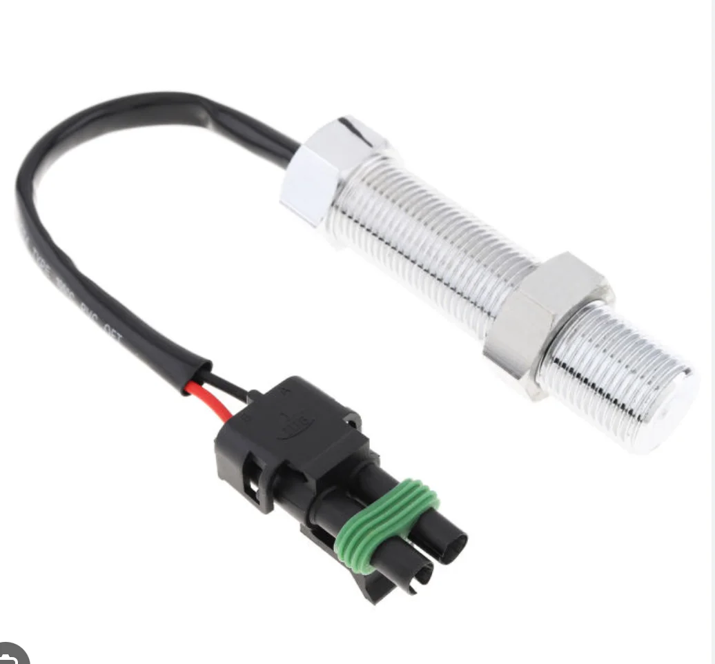

I have always wondered if it would not be possible to use a generic sender unit using the same Hall-effect principle. They all have 2 wires, essentially sending out a pulse for every revolution, no? The only thing to watch out for is the distance to the fly wheel, but you can get them with adjustable depth. Something like this
It might be pulses, but it also might be the case that the OEM sensor isn't sending pulses like we're used to in modern tech, but is a variable reluctance unit plugged into an analog circuit of the tach. Meaning the change in current/voltage on the sensor is proportional to the tach's arrow climb.

– see if it's gonna work with the "universal" chinese diesel flywheel sensors. Imagine if these things have the same thread, lol
