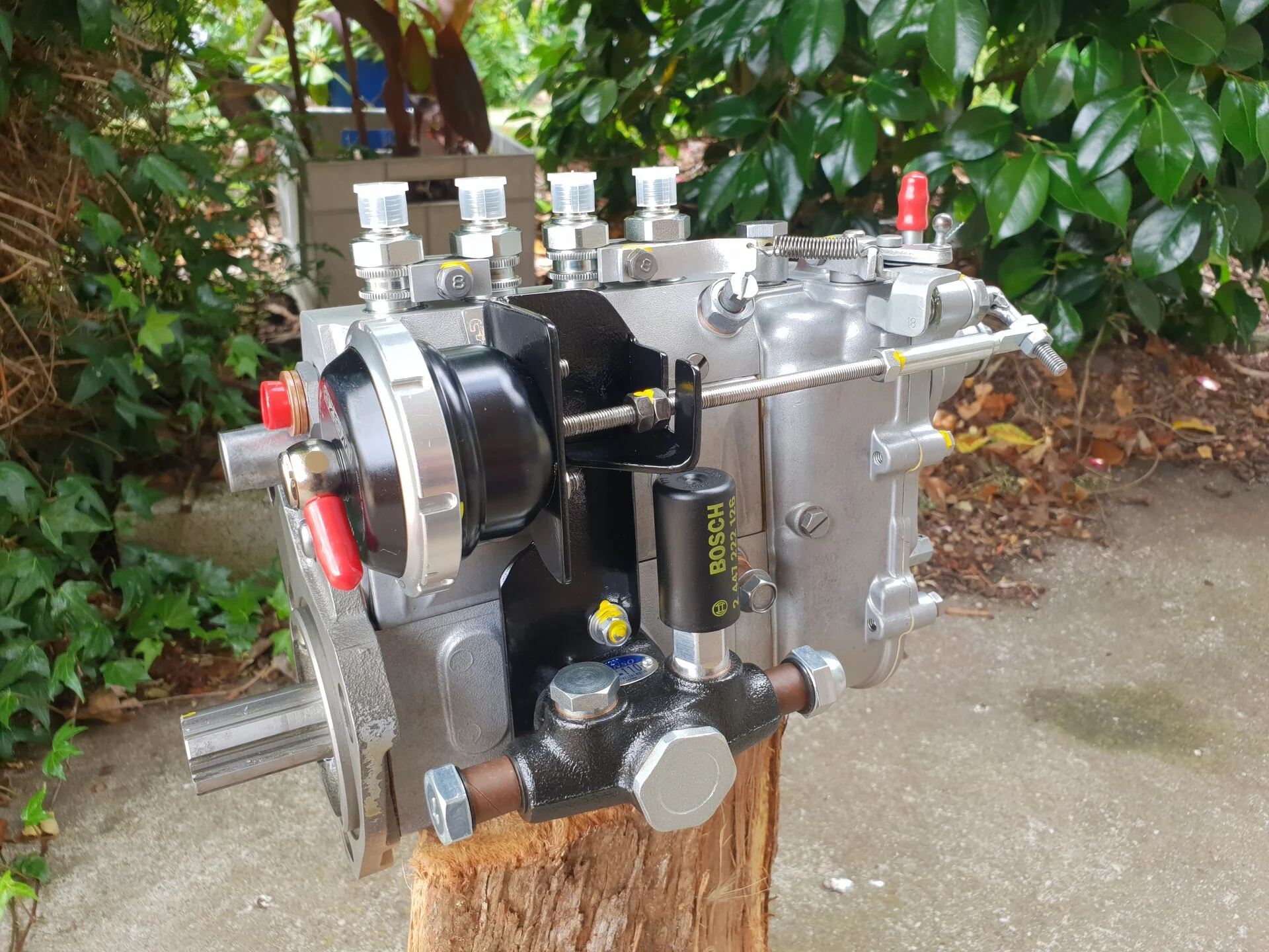

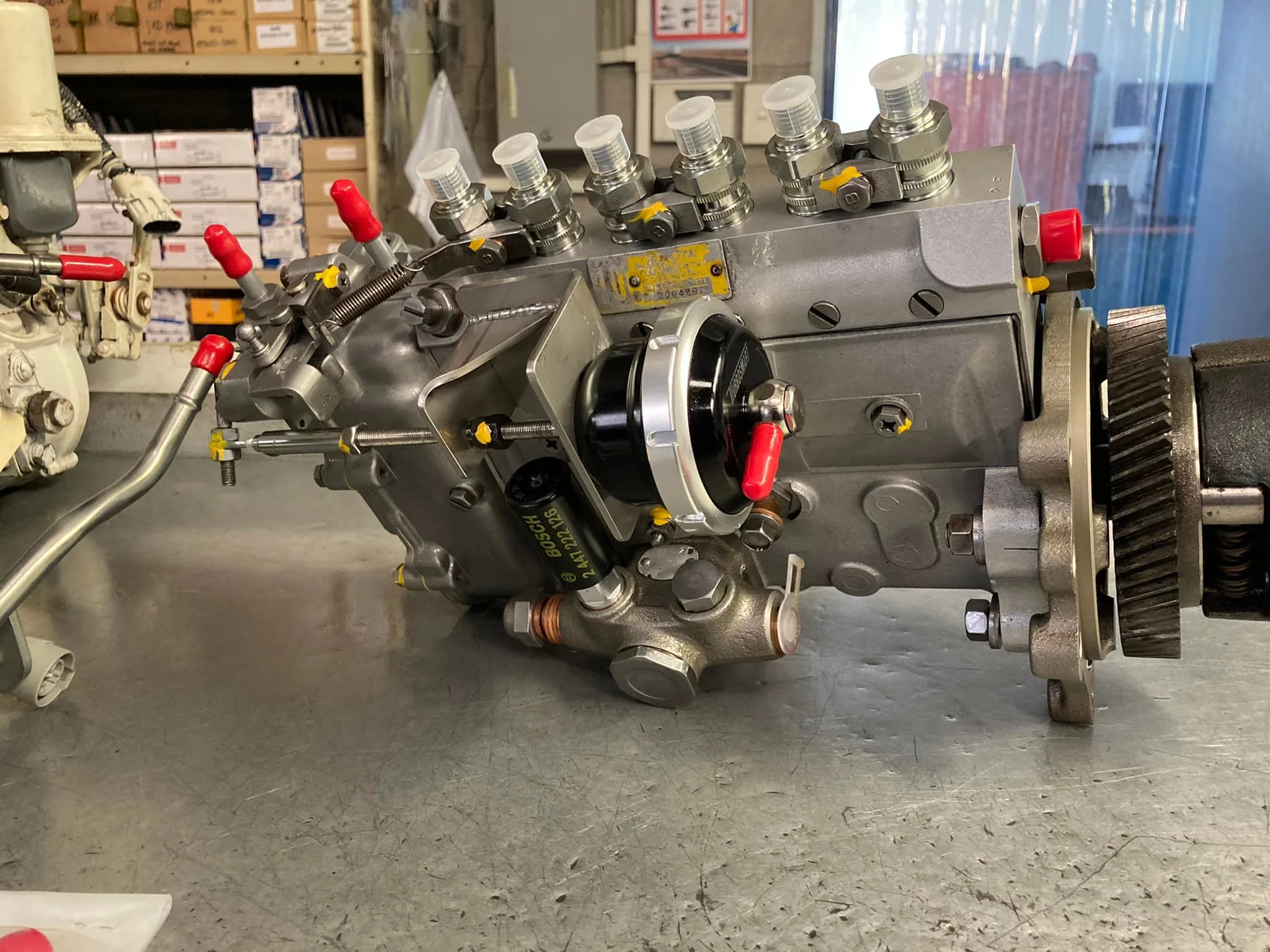

I've seen a few DIY boost controllers for 2Hs over the years.. JH Hilux in Australia do one. They take the place of the fuel screw. There's nothing special about the overfuel position inside the pump, when the EDIC pulls the Fuel Control Lever back to Overfuel it just allows more rack travel. A macgyvered Boost Controller could certainly provide for that range of movement too.
JH Hilux..
Let's check my understanding.
The fuel screw has a built in spring pin that the rack and fuel lever cannot move on their own. This is the normal rack upper limit. The EDIC overcomes this spring pin when commanded to overfuel, shifting the upper limit and allowing the rack to move this extra distance.
In the case of JH Hilux boost controller, the rack upper limit is set by the boost controller's linkage that pokes through where the now removed fuel screw was (the linkage and therefore limit moving with varying boost pressure).
Yes.. the leather diaphragm cannot pull back hard enough to overcome the spring.. only the EDIC has the ability in a stock setup to overcome that spring whilst cranking. My HJ47 only has a stop cable and no EDIC, I have never struggled to start in cold weather (but we're only talking -2degC at most), I really dont think the overfuel function is needed.
Your understanding of the JH Hilux setup matches mine, I havent seen this pump in person though and cant confirm if he might have implemented a spring in there that the EDIC can pull against..

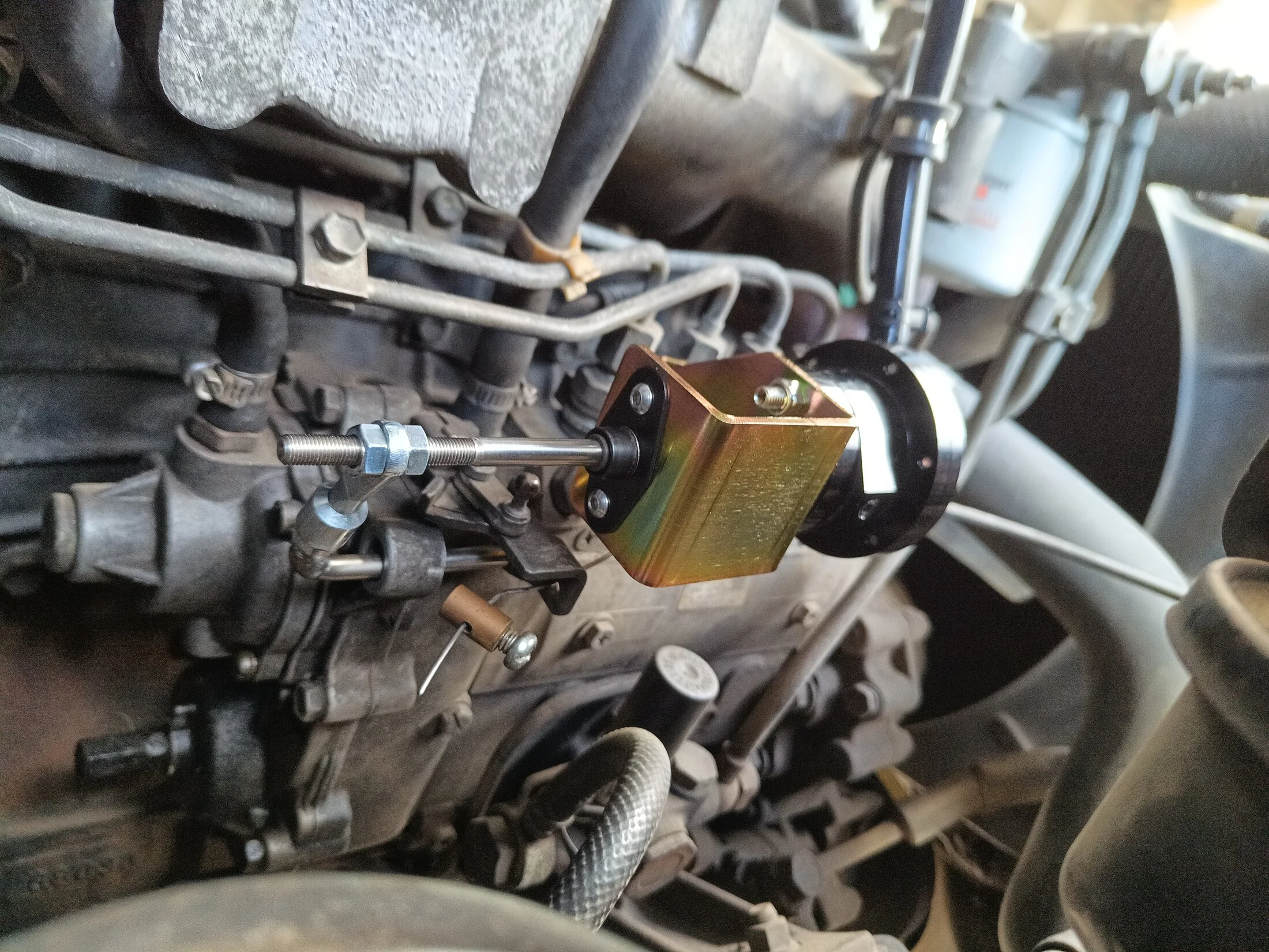

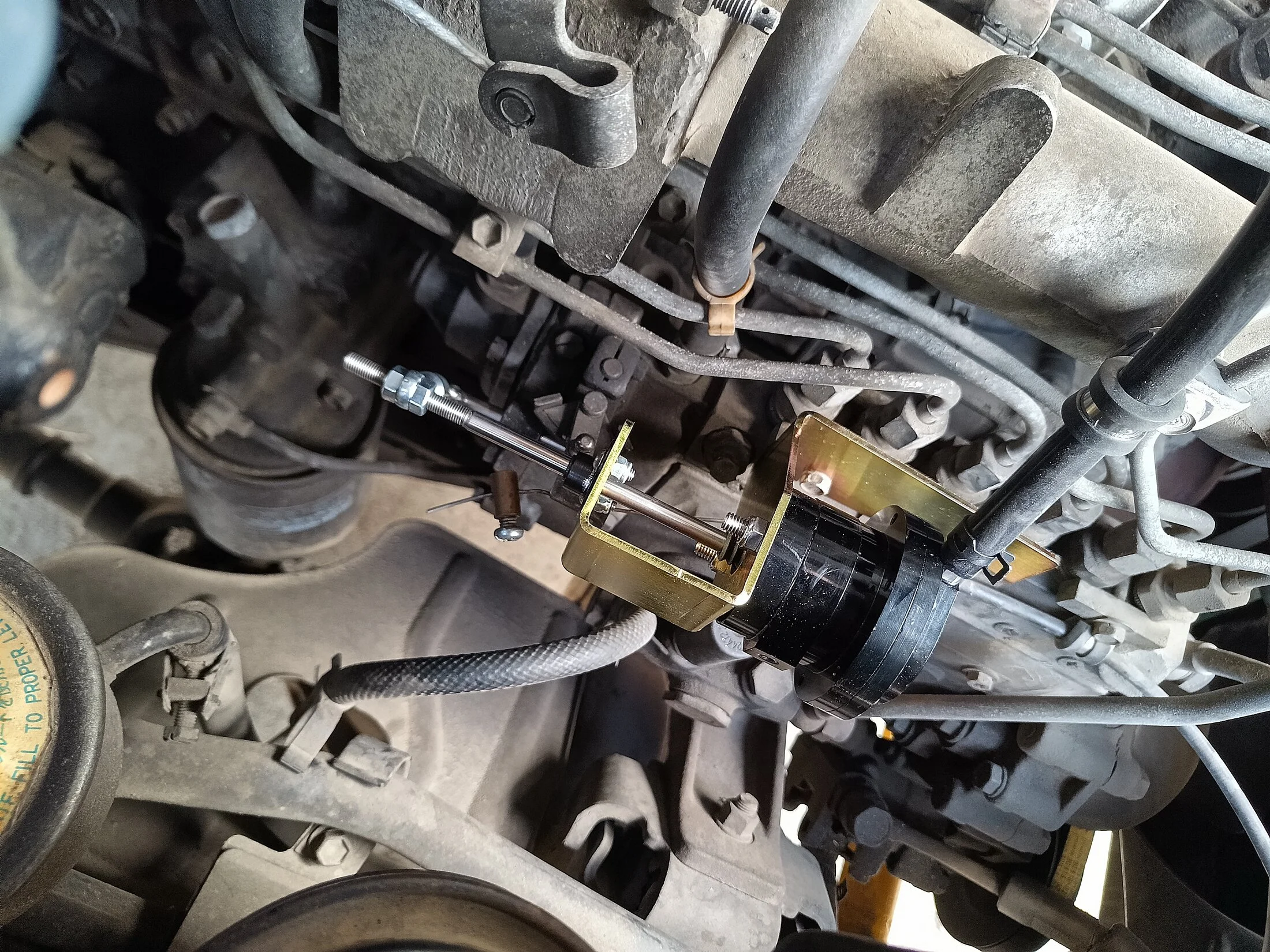

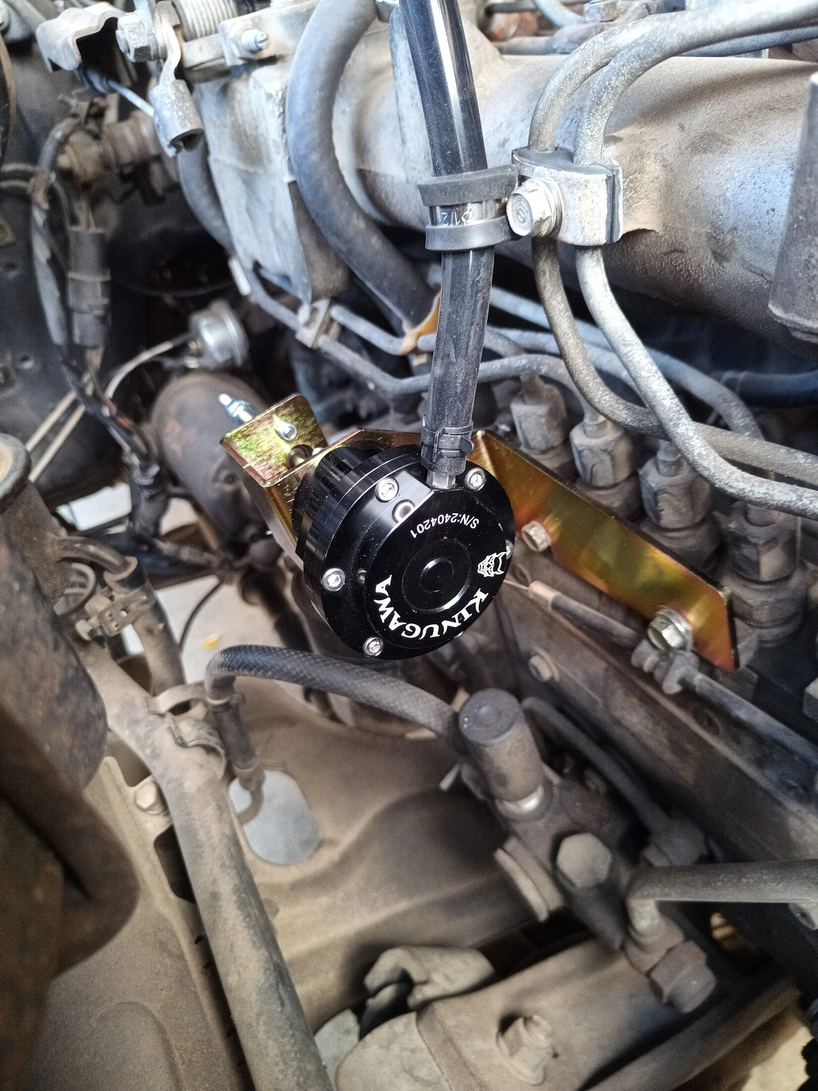

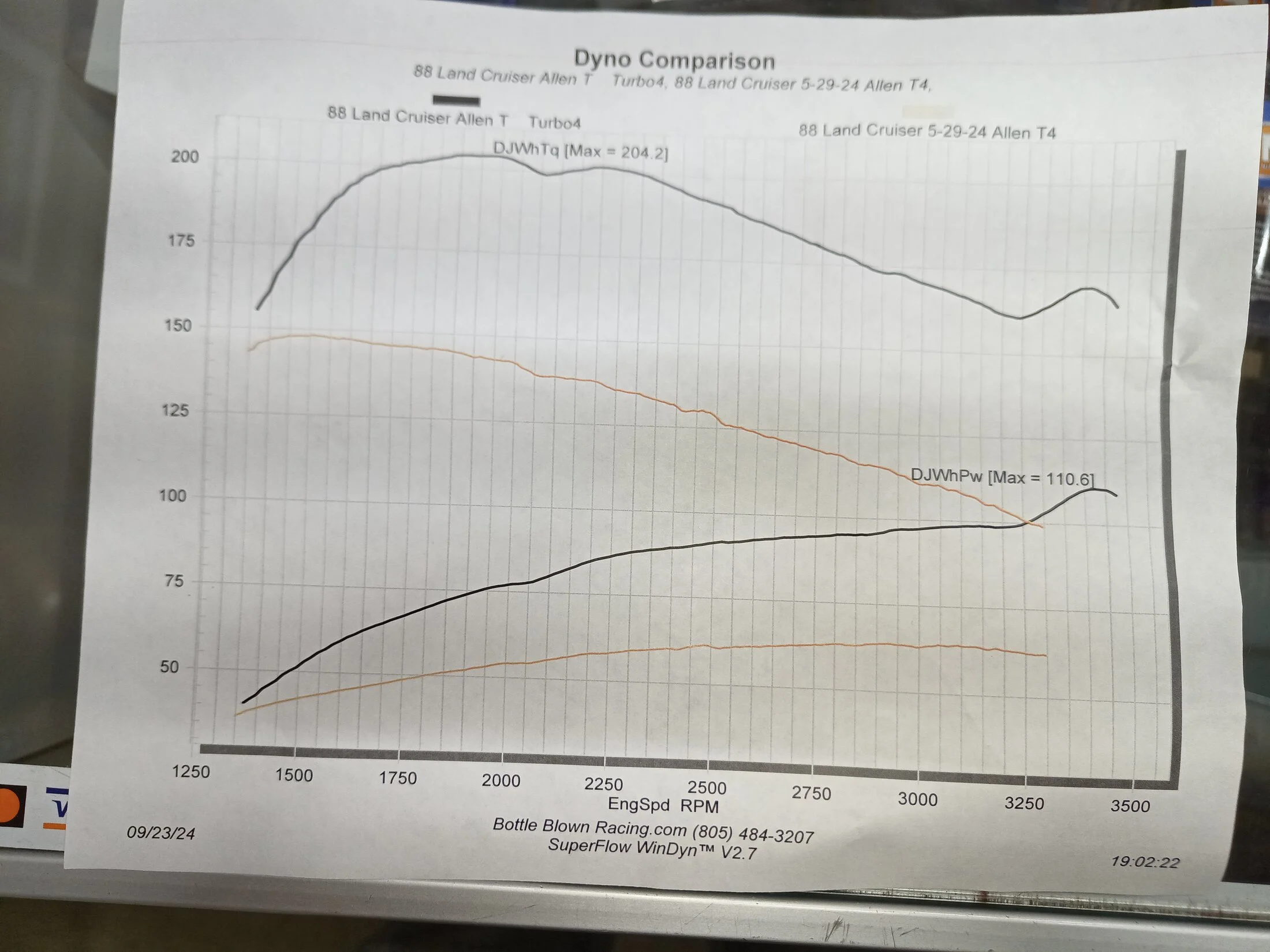

Made my own. It allowed me to crank up the fuel at high rpm while not smoking at low rpm. Highly recommended!

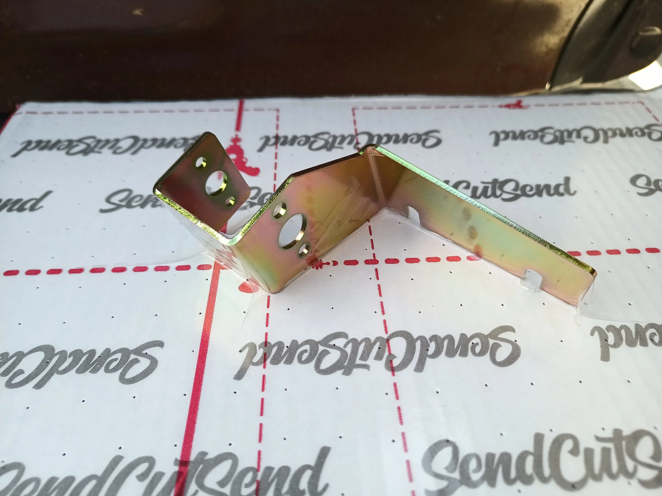

If I were to do it again I would up the bracket a gauge or two and use a larger actuator for more fine tuning.
Superb.. I love your work.
I wish we had SendCutSend in Australia :(
Yes! I also have power numbers, though I don't have numbers without the boost compensator. However, if I hold my stop cable in the neutral position, preventing the fuel lever from moving, the loss of power is quite evident. Also, when I let go, I can watch the compensator pull the stop cable in as boost increases.
Max boost @10 psi:
