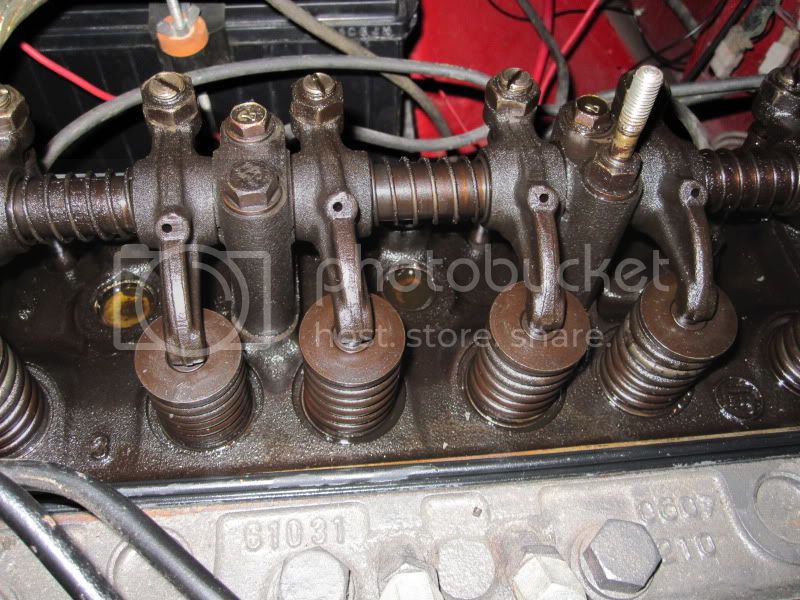

My 2F started making a "chirping" noise as best I can describe it. I used a stethoscope to narrow it down to I believe the valvetrain. I pulled the valve cover off and ran the engine and it is loudest around cyl 4 and 5. I have seen the oiling diagram for the 2F, but an unclear exactly where the oil comes out to oil the valvetrain? With the valve cover off wouldn't I see oil coming out somewhere to lubricate the valve train because I don't see any oil being slung anywhere? In the picture below there is oil in the recesses in the head, as seen in the middle of the pic between the two valves, but the rest of the valve train is pretty dang dry.
The engine sat for a few years in my parents garage before I put it in my '73. Could the oil riser going up to the rockers have gotten gummed up, or something clogging it? What's my next best move from here, remove the rocker assembly?

A gummed up oil passage would be my guess too. The oil passage to the rockers is in the 4-5 pillow block as I remember. While you are there you might want to check out how worn your rocker bearings are. You can grab ahold of the rocker and feel for slop with the rocker shaft. checking for wear on the shaft is also as easy as running you finger over the surface of tthe rocker.
My rockers will push oil out those little holes in about 15 seconds of running (cold) and immediately if warm. Probably a plugged passage, you need to pull the rockers. As rsbcruiser said the rockers will need some inspection. The max clearance rocker to shaft is .003 so the shaft has to look pretty good to be in spec. If this has been going on a long time that rack could be toast.

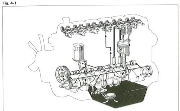

Erik what is a FSM? Forum message? I'm looking for an oiling diagram.
Thanks to everyone.
Mark
FSM=Factory Service Manual
I have yet to see a good oil pathway drawing for a 2F. The F, Yes. The 2F, NO. Hope to see one.

Based on oiling diagram (thats out of haynes, much easier to see in the book) it looks like the oil goes through the main bearing and then to cam bearing to head. So even IF the rod bearings are on wrong (seriously doubt it) then that still would not keep oil from going up to the head? Right?
Rod bearings do not affect rocker arm oil flow.
