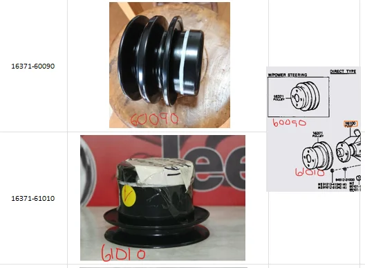

The one that was recommended to me by Cruiser Outfitters is a double groove. I just need to make sure it is the exact one due to a distance restriction between the fan and radiator. They recommended a water pump, fan & pulley combination based on measurements I sent them.
For reference…

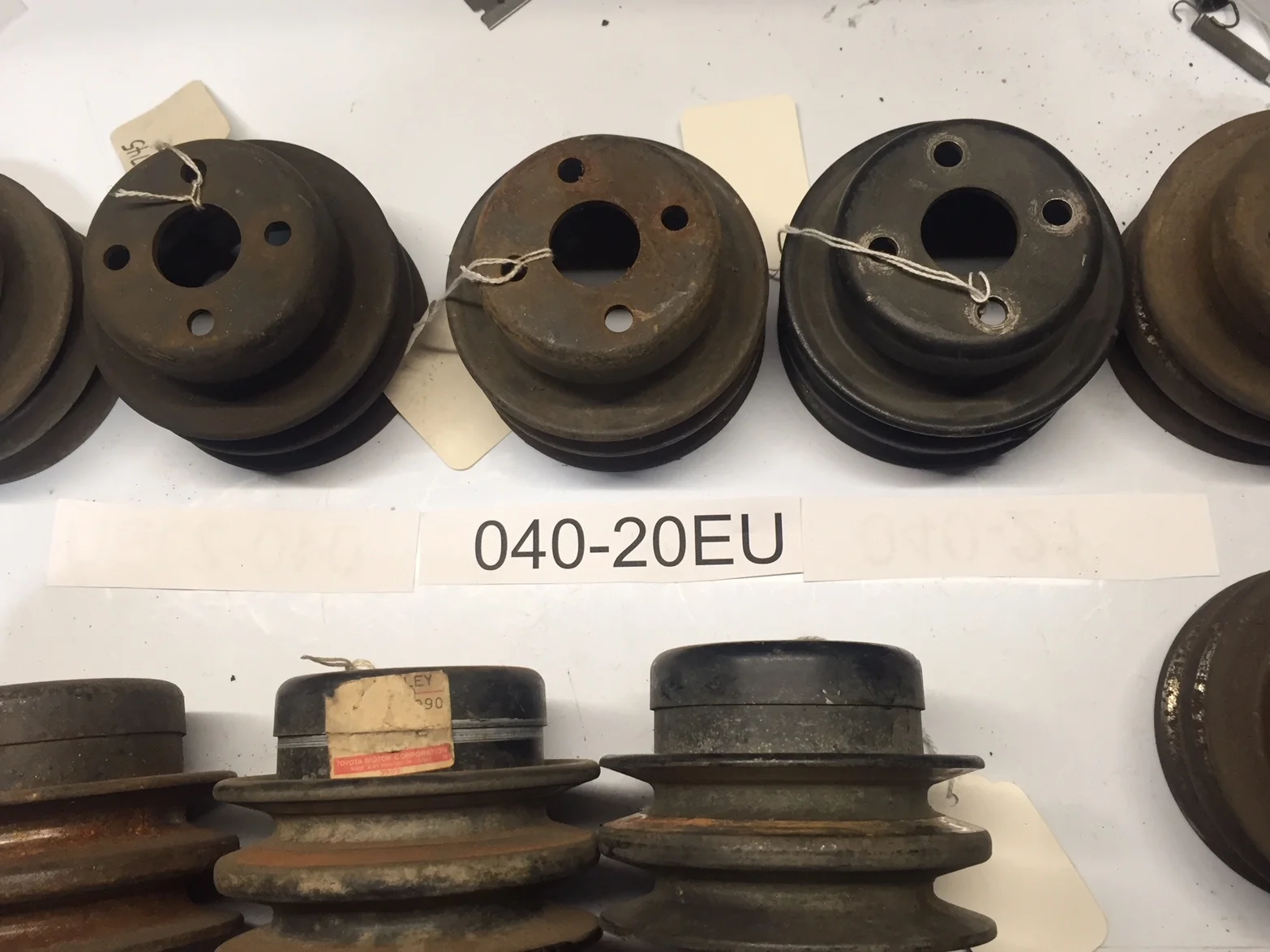

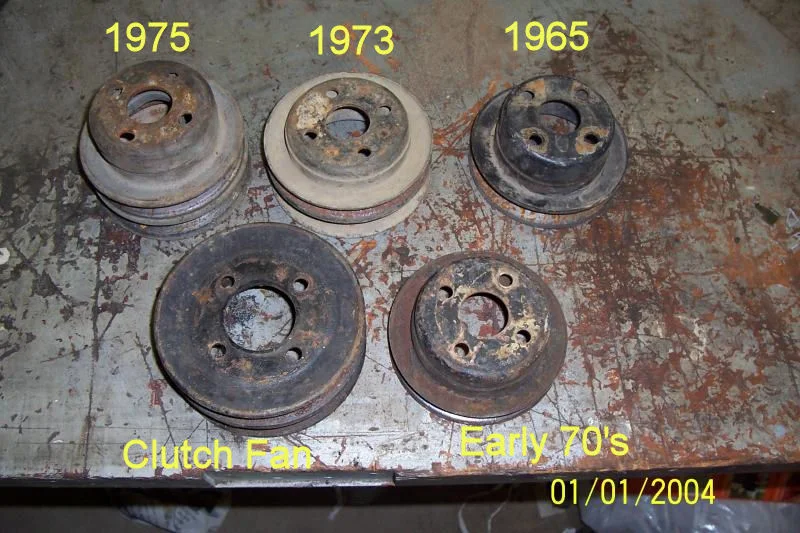

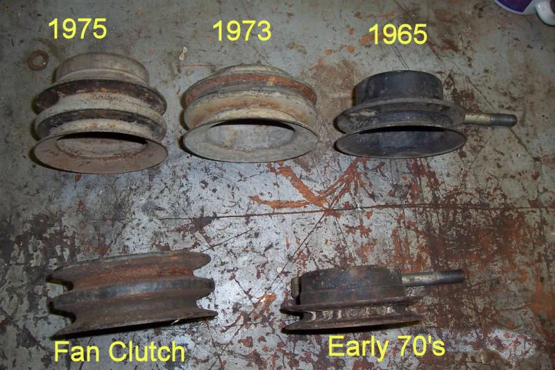

As I recall from your pics you're only running one belt so you could get by with either option.
I I will need to find the right WP pulley to suit my crank at some point, no good pic but my engine is a 75 with mostly 74 accessories hung on it. Only the rear groove on the WP pulley is usable, the front groove is to close to the block to line up with the front on the crank.
Everytime I read up on this the pulleys to match seem to be a bit of mystery. I have a short WP with a no clutch plastic fan.

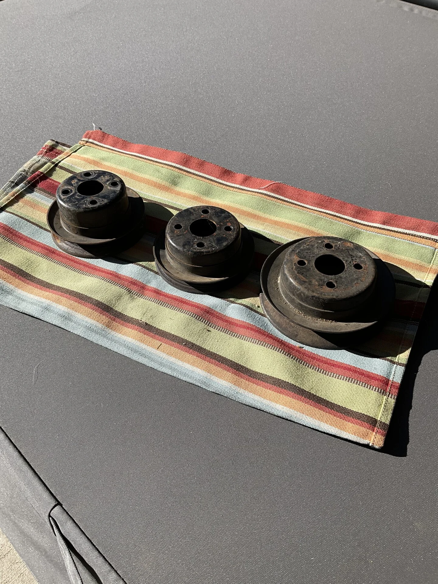

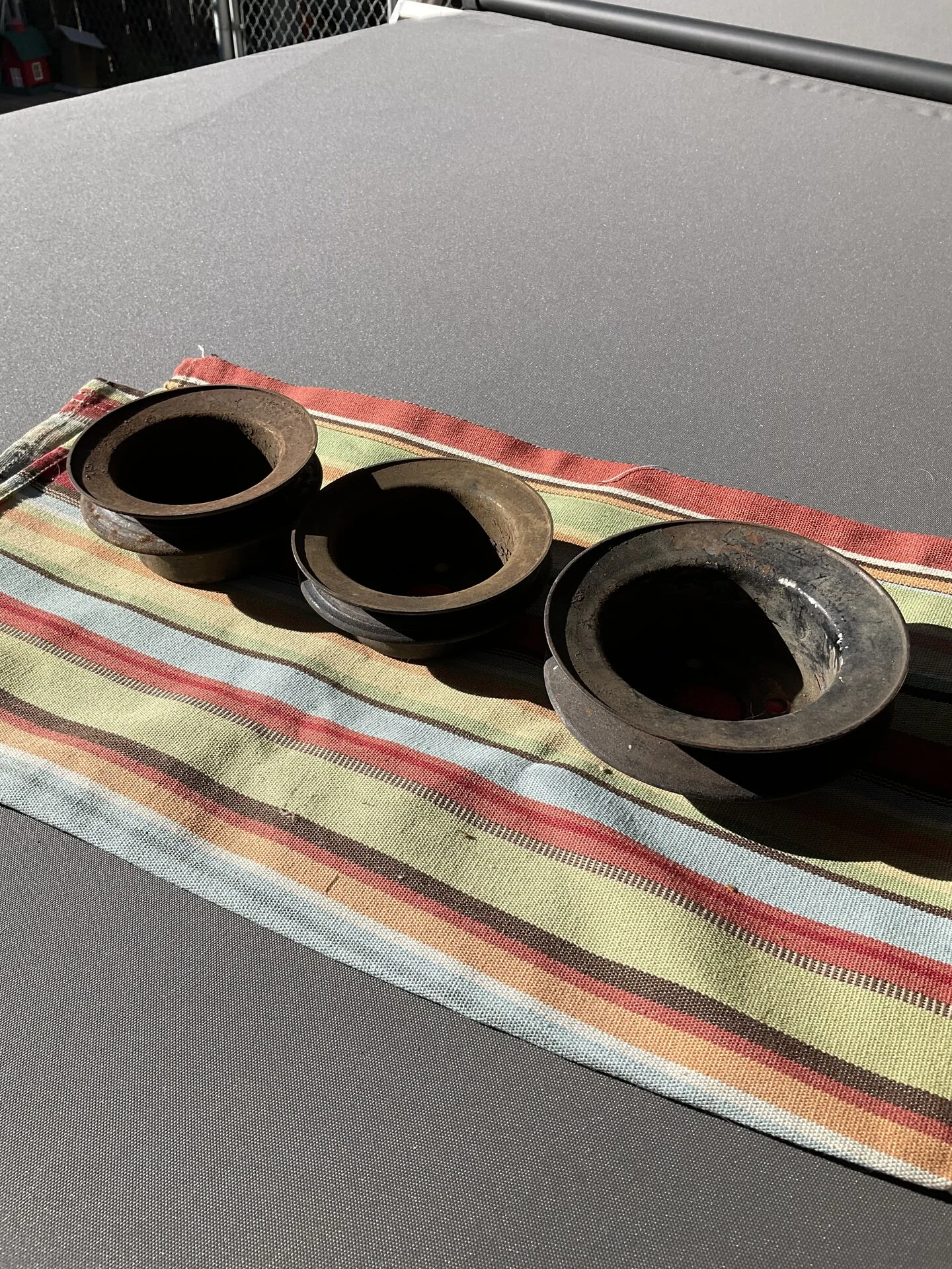

The double-wide groove pulley is used in conjunction with the long neck, direct drive water pump. The forward pulley is necessary to run the alternator in the 2F, passenger side configuration.
I have a few.
You can leave a voicemail at the shop to follow up. 😊
