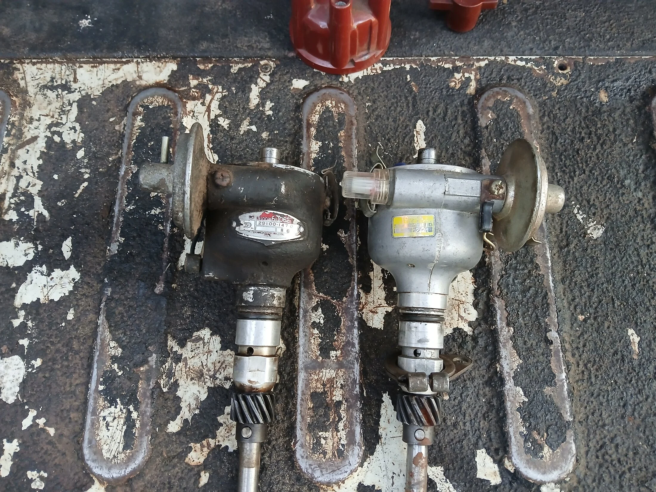

If the diaphragm won't hold a vacuum just block off it's vacuum source, run it on mechanical advance. Also, are you sure it's a vacuum advance dizzy? A '71 might be a vacuum retard. Here's two dizzys, one is vacuum advance one is retard, which one does yours look like?

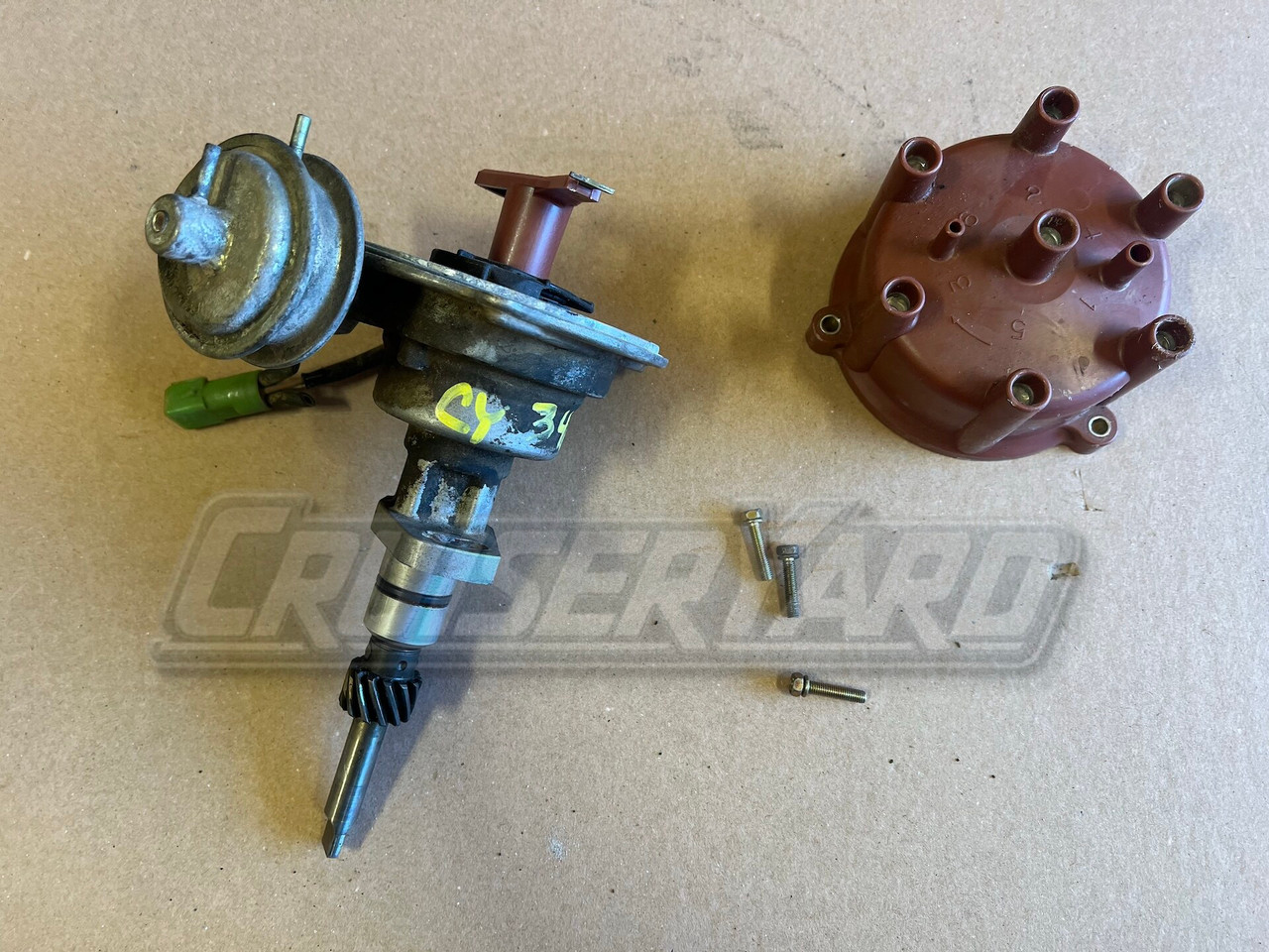

The 2F was pulled from a 1984 Fj60 that had all the smog equipment short of the carb. It has the Toyota Igniter/Coil and Distributor with 2 diaphragm advance from the 60 series as well. Just like in this photo from the web.
The 2F was pulled from a 1984 Fj60 that had all the smog equipment short of the carb. It has the Toyota Igniter/Coil and Distributor with 2 diaphragm advance from the 60 series as well. Just like in this photo from the web.View attachment 3765415
I see. Well, if one of those diaphragms will hold vacuum, use it. I was able to get a new single diaphragm advance unit for my Big Cap dizzy from @4Cruisers that was an easy install
