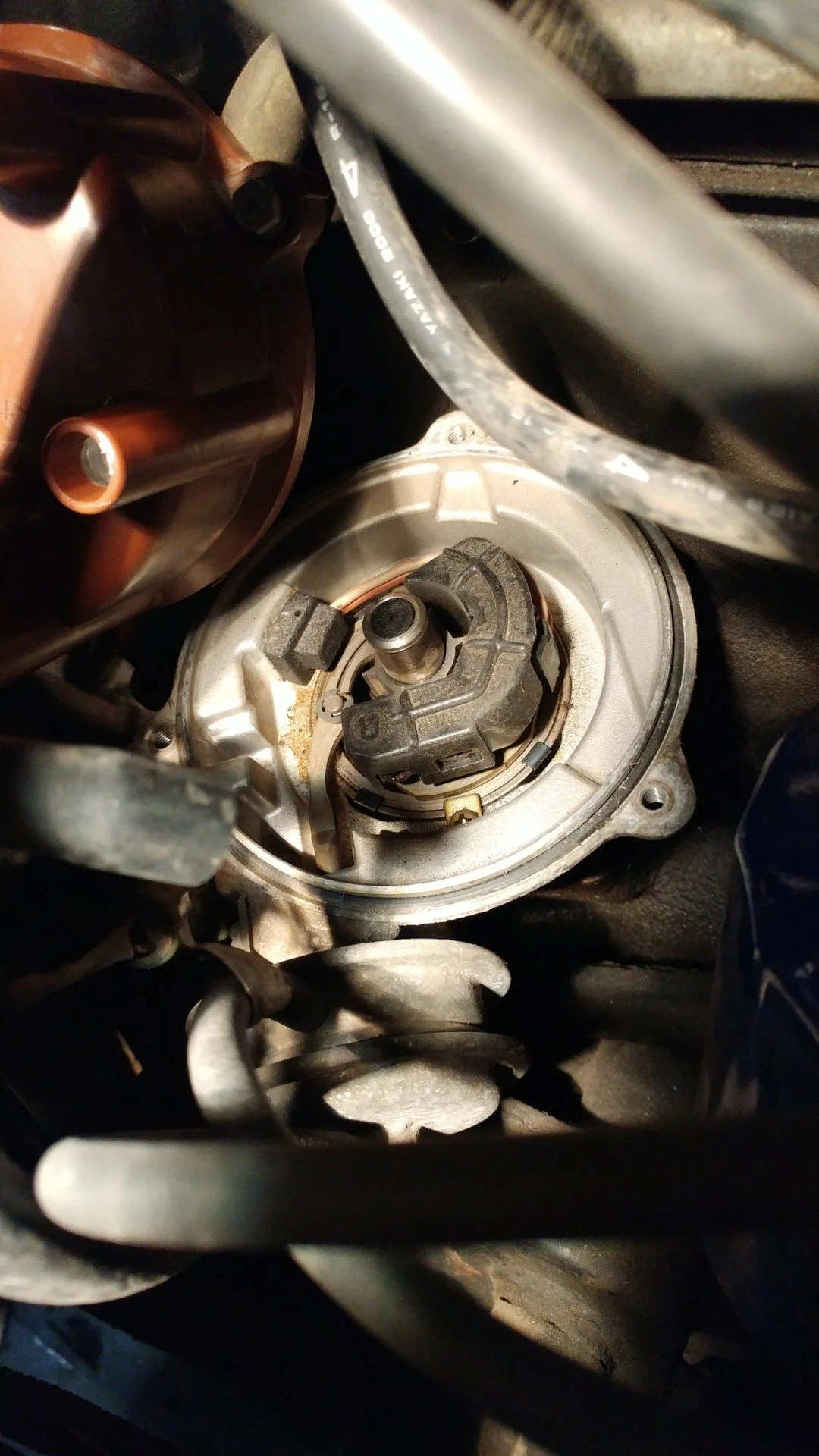

okay how do i get this plastic thing off to gap the hall effect sensor on the distributor so i can gap it?

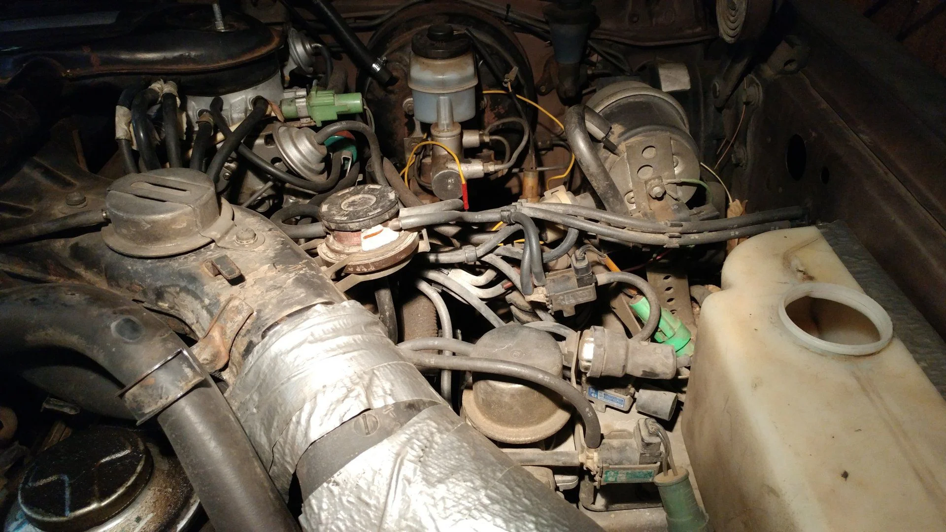

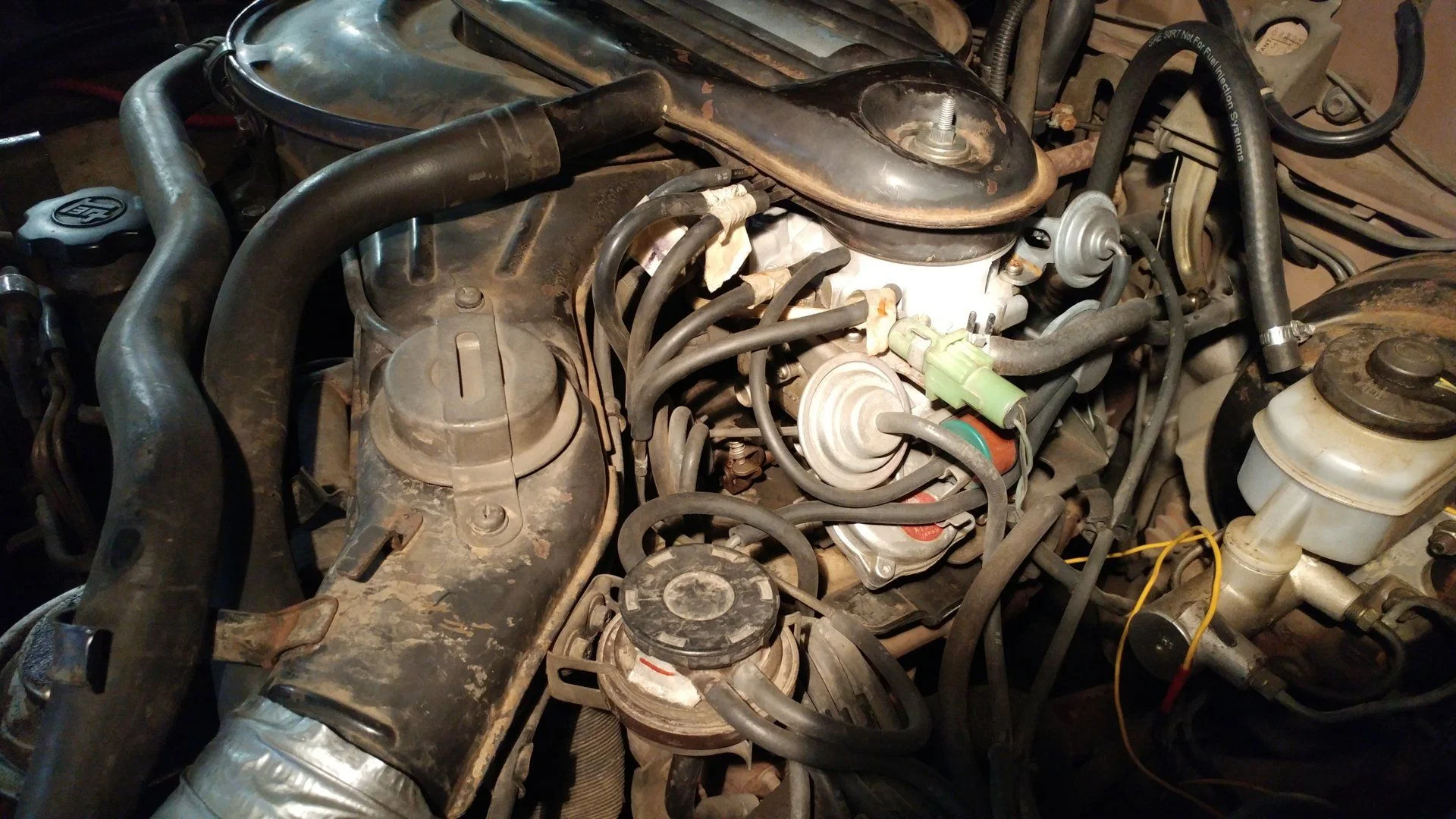

Can you post pics of the engine bay, particularly the carburetor side, with all the vacuum spaghetti?
last one there shows a bypass i'm running on one of the BVSV systems
should have little to no effect on the current problem
The plastic cover on the distributor comes off pretty easily, if you look close at the bottom-(in your picture) there is a screw that hangs up the plastic piece, use a flat blade screwdriver from the right side and gently pry it laterally and then lift up. I have found that a paper match thickness is pretty close to the spec for that air gap.
You should look inside the dizzy cap for corrosion on the metal tabs, as well as on the rotor, clean up the metal contact points with fine sandpaper or emery board.
Also check the resistance factor of the sparkplug wires, I believe 25 k ohms or less resistance is spec.
Do you have the Factory Service Manual (FSM)? nevergiveupyota has them in her sig line.
You have some non-standard equipment there, what I notice is the clutch master cylinder, and the brake master, I do not know if that is making this stumble issue.
uh
i think my clutch and brake are standard
i know the cruise control thing next to the clutch is not though
brake booster has been replaced so it may not be standard
i have the manual for the engine but it didn't actually say how to get that cap off (it's actually not in the exploded view at all) so i was just wondering what was up with that
Looks like a small screw holds that dust cover in place. See #4 in image
The screw really is not holding it in place. I literally put one on a spare I have today and did as the guy earlier explained, to get it back off, gently pry up and it will slide up and off. If it wasn’t nearly midnight and cold out I’d go get it and take a photo but I have to figure the OP has it off by now. If not tag me tmrw and I’ll add a photo.
