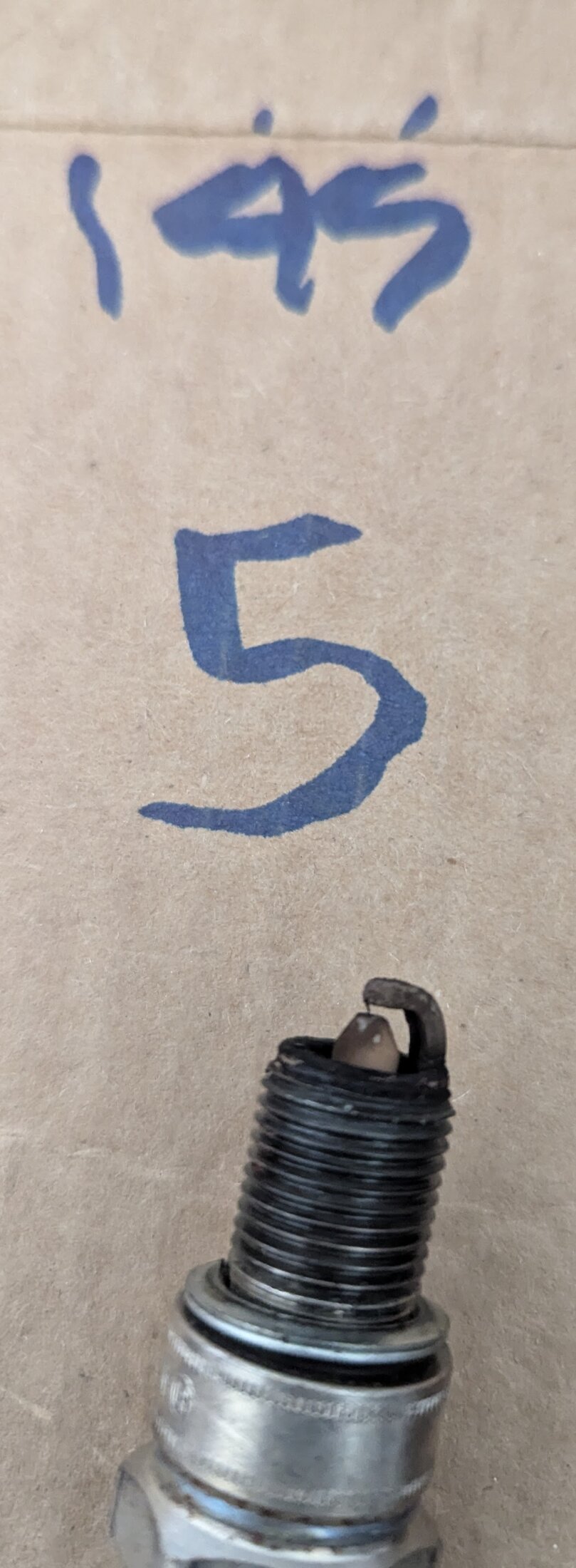

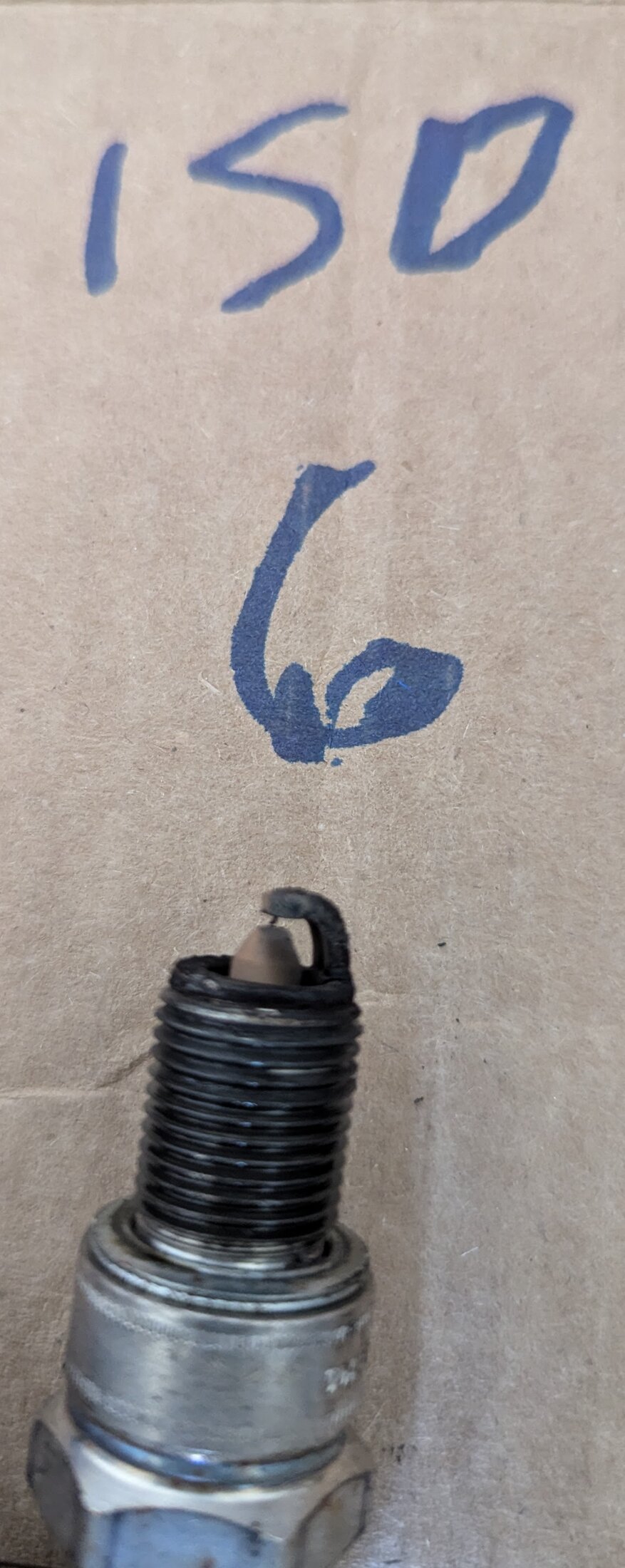

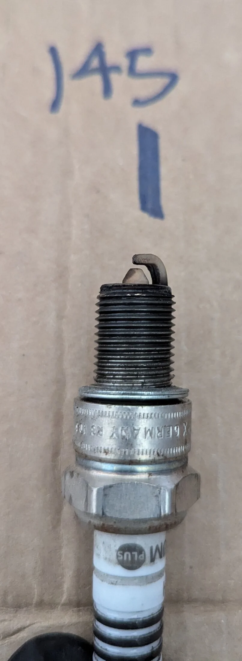

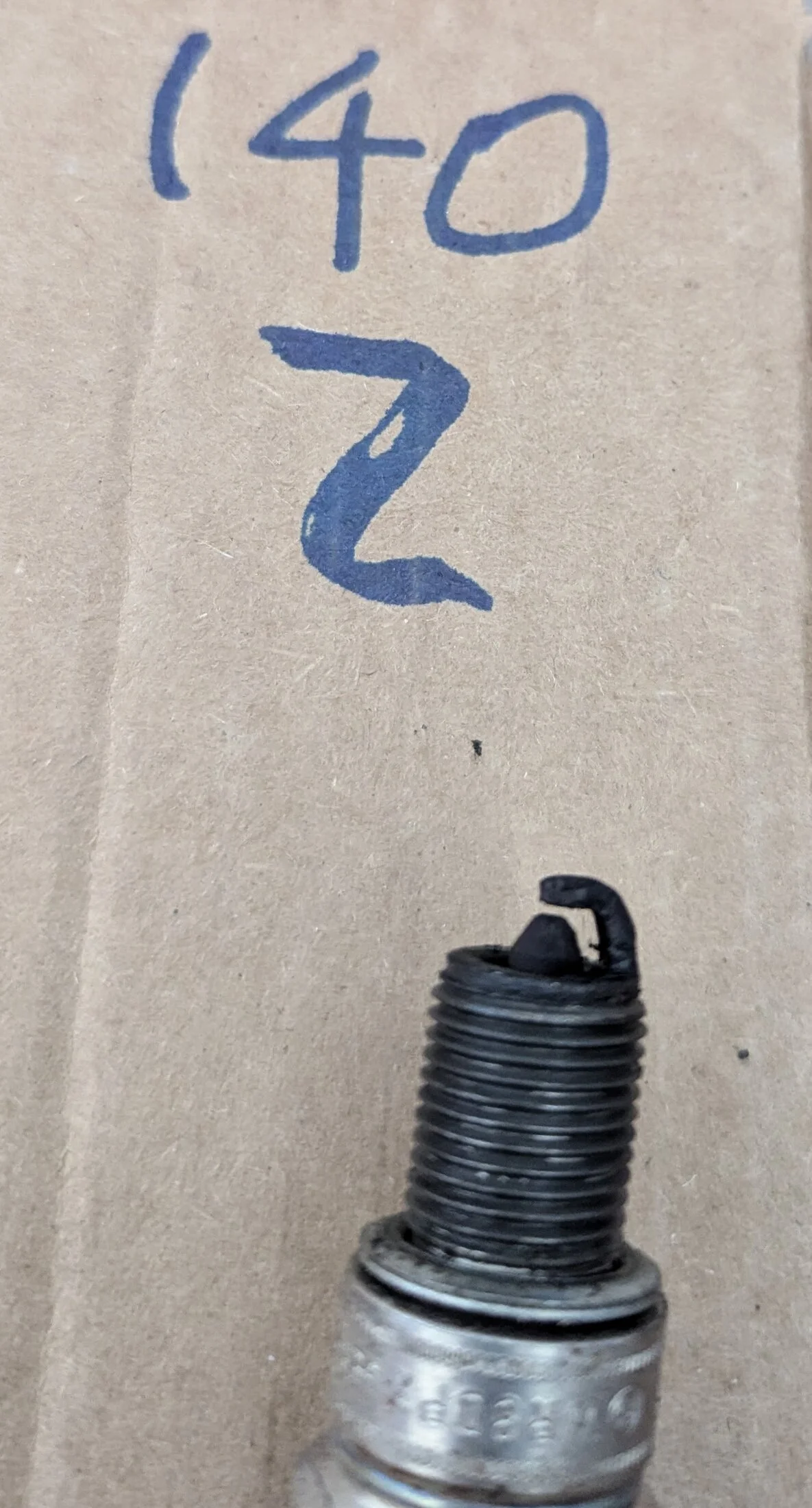

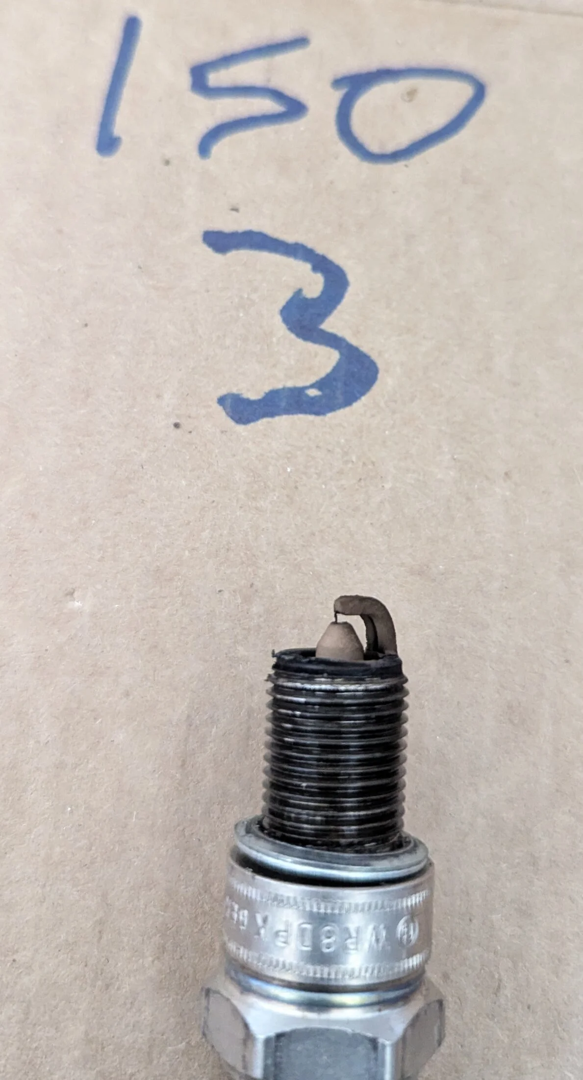

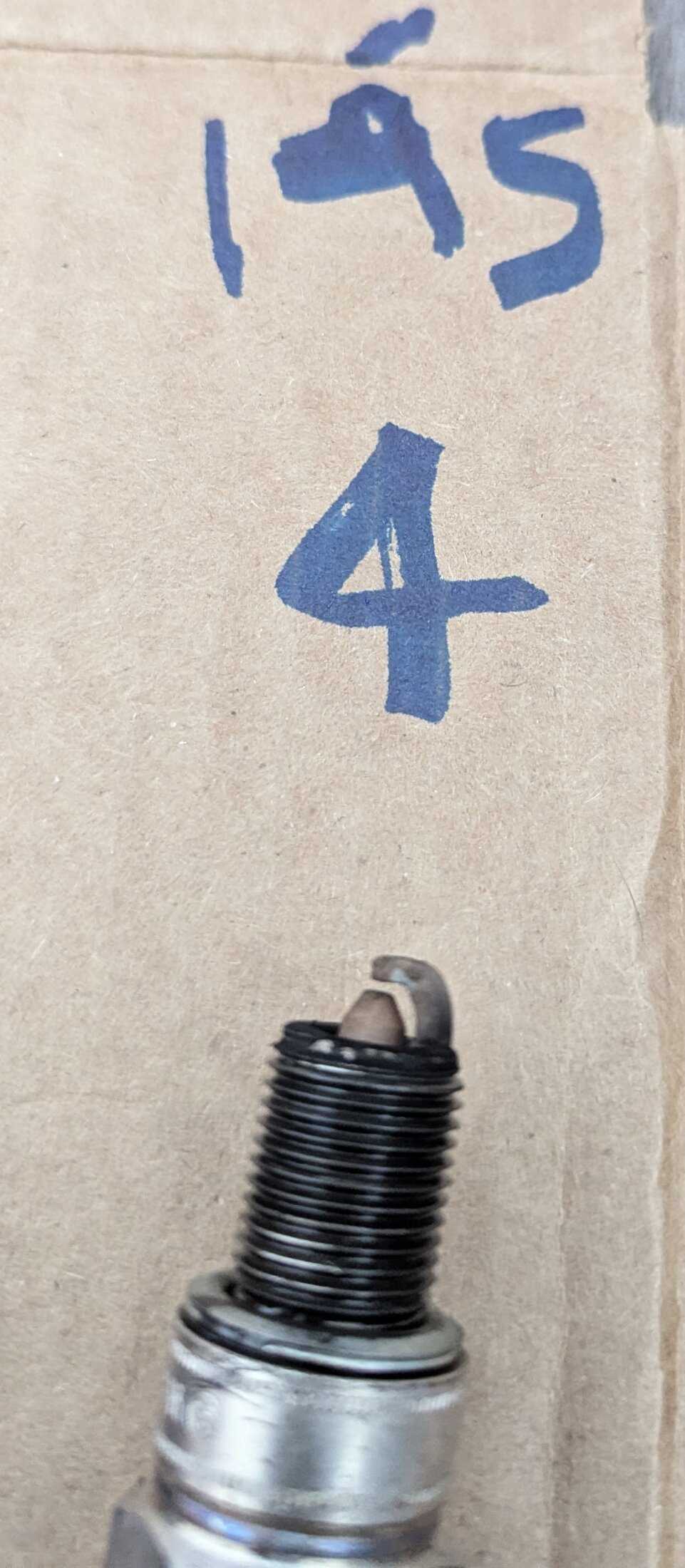

Pictures of spark plugs:

My 2F has developed what at first seemed like a ticking noise, and now seems more like a slight knocking noise. I'm not sure how to proceed with diagnosing it.
A couple of weeks ago, I thought I would adjust the valves to see if it went away. I adjusted the valves with the engine running, and it didn't improve the noise.
I also thought the noise might be an exhaust leak between the header and the head. I tried tightening all of the bolts, but found no loose ones. I'm ready to get rid of the header, as I've dealt with exhaust leaks there in the past.
Yesterday I did a compression test after warming up the engine. The numbers looked decent, 145-140-150-145-145-150.
At this point I think there's a slight chance it could be an exhaust leak, but the sound doesn't seem right for that. I'm afraid it's a bearing in the lower end.
I'd appreciate any advice on next steps.
I attempted to add a video of the noise here, you can perhaps here it most pronounced when the engine is revved a bit towards the end of the clip.
View attachment 3753850View attachment 3753851View attachment 3753852View attachment 3753853View attachment 3753854View attachment 3753855
