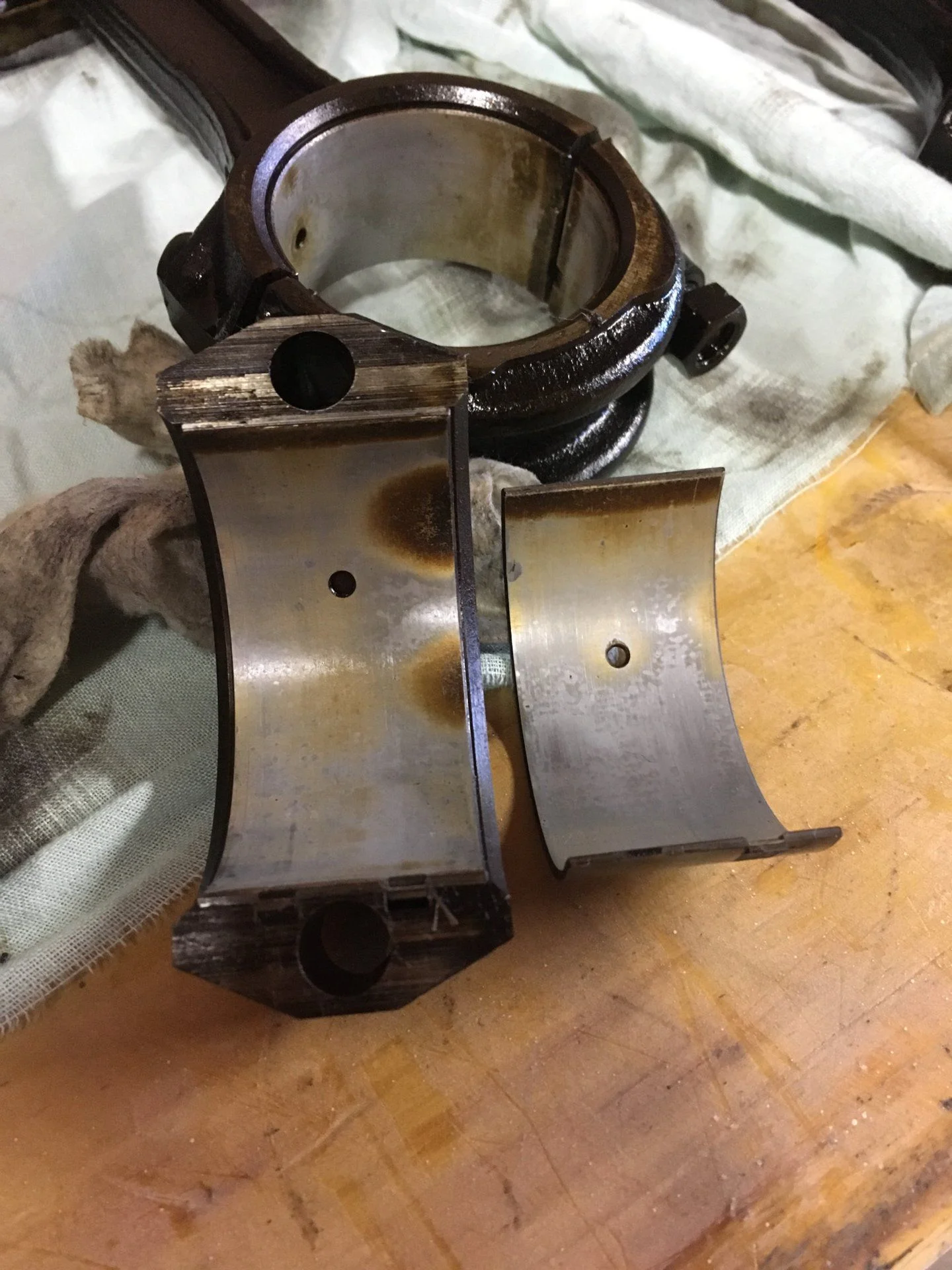

The crankshaft looks good. Should I put new bearings on the rods?
My oil pressure has always been stable and close to the mark.

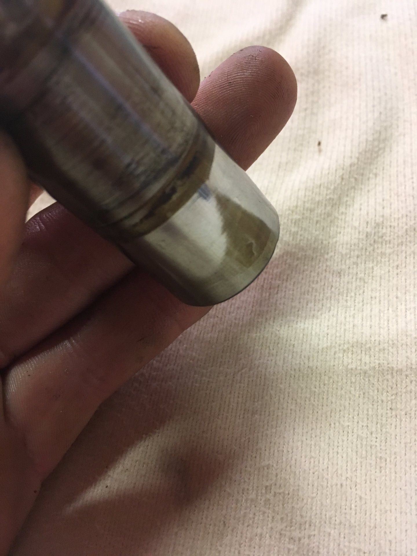

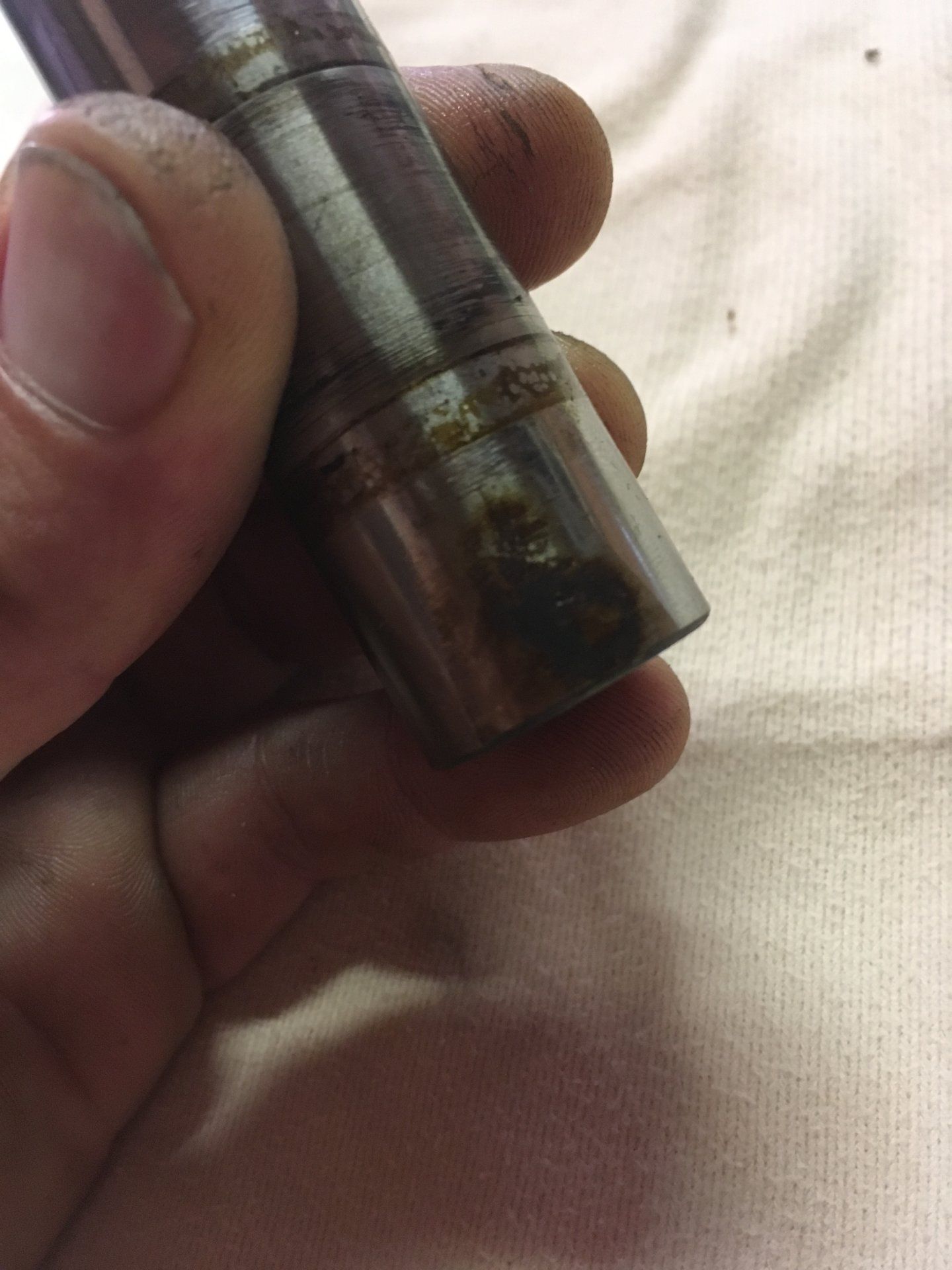

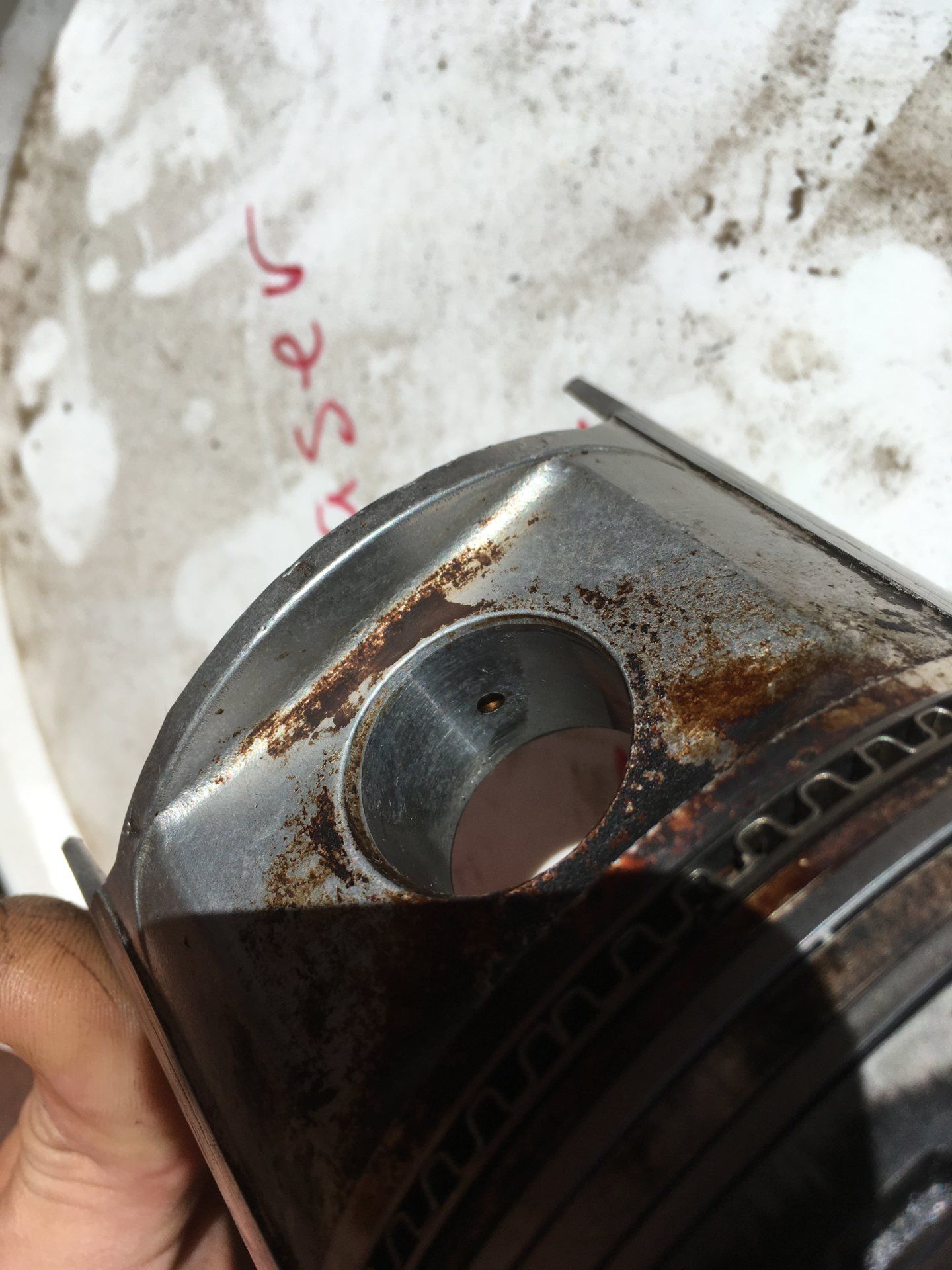

Yes they all look like that. That one I’d actually moved around with my fingers for a while, the rest are quite firm in their grooves. I could slide number 2 back into the cylinder with ease without the compression rings on.

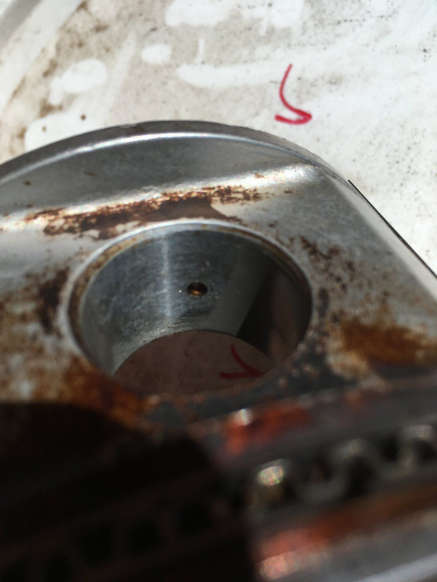

That pic is of number 6 with the scuffing on the skirt. I’m a bit curious why number 6 is like that and none of the others. Blocked oil passage to the gudgeon pin? It was stiff to move in the piston but seems quite free now. I haven’t removed that pin yet.

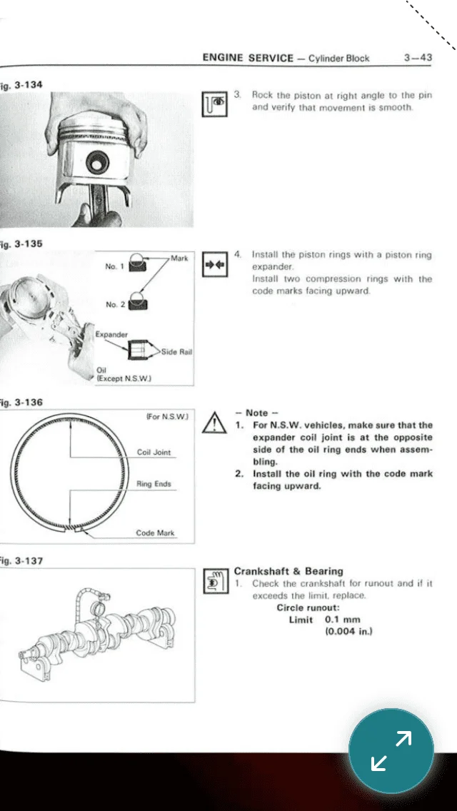

Found something interesting on the oil rings in the FSM. From what I’m reading the oil rings may have been installed incorrectly. None of mine are anywhere near close to lining up. The two rings outside of the expander coil are offset between 90 to 180 degrees.

In the end I was quite lucky and got away with putting a new set of std sized pistons and rings back in with a new set of rod bearings. Removing the lifters took some time and the rocker gear had a tarnish that I couldn’t remove without disassembling it all.

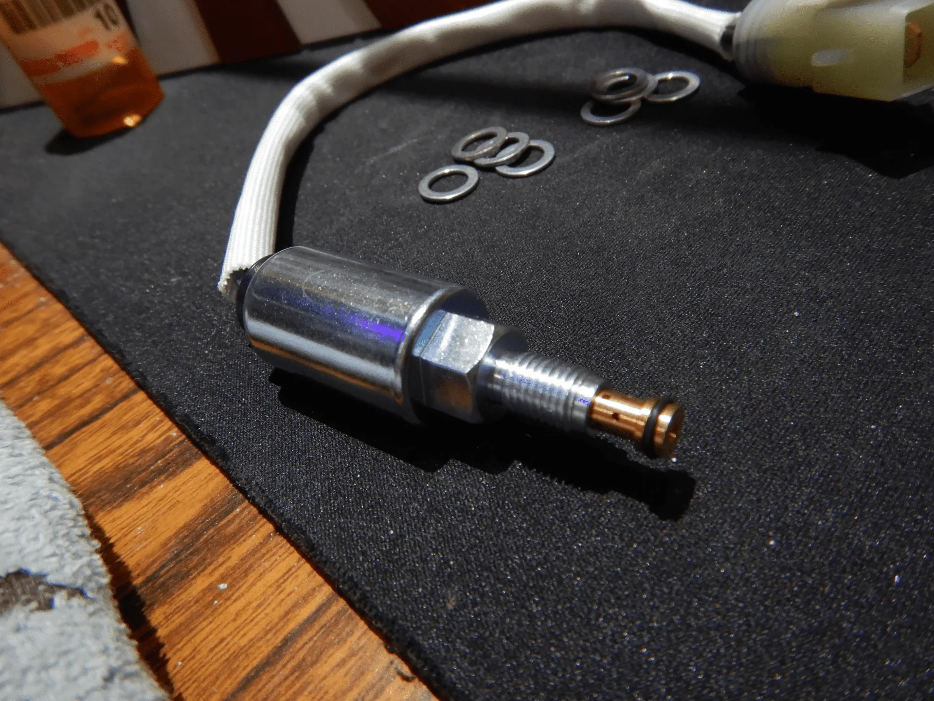

Do Your AU carbs have a Fuel Cut Solenoid on them ?
up on the Air Horn , with either a single or two wires going to it ?
if so i would remove it and see if it has a little black O-ring still on tip or if it clicks when u apply bench test power to it per the FSM engine
some of your symptoms have similarities in some cases to a bad one or one where the o-ring has failed and either clogged it or is letting fuel by when it's Not supposed to ..............

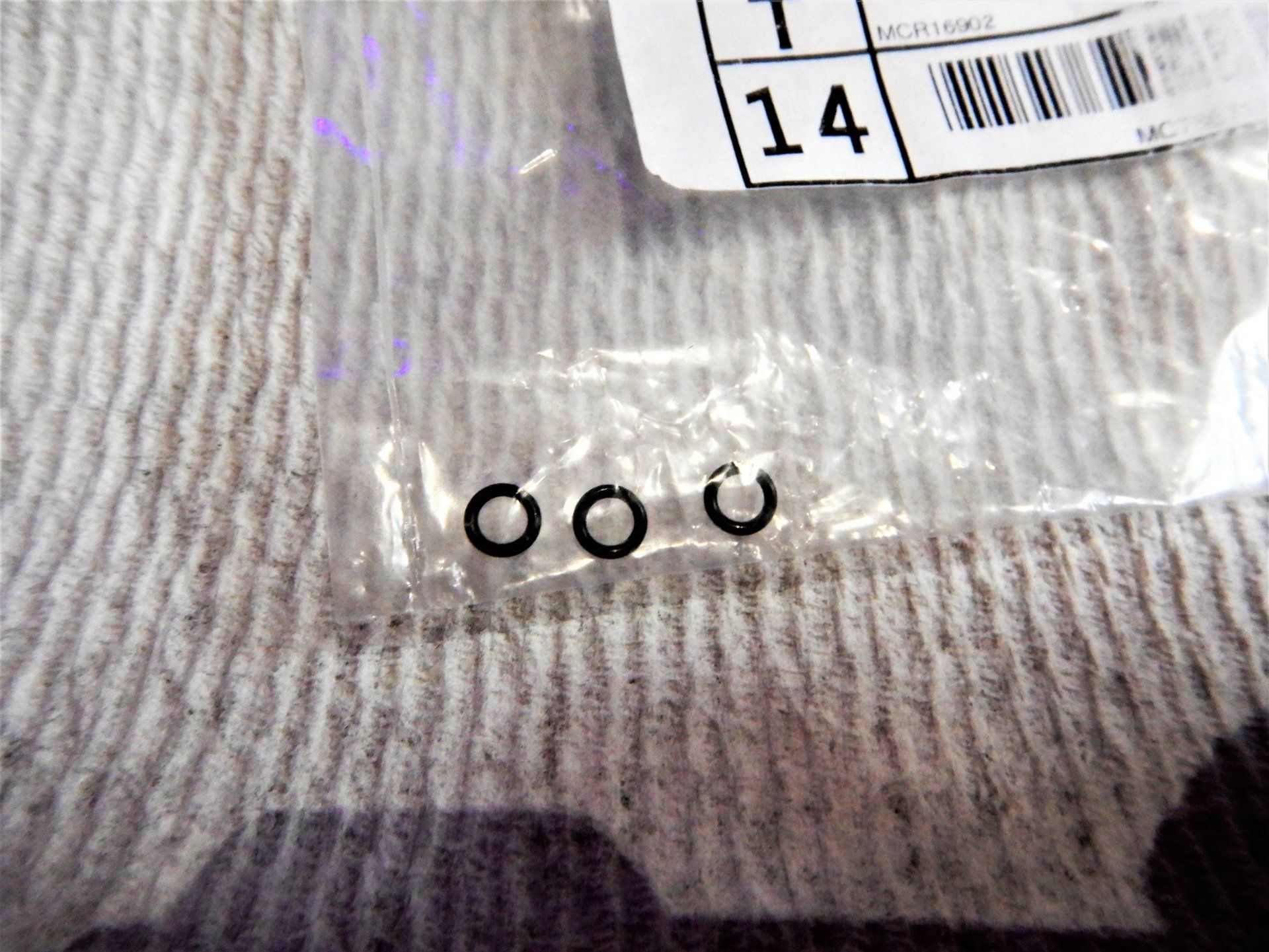

see , in a older 2F / 3F carb when u Remove the Solenoid for any reason , it usually Tears and shreds small microscopic black o-ring
when and id u inslall a new one apply a dab of Silocoln or house hold kiyched Olive Oil to this O-ribe , so it glides right in and will not get hung up and terat too , ona install .......
sounds odd , but i have encountered this issue many times , i keep a 10 pack of tem and the crush washer seals on hand in the Shop supplies at all times ...............
that tine bastard is mission Critical Mate ........
see my example photos below of my 2 wire Solenoids i offer and see the tip of it ..............
yea its that tiny !
hope u get it all straight ............ :)

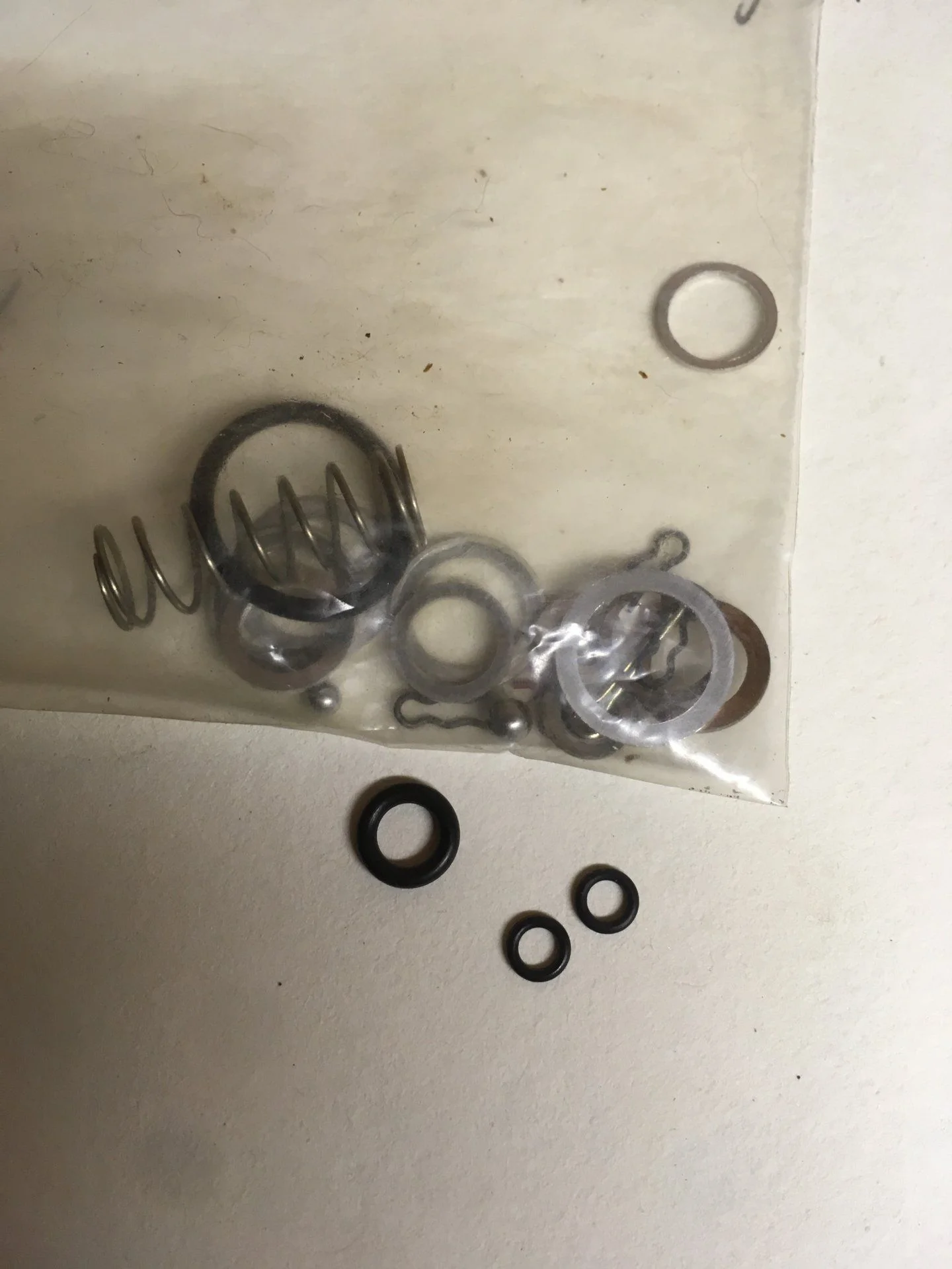

Just having a look in my carb rebuild kit at left over parts and I have 3 small o-rings. I’ll have a look at the solenoid after the weekend I think in case I don’t have the right o-ring and like you say I could make it worse worse when I remove it if it’s still on there. I’m watching my spark plugs closely checking them every 50 kms. Here’s a pic of them at 200 kms.

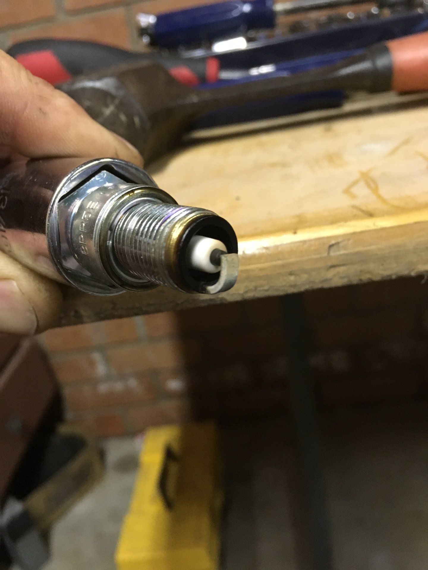

what brand plugs u using ?
factory TOYOTA NipponDenso Resister ones the micro fiche calls for

I have never seen any carb kit oem toyota or japan aftermarket like KEYSTER come with the solenoid o ring before ?
- most dont come with the solenoid crush ring gasket either , only a oem toyota one does i have seen
here is both parts u need to seal up your solenoid tight
most folks do not put the crush washer that will cause a small vacuum leak of fuel to leak out in some extreme cases
this o-ring is very tiny maybe only 2-3mm in dia ........
Plugs are ngk BPR5E. Wasn’t much of a selection at the parts store. He looked in the book quickly and gave me them
