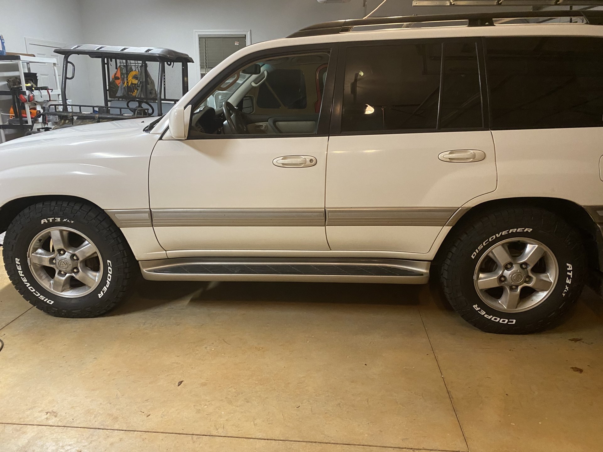

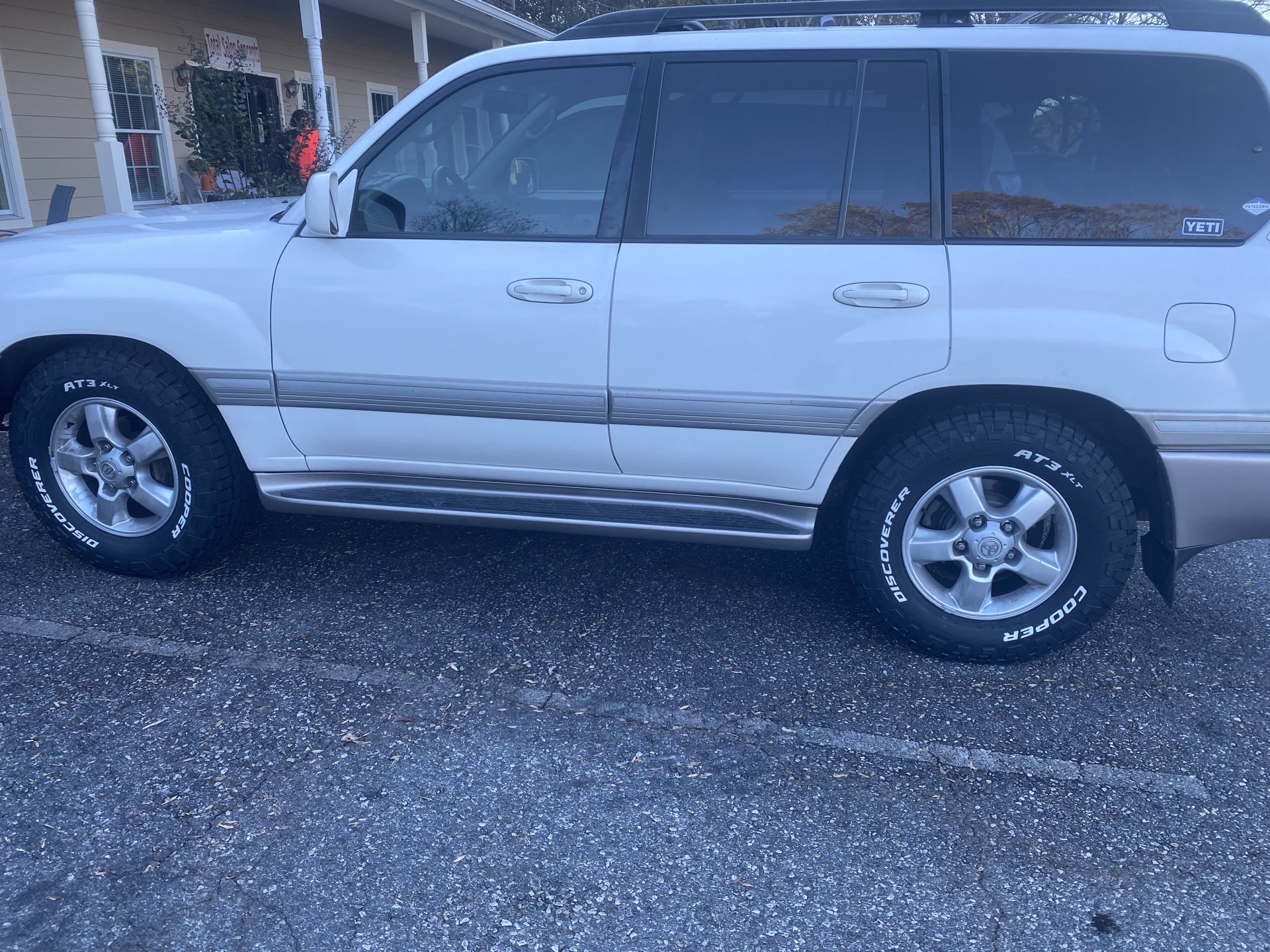

I just put a set of coopers at3 xlt on my 05 in 275/70/18 and really like them.. They feel out the wheelwell perfect and look better than stock imho
