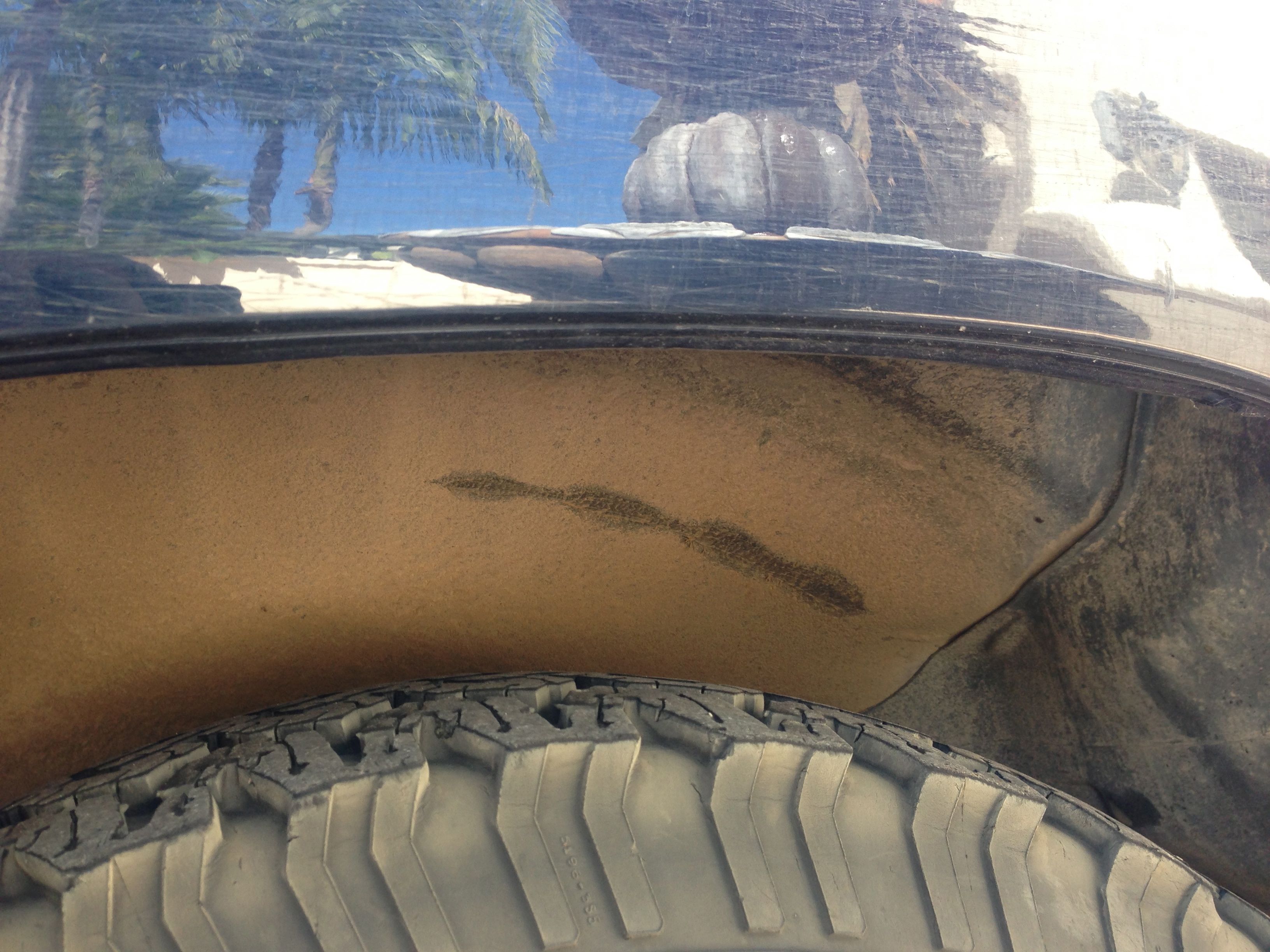

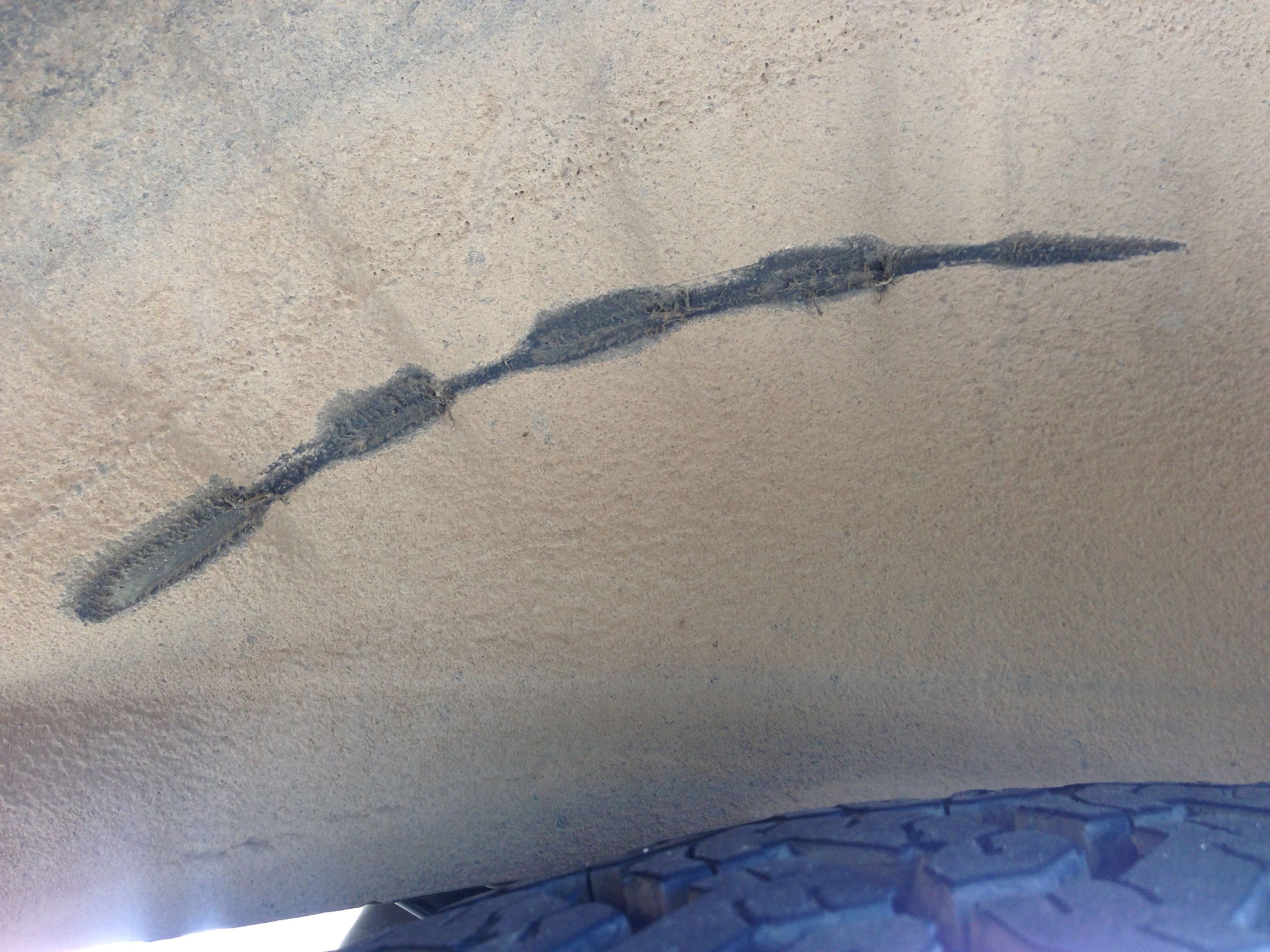

Not an "issue" per se, but I do get a bit of wheel well rubbing under more extreme flex with 275/70-18 BFGs...with a similar set up...Slee heavy, Nitrochargers, a bunch of weight.
This pic from the passenger (right) side rear.
This one from the left rear.
