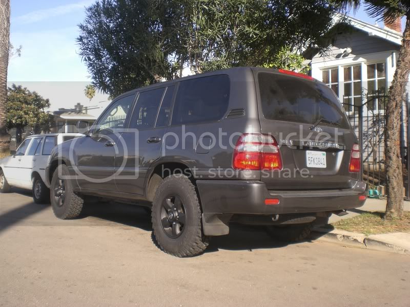

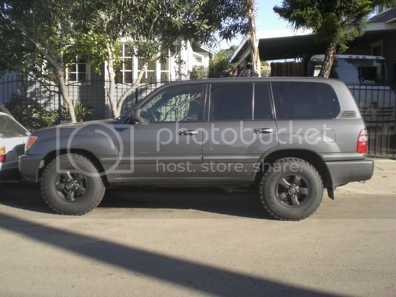

    Since there is not much of a selection of tires for 18" wheels, I decided to buy 1999 16x8s and mount some 255/85R16s...
    Despite many people's comments regarding the width, I much prefer this size than a 285... steering feels so much lighter than the stock tires and they fit the wheel well perfectly. No, the handling is not worse.
    I'll be taking a trip next weekend and report on how well they performed off road.
    stock 2004
    [​IMG]
    [​IMG]

    Great looking truck! Those rims look sweet painted.

    did you paint the wheels yourself or get them powdercoated?

    The wheels were rattle canned by wife and myself... she loves it! She says it doesn't look like a minivan now...:doh:

    I used Brite Touch Flat black. I had the same on my MR2 Turbo and held up great so I used it on the TLC!
    I Didn't sand them (even though the instructions said so :doh:), but I did clean them with dish washing soap and then rubbed them down with rubbing alcohol to clean them off. They're holding pretty well. But if they don't, I have some more cans waiting for them! :grinpimp:

    is the gap between rim and brake components very small?
    cooling issues?

    They are Load D. And Thanks for the used tire idea!:cheers:
    The gap is small on the rear. No cooling issues. The 16s fit perfectly.
