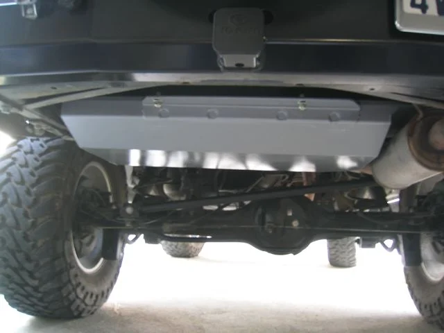

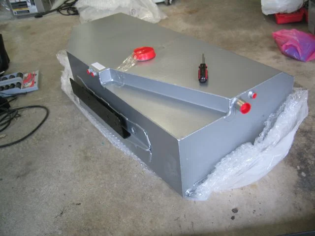

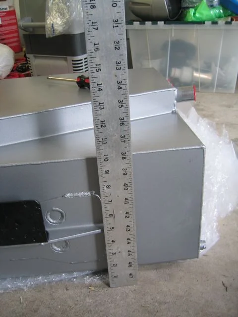

Thought I'd post some pictures of my new 24 gallon Auxiliary fuel tank from Long Range Automotive (not to be confused with Long Ranger). I've always wanted to get an aux tank but the LRA 42 gal was too large and the OEM 13 gallon was too small. I heard about this new size so I jumped on it. I purchased it through MAF. Steve was great help.
I won't have time to complete the install this week but I was anxious to see it mounted. So, I mounted it myself with the help of just a floorjack. I gotta say I'm very happy with the quality and the clearance of the tank. It fits snug and looks well built. Initially I thought about using a rectangle fuel cell to save some money but this LRA kit is well thought out and takes adavantage of all the available space.

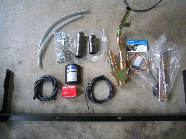

The filler tube is different than the OEM one with single neck and then the diverter valve and knob. There is another OEM type of neck that looks like this one but has the leaded fuel restrictors on it. I think I prefer the aforementioned one.
Anyway, here are the pics. I'll need a couple of weeks before I can post a full review. I plan on upgrading the rear suspension to accomodate the extra weight. With almost 50 gallons of fuel, I should have a range of about 650 miles (given 13mpg).

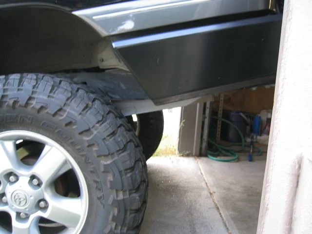

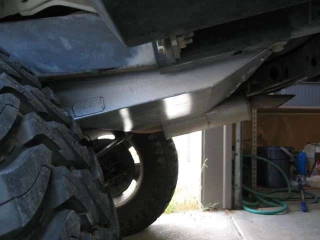

The tank hangs about 2.5" lower than the frame rail. That's it!

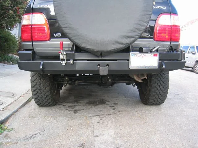

Final pic. You can't even see the tank from the rear! :grinpimp:

I'm tying into the existing fill location. I have to carefully cut into the existing filler tube and install the wye (pictured in the first post).

How strong is the tank as far as impacts go ? It looks quite hefty, so I imagine it would take some abuse :confused:
Sincity100,
I was riding with Amando and his truck when he went thru Rubicon last summer. His secondary tank, a bit lower than Hoser's becuase his is 42 gallons and it comes out unscathed except for loose connection between tank and gas filler.
Oddly, his second gas tank is much stronger than the stock gas tank even with it's protection plate!
