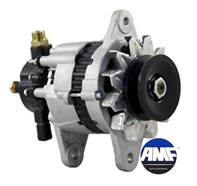

Quick phone search. There's a few options out there for new if you can adapt a bracket. Think I'll go that route if mine s***s the bed.
Not sure who this is...also don't see a price. I don't fbook. :meh:
Price is a bit better on this one.
