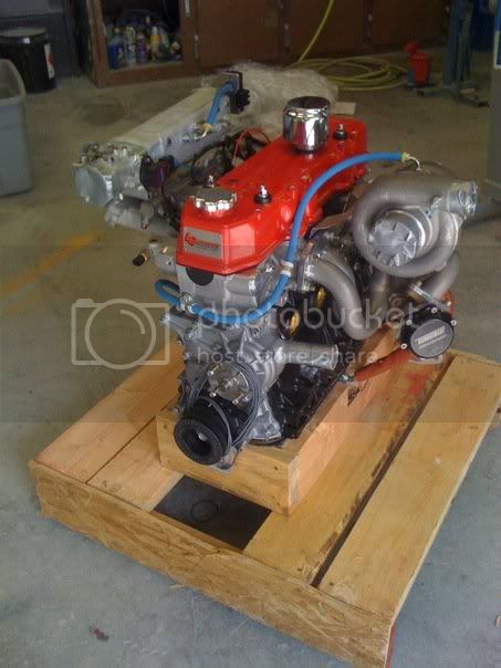

Howdy guys, I am jamming the fuel injection 22re engine in my 85 that came with the 22r. I have everything from the donor truck, we are putting a turbo'd LC with stand alone fi in that truck. The guy gave me the old engine and computer, ect. I have searched for a thread here, but haven't been able to find anything. Any help I could get would be great. I have the long block in the truck and am wondering what wires and such I can remove from the truck and how to get the fi and computer in and working like it came that way. Thanks in advance, here is the 300hp 22rte from LC...
