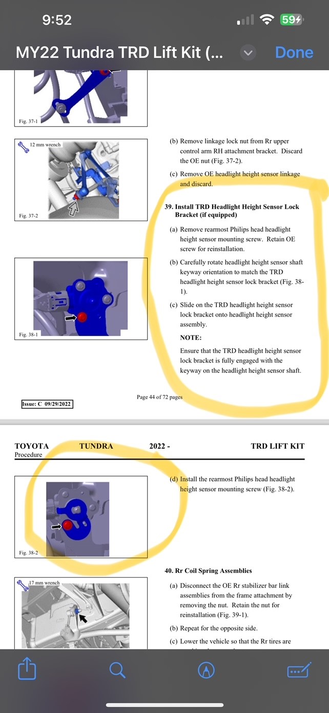

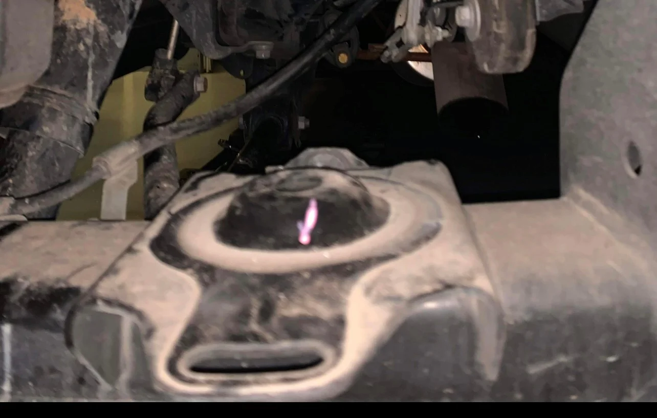

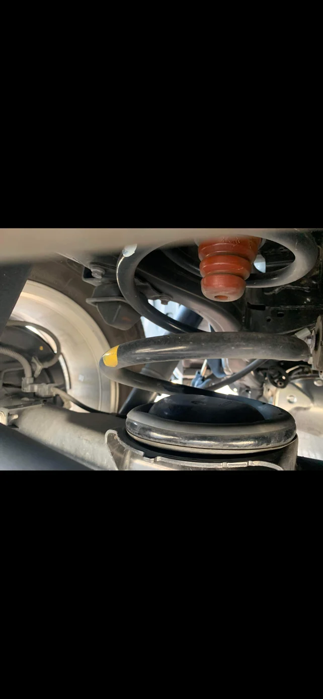

Hello All,
Im looking to do an air bag to coil conversion and bypass the AVS and warmimg lights. I figured out a way to make the leveling arms stationary with a locking braket that Toyota sells for the auto leveling headlight sensor sold with the factory TRD lift kit part nubmer (PT595-34220). You can meke this fit on the auto height sensor (drivers side) as well. So now the system things the arm is stationary and will not move, so no need to energize the compressor to inflate or deflate the air bags. Now you can remove the bags and install coils. I need help to find a way to seat the coils to the lower axle seats since its different and is set up for accepting the air bag. Any help would be great. I attached some pictures for help. Thanks
