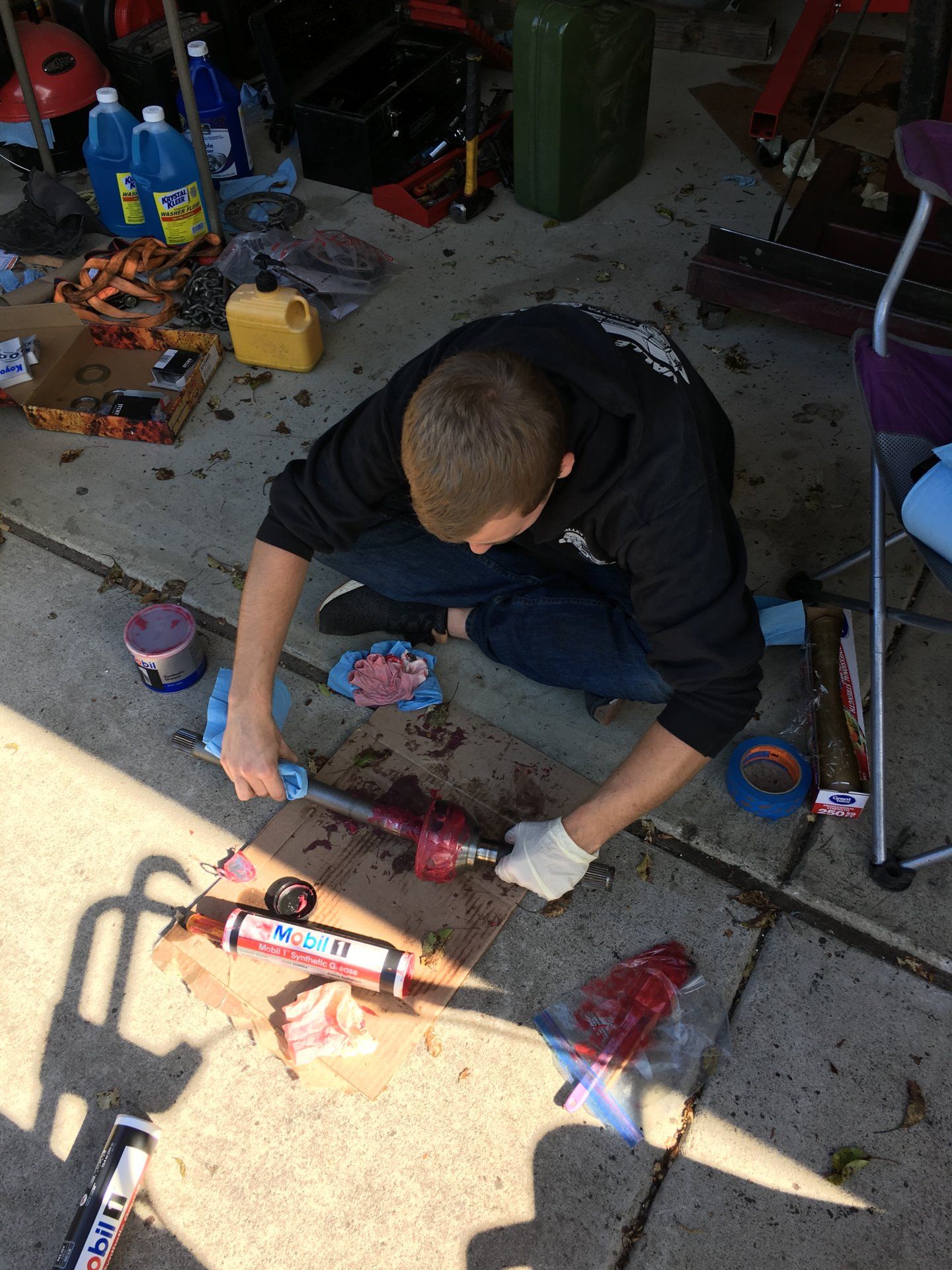

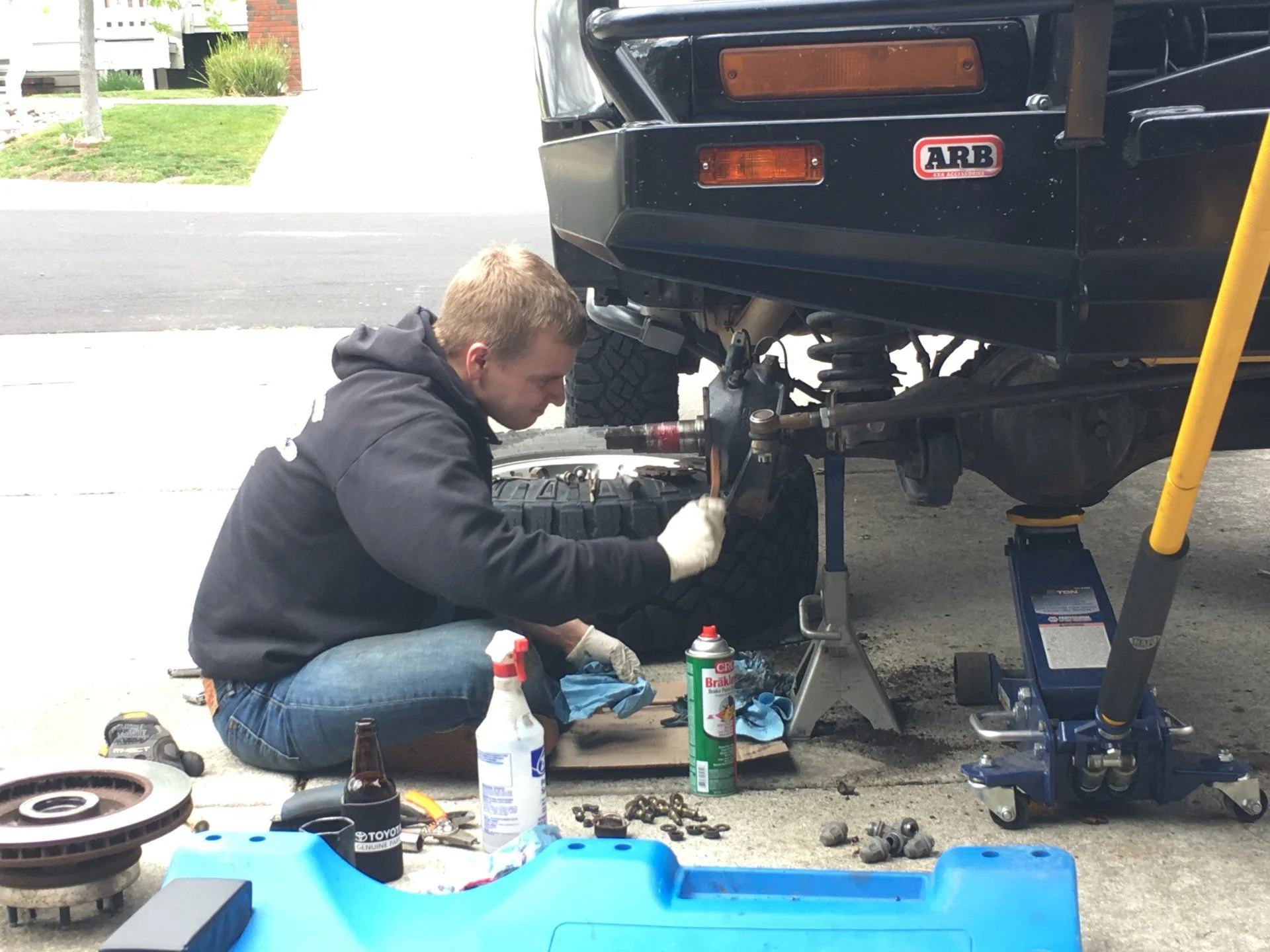

So Mrs. MountNGoat’s ‘97 80 is just about ready. It’s 3x factory locked, on 35’s, and only about 110k miles. In prime condition, it’s a real Black Beauty. But she’s determined, and having been down this trail four times is in no way underinformed as to the possible carnage.

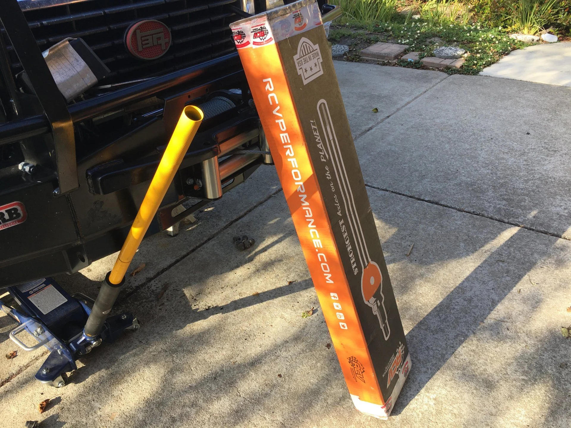

Last year @justintpryor broke his pside birf (he’s on 35’s, stock axles) early on day 1 shortly after leaving Loon Lake and limped it all the way into the Springs in either 2 or 3 wheel drive (3WD if he locked the front - which left him with no steering under braking as the broken birf just allowed the front pside to lock up under braking). Fortunately a spare was found - RCV’s no less - and after an IOU was established both sides were obtained but we only installed the short pside shaft in the springs after cleaning up the internal mess that comes from such an event.
With that in mind, RCV’s were procured for Mrs. MounNGoats rig, along with ARP knuckle and drive flange studs, from Valley Hybrids. All of this was installed this weekend, and unfortunately we discovered a full knuckle job was also in order after opening things up. As a bonus we now have both OEM front shafts as trail spares, and a bunch of OEM knuckle and drive flange studs as trail spares, too.
