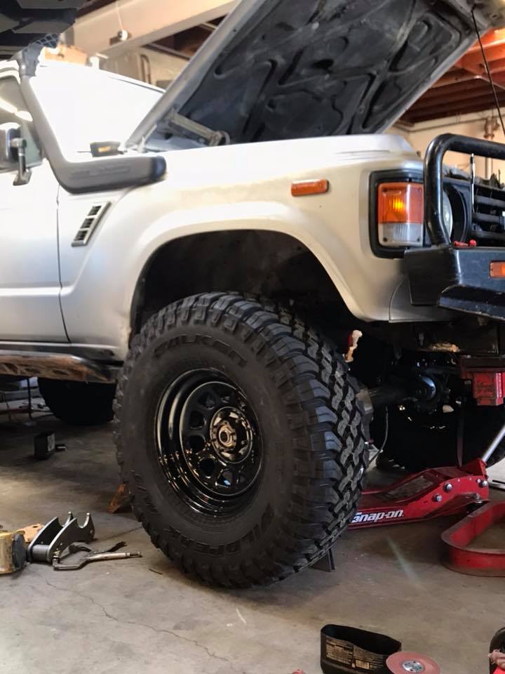

Getting closer...
(yes...exhaust will be rerouted...)

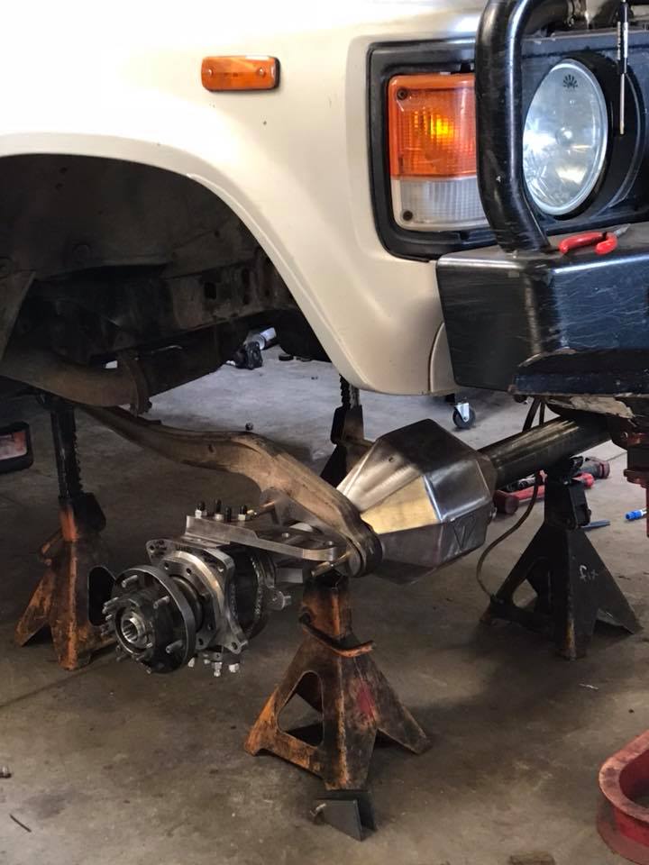

Very cool, I see a few people ditching the radius arm setup on their 80’s for 4 link setup so am a bit surprised to see you installing radius arms in your 60, of course flipped over like those folks down under. I can’t wait to see how that works. The keyed arms on top and the bigger diff and spiffy axle are also pretty cool.
Yeah I’m anxious to see how it all works, too. I did consider four linking it but there just isn’t going to be time. If this doesn’t work as well as I would like then I may give that a go.
If you like the way the front of an 80 rides then I would think this would be pretty similar. With the flatter (less angled) radius arms, better than an 80 with a 6” lift. Has Georg or Dom figured out a way of widening the bracket at the axle and using longer bolts with spacers in order to prevent binding and free up the arms a bit?
Looks like good progress @MountNGoat . Rear is in, the diff is trivial, the front is coming together. It should be ready soon! Curious what brake master they will use and the rest of the plumbing. It's going to be huge!
We’re talking about it...
