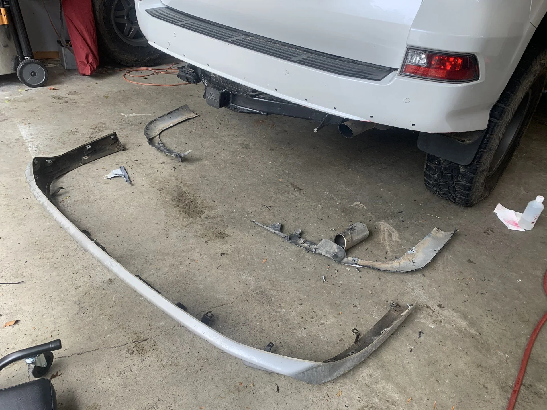

A couple of quick mods this weekend. The GX is well know for the plastic cladding that restricts its of road capability. My rear bumper cover had already taken a few hits and my concern was ripping the whole thing off on the trail. First I removed the spoiler trim, then I cut approximately 3” off the cover. This has afforded me better departure angle. The mud flaps are now exposed to damage when backing up and getting sucked in so I made some cable restraints. Not sure the cable I used will be durable enough. We shall see. Lastly I was able to relocate the trailer plug connector up higher out of harms way. The receiver hitch should protect it. Most of this is temporary until I find/purchase a rear bumper I like. Before someone states it yes the final cut was filed smooth.

I hope we don't have to wait much longer for some new rear bumpers to drop.
I'm bit tired of waiting. I spoke with Jason Demello while in So Cal. He said it's coming after the 5th gen 4 Runner.
I am as well but I am personally not willing to settle for what I see as sub standard options that are currently available.
The Expedition One looks nice and is a very clean / elegant design. But your note about poor service and workmanship (and what I read) make me want to wait.
I need to raise my trailer plug connector like you did - it got close to hitting on my last trip out.
Spoilers really do spoil off road ability!
Okay... so it's a bad play on words, but hey! I've only one cup of coffee so far this morning!
Tex68w mentioned one time that his buddy destroyed his. I looked up the cost, they run about $400 bucks so I was always in the back of my head not too.
I mangled my trailer plug on a trail and need to fix that some time and then tuck it up so it doesn't happen again.

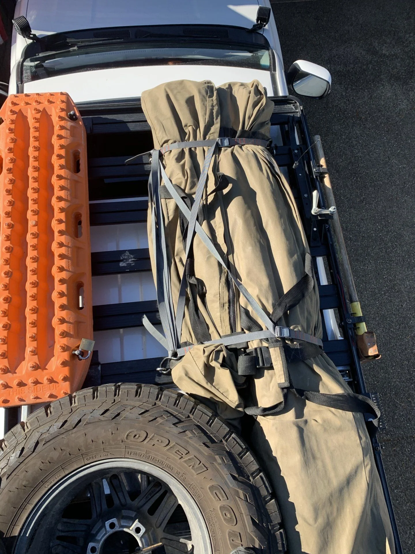

Been a while since posting. I took a 3400 mile round trip to New Mexico. The GX performed flawlessly! Loaded up with camping gear for two people for 10 days she was a bit heavy @ 7300 lbs.
A glaring need did arise while driving down to NM. Gearing, I rarely got into 5th or 6th gear. 5th gear maybe 25% of the time and 6th on long down hills. This was evident in the 13 mpg @80-85 mph. Granted having a Oz Tent and the spare tire on the roof rack was no help but the gears need to be addressed and will be after the holidays, January/February time frame.

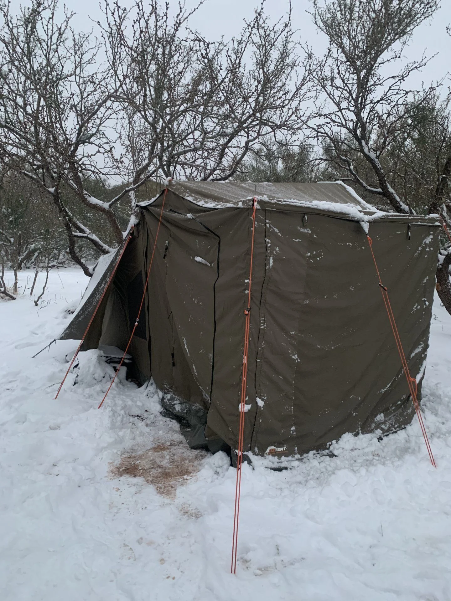

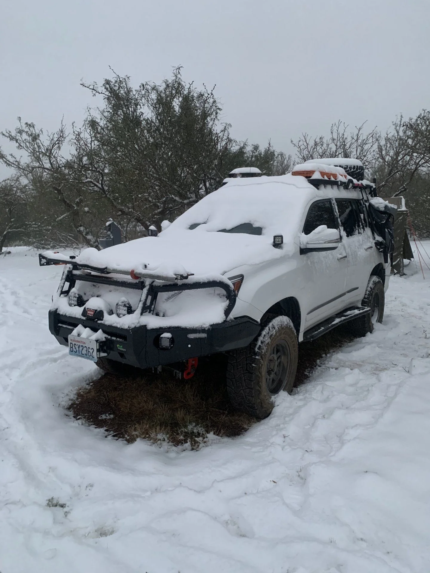

Monday evening that all changed. We had rain, hail then 4” of snow Tuesday night that stuck around until Thursday morning when the sun and warm returned. Fortunately we were prepared for the weather with proper coats, rain gear and a Mr Heater Buddy heater for the tent.
During the heaviest snow one of the telescoping poles collapsed under the heavy wet snow. Simple fix was to reset the pole and ensure it was fully locked. We used a rake to remove the heavy snow off the tent roof.
For base camping I love the Oz Tent. Plenty of room for two adults, two separate rooms, one being the tent itself and the other room being the awning with walls. The heater helped to maintain comfortable sleeping temperatures although condensation was an issue in the awning room.

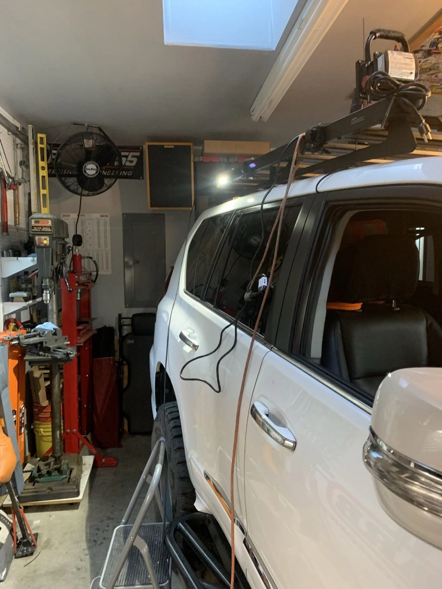

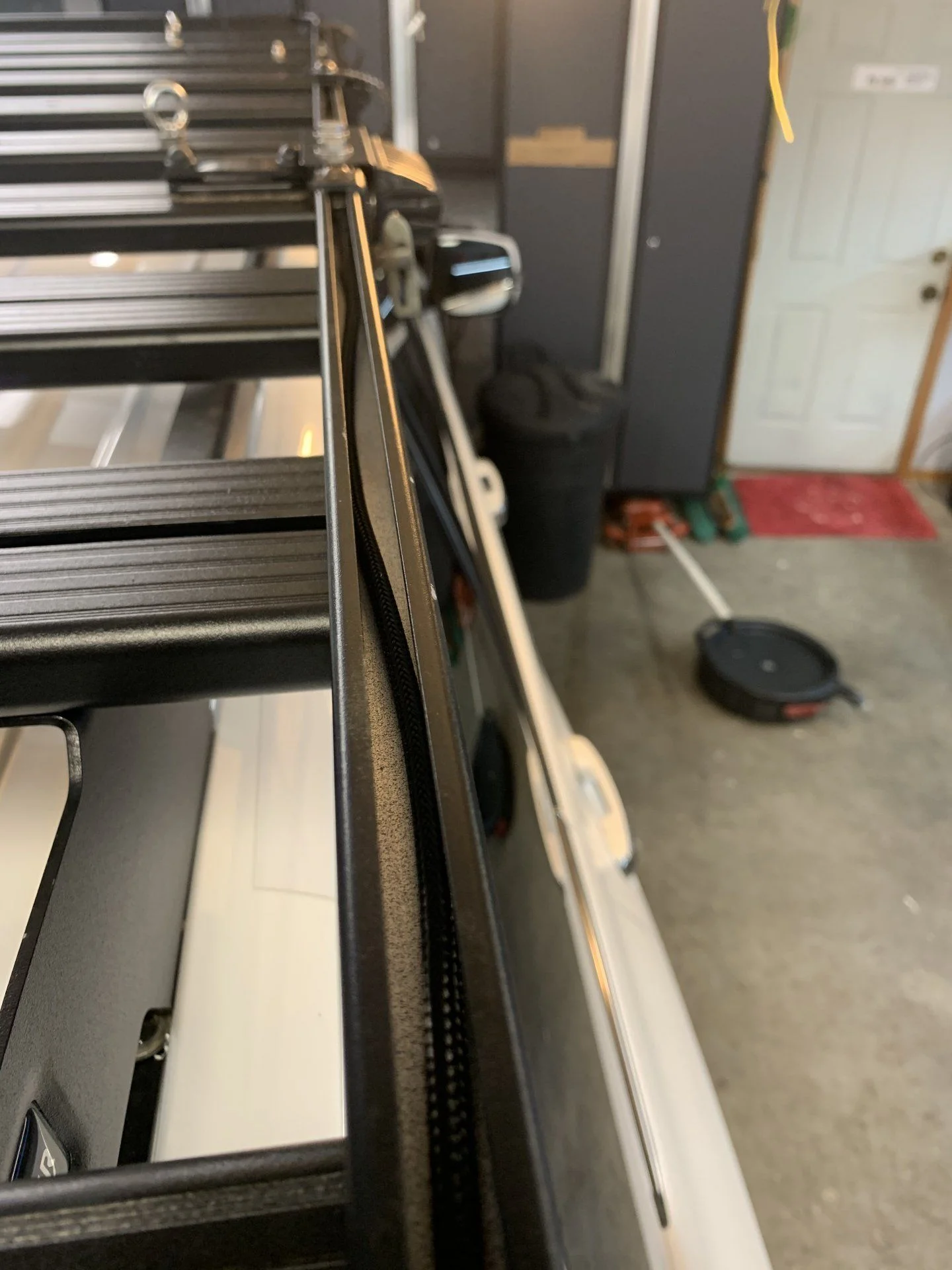

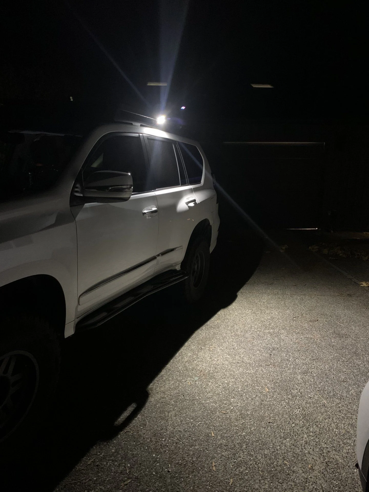

Prior to the trip to NM I had mounted my Rigid scene lights but hadn’t wired them due to higher priorities. With the sun not rising before 7:00 am they would have been useful. These were previously installed on my Taco and are very useful especially with ski season coming up. I camp/ski around the West in the winter, with short days they are a necessity for me.

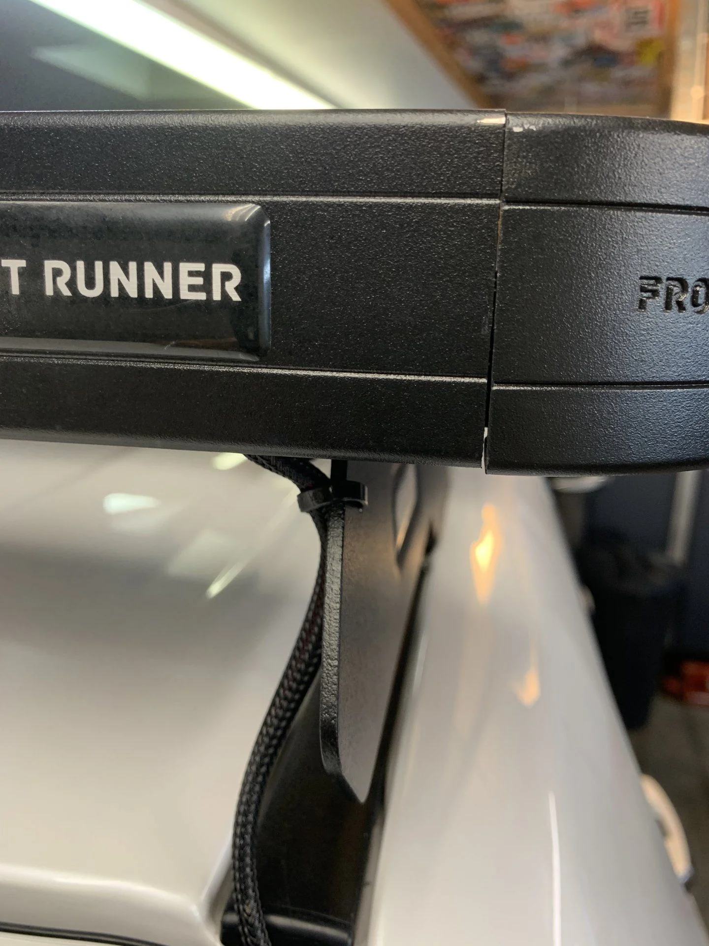

Easy wire up and routing. The Front Runner roof rack channels make hiding wiring a breeze. I just located a few well place holes in the rack, ran the wires aft and down the rear door jamb and behind the right taillight housing. A couple dabs of RTV to fix the wire in place.
