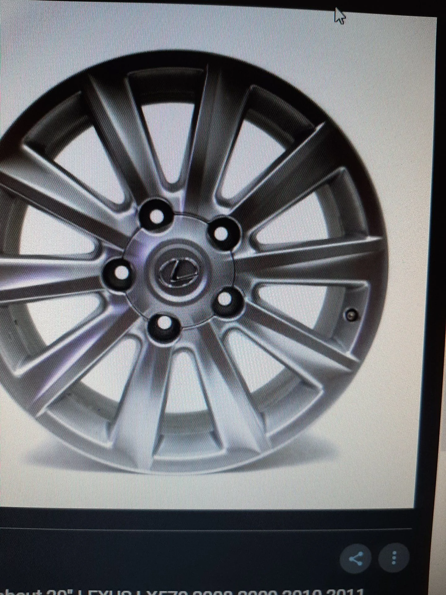

Yes they will work. Yes you can get the LX center caps from the LX 20" rims and they are the same size.

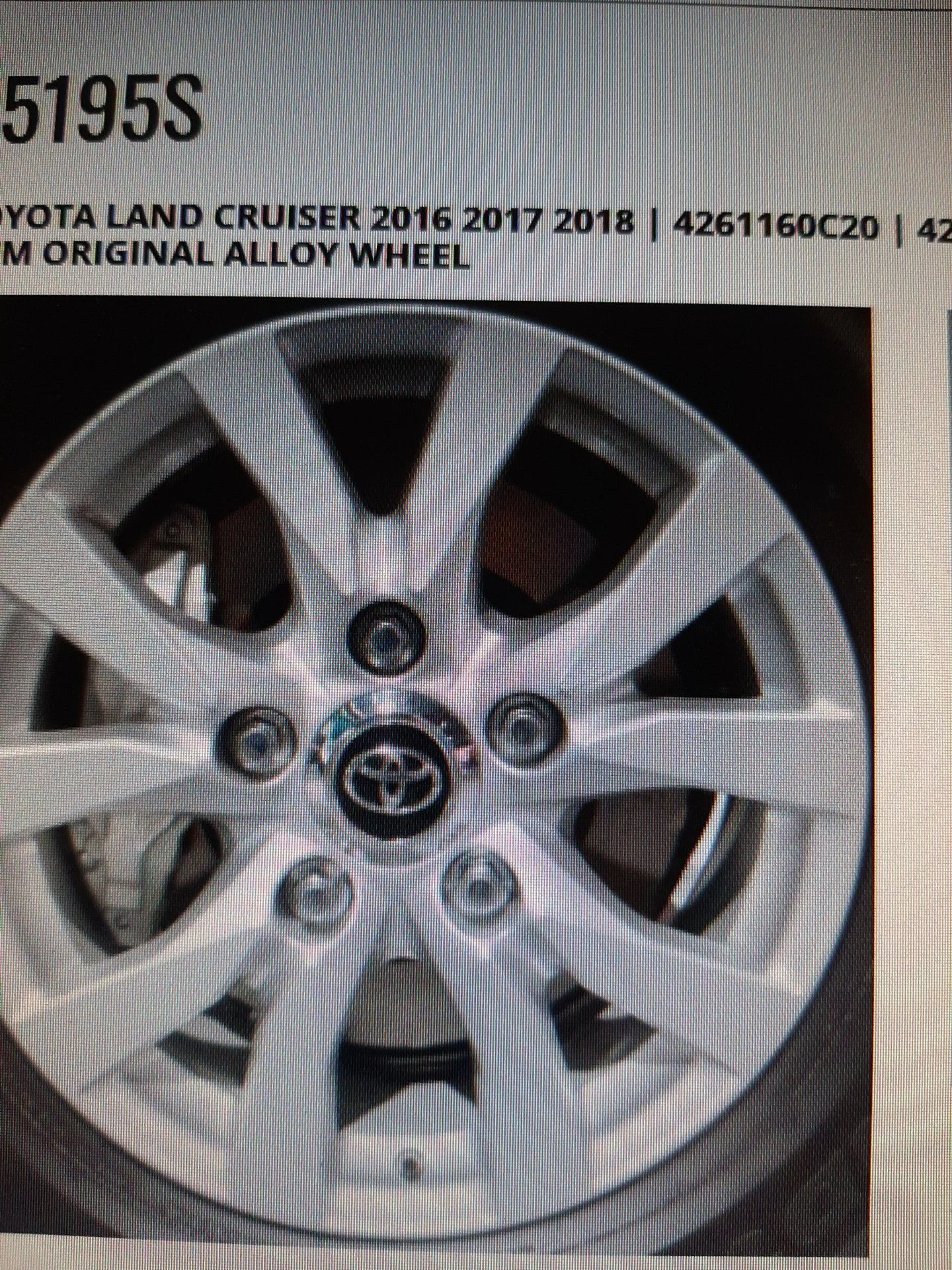

Anyone know if the center cap from my 2010 Lx570 20" wheel will transfer to 2016-2018 Landcruiser 18" factory wheels?
Not understanding how the center cap will swap. They are completely different.

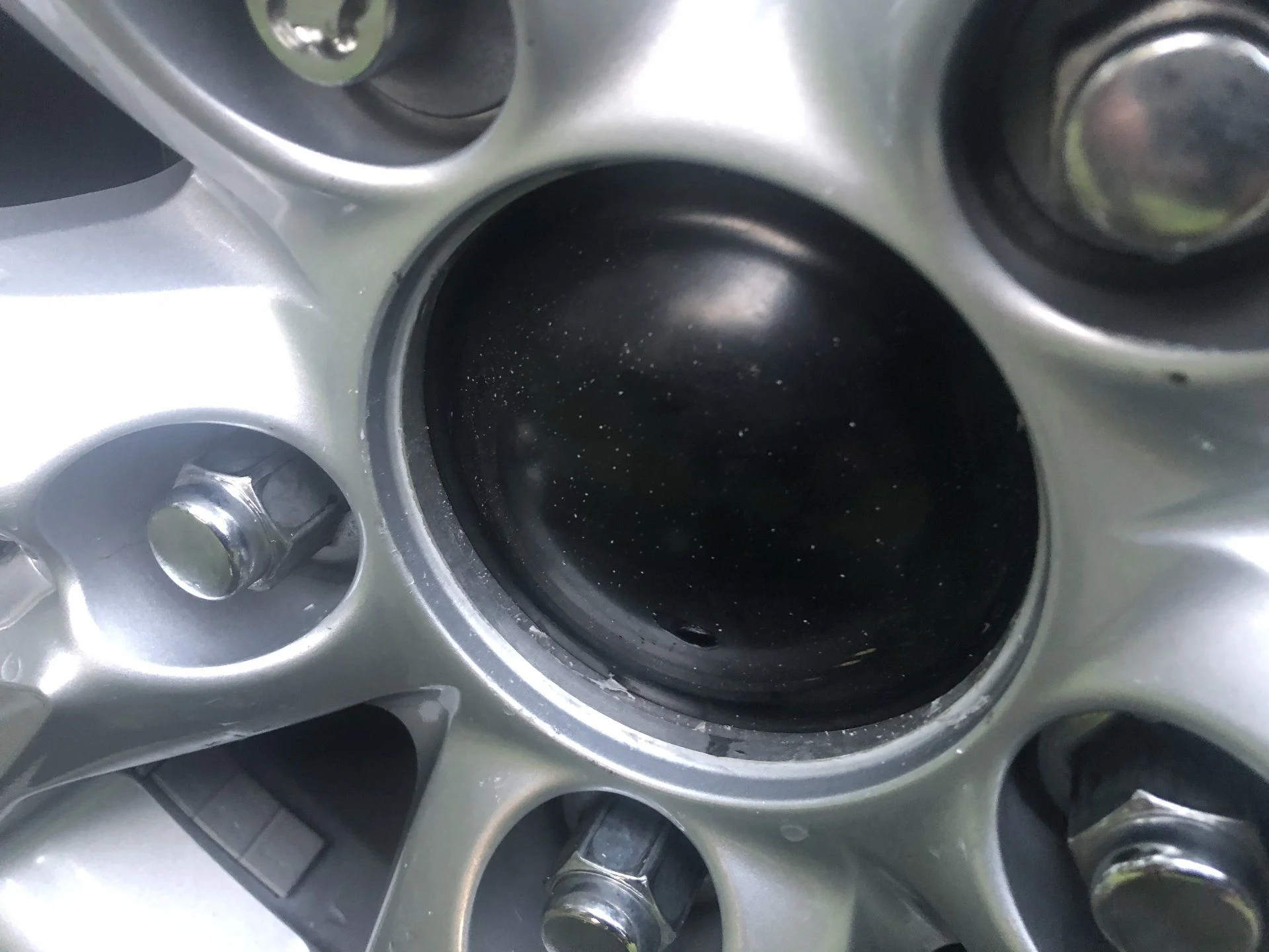

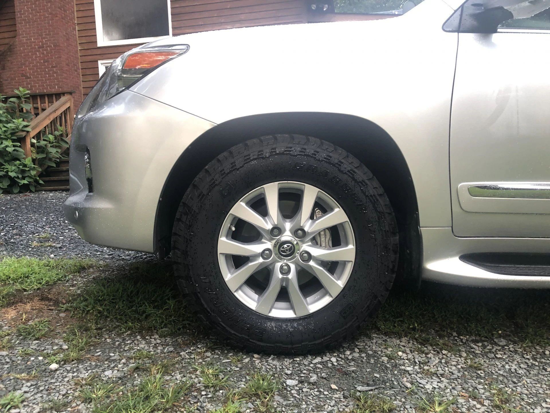

I just had this done and the center cap does interfere. It pushed the front center caps out about 5mm. I had to trim the back of the caps to fit. The tire shop did not say there was any issue with fitment when installing other that the center caps. This is the part number for the Lexus center caps for 2016 cruiser wheels. 4260B-60390
Yeah - don't mess with the hub cover when you can just sand a few millimeters off the back of a plastic center cap to solve the problem (fronts only).

Is it just the hub cap on the wheel that won’t fit or the wheel itself that hits the metal cover on the hub face?
It is just the plastic center cap that sits slightly proud on the front wheels. Unless the LX is drastically different than the LC. But the LX photo above seems to indicate it's just the front plastic center caps that need slight modification (sanding plastic that does not change the clip section). Its common that the tire shop doesn't want to mess with the possibility of damaging / modifying the center caps, but its not hard to remove a bit of unnecessary plastic yourself and pop it in.

Good to know. The person in the past that removed the metal hub nut cover had me thinking it interfered with the wheel itself.
This is the best picture I could find.
and here's what needed to be trimmed to make them fit:
Here is what it looks like with the cruiser caps. There is a wire pressure band on the back and I trimmed just to that. The wheel does touch the dust cover but it’s also matted flush to the rotor. I typically worry about everything and this is one I am not worried about
