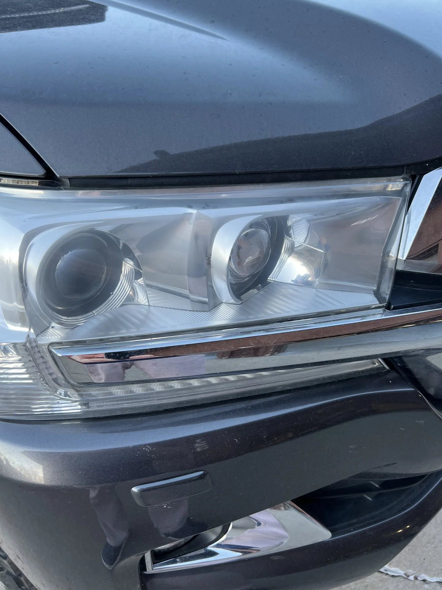

My 2018 w/ LED headlights has developed interior fogging over the past 2 years (slowly increasing, not dependent on weather and I haven't replaced parking light bulbs). This fogging is definitely on the inside and in both headlights as I have used an exterior polishing kit recently (Cerakote ceramic headlight restoration kit) and could see an effect on the outside surface with no effect on the fogging. My LC lives outside in the NM sun, so there is no shortage of UV, but I would find it odd that UV damaged the interior and not exterior. Has anyone experienced similar interior fogging? On my 5th Gen 4Runner I would experience condensation if the bulb cover seal failed and we had high humidity conditions (pretty rare here). I tried pulling the parking light bulb and blowing compressed air into the assembly with no improvement. I am contemplating removing the headlights and trying to inject an alcohol solution in and swishing it around the interior lens surface before drying out again. At night, with the headlights on, I have light diffraction from the fogging which irritates me, but probably doesn't diminish illumination effectiveness too much. I bought this as a Toyota certified used vehicle in 2020, and headlights are explicitly listed as not covered under the warranty. A couple pics:

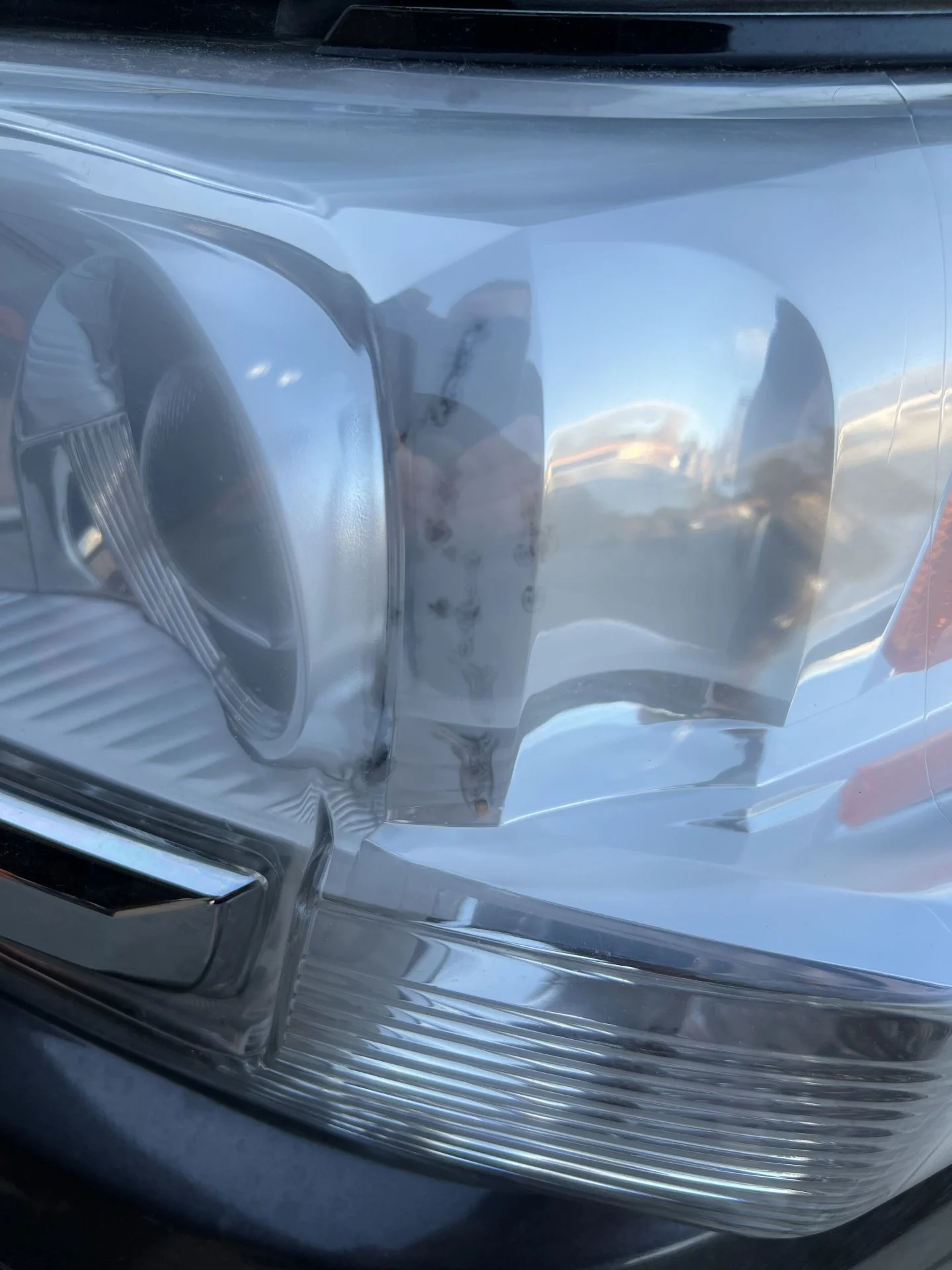

Do you by chance have any very small cracks in the headlights? Lots of intermittent loose flying gravel on I-25 that gets kicked up.

Does it seem like it is actually water vapor? If the lenses get warm in the sun does it dissipate?
I’m wondering if something else got in there and vaporized then coated the insides of the lenses. Often actual water vapor will tend to be very responsive to warm/cool parts of the headlight bucket and form larger and smaller droplets, vs a super even ultra thin coating as in the pictures.
The outside of my headlights are in pretty good shape. We do have alot of rocks on NM roads, as evidenced by the chip in my front camera, but my headlights are intact. The vaporization comment from bloc is interesting. The fogging looks like condensation, but not typical water condensation (and does not go away in direct sunlight). This remined me that when I purchased my Land Cruiser, the dealership used some awful detailing product in the engine bay. It left all the surfaces coated in a slimy layer that took me quite some time to clean. I wonder if it got into the headlight housing and has been drying and attracting dust on the inside surface.

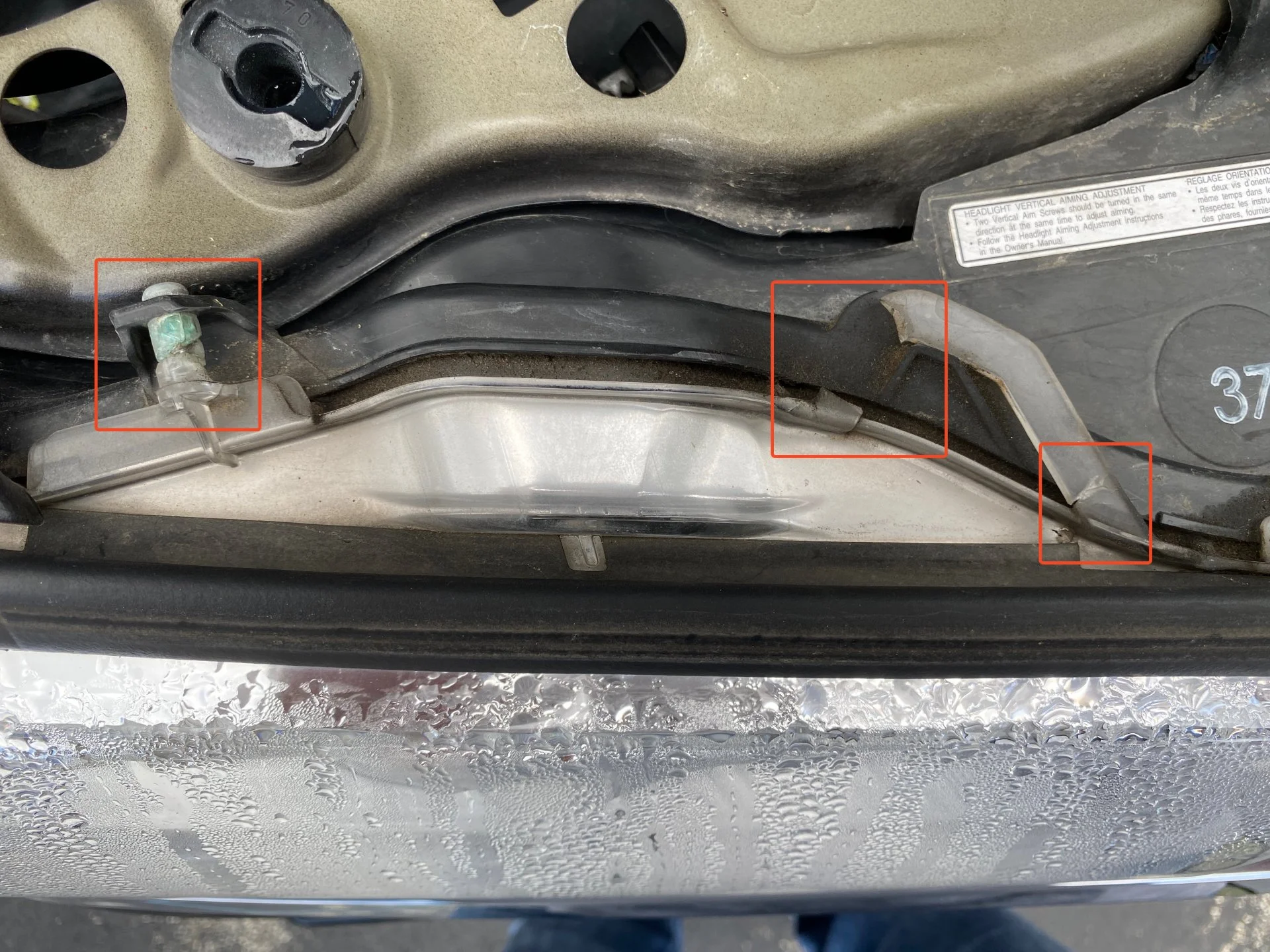

I have a 2016 LC I purchased in 2021, shortly after I noticed it start to fog slightly. It got really bad after a trip to Wyoming and then South Florida, may have been due to the temperature and humidity along with the occasional washing along the way. I Just ordered a new passenger side headlight due to major water inside the housing. I did attempt to dry the interior and it lasted about a day. The plastic screw hole and clip that holds the lense has cracked, probably due to an impact of some kind.

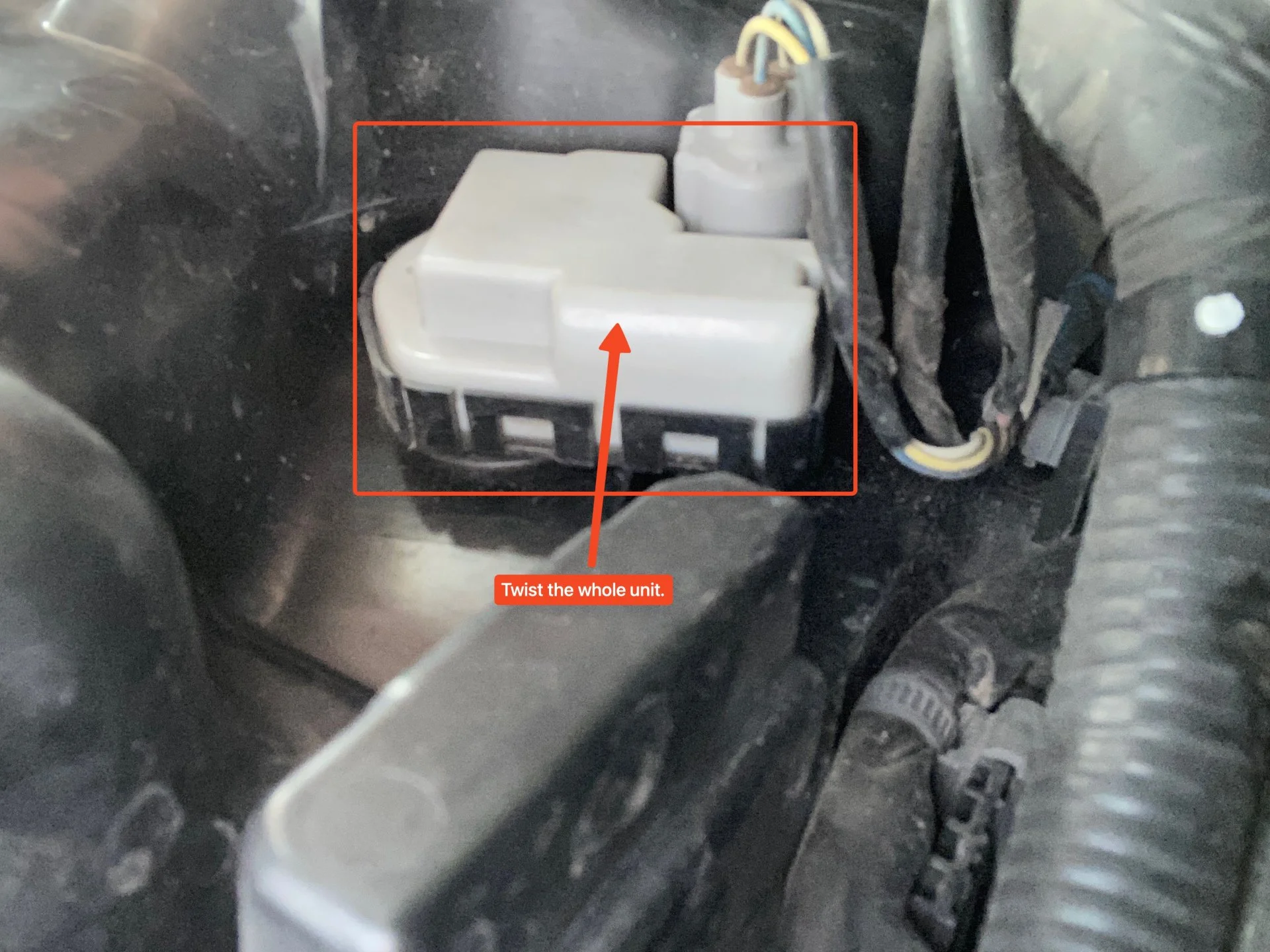

You can remove the headlight leveler to access the main cavity, the whole thing twists of like the turn signals. I ran a hair dryer (heat off) through the hole in my attempt to dry it, like I said it did not last long. There is a black rubber washer on the leveler so be sure you don't lose it.
Leveler on the back of headlight.

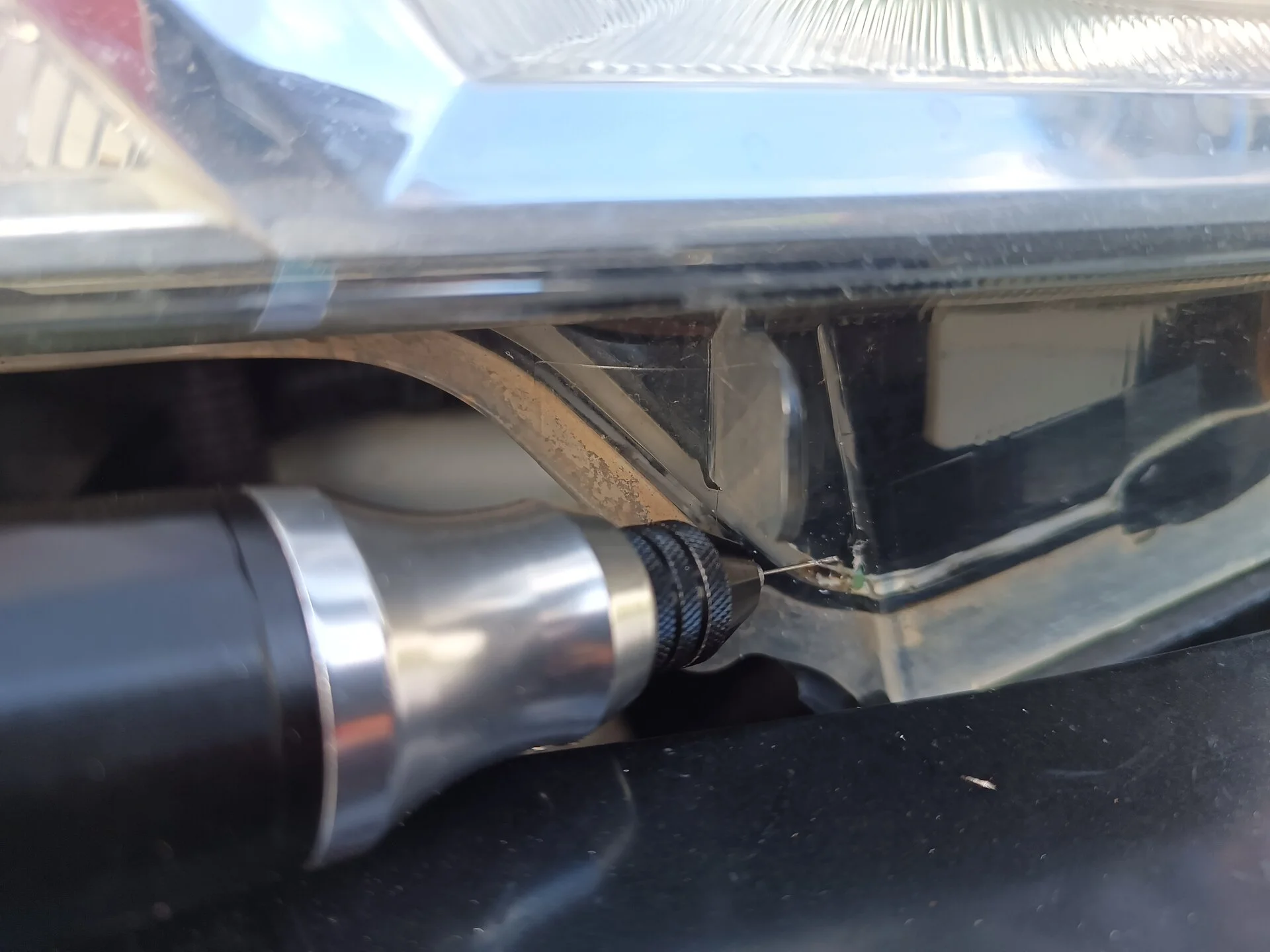

I drilled a tiny hole at the bottom of what looks like a triangular liquid-collection-point - a nice puddle grew as loads of water dripped out, but that did not make any noticeable difference to my problem (the rest of the moisture stays stuck to the inside of the enclosure, and never runs down to where I drilled the hole)
I ended up with so much water in my headlight that my lights would flicker occasionally as the water slapped around. It would appear to other drivers like I was flashing my lights intentionally at them and I knew eventually this would cause me some trouble. Because of the cost of these units I decided I would try replacing it myself. I decided halfway through the repair to start videoing what I was doing, so apologies it's not very complete. However, watching the reassembly will hopefully give you confidence that you can easily tackle this job.

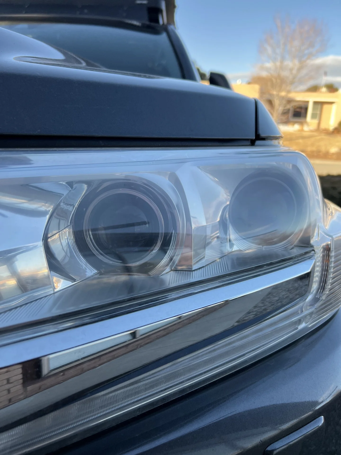

I have fogging inside my 2021 heritage headlights. Thought it was water vapor and tried drying with a desiccant pack inserted in the turn signal lightbulb access. No change. Doesn’t respond to sun/heat. Inserted a pipe cleaner and was able to wipe a little of the haze. Seems more like outgassing or “smoke” deposits.

If there’s haze (condensation) inside the housing, you’ve got a compromised seal somewhere. You’d have to do the alcohol bath a couple times a year where I live to mitigate this until you found which gasket/seal was compromised. @daneo follow up with what Toyota says as it’s early for your ‘21 to have this happen imo.
