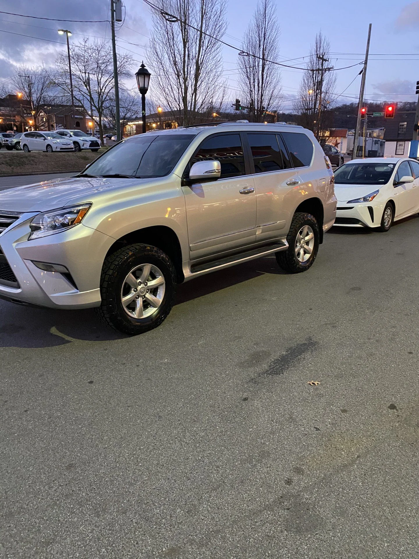

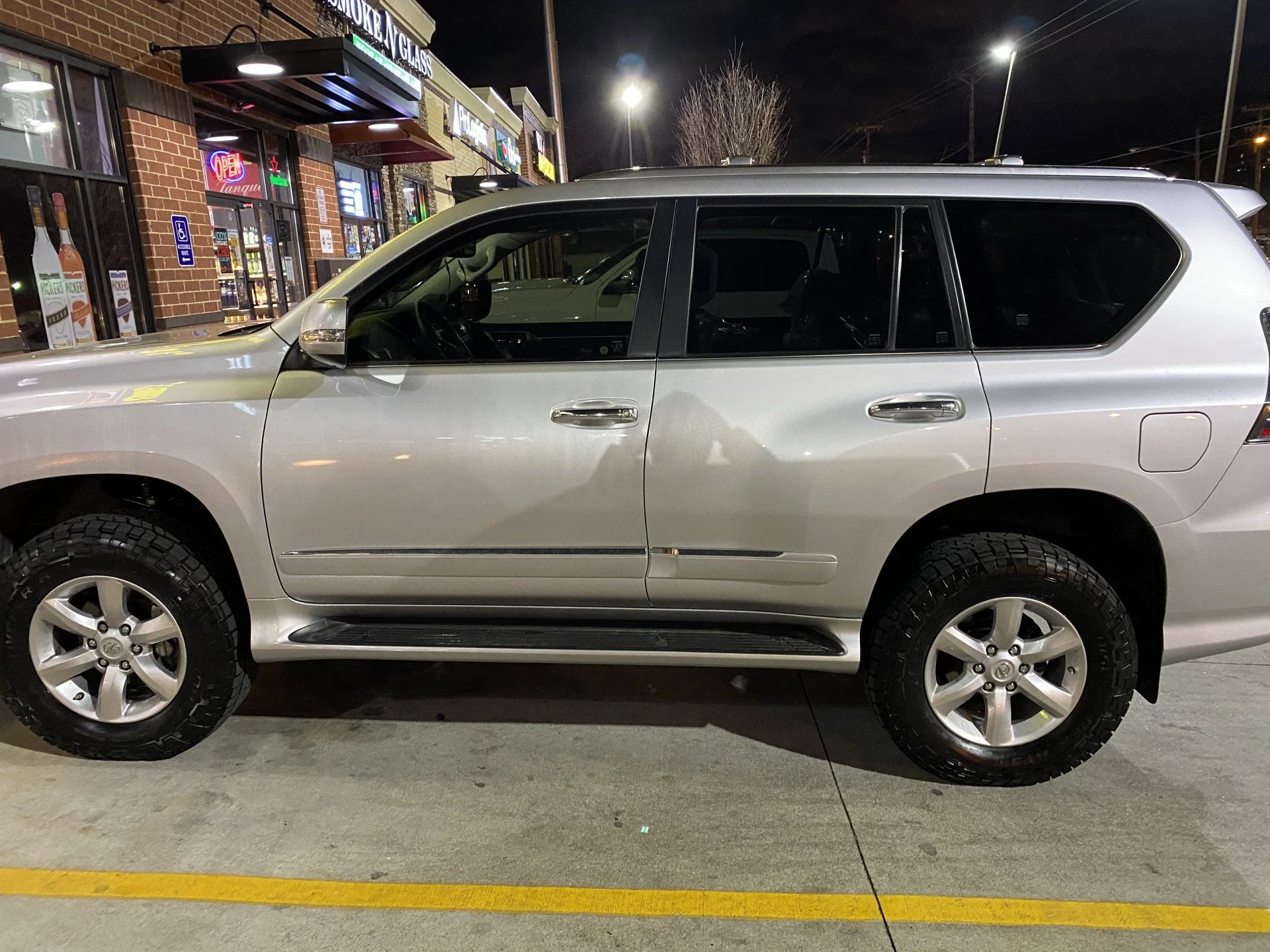

Got it done over the weekend. Turned out great.
OME - 3 inch lift
Tires- Cooper Discoverer at3 xlt all terrain.
