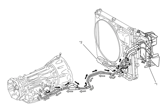

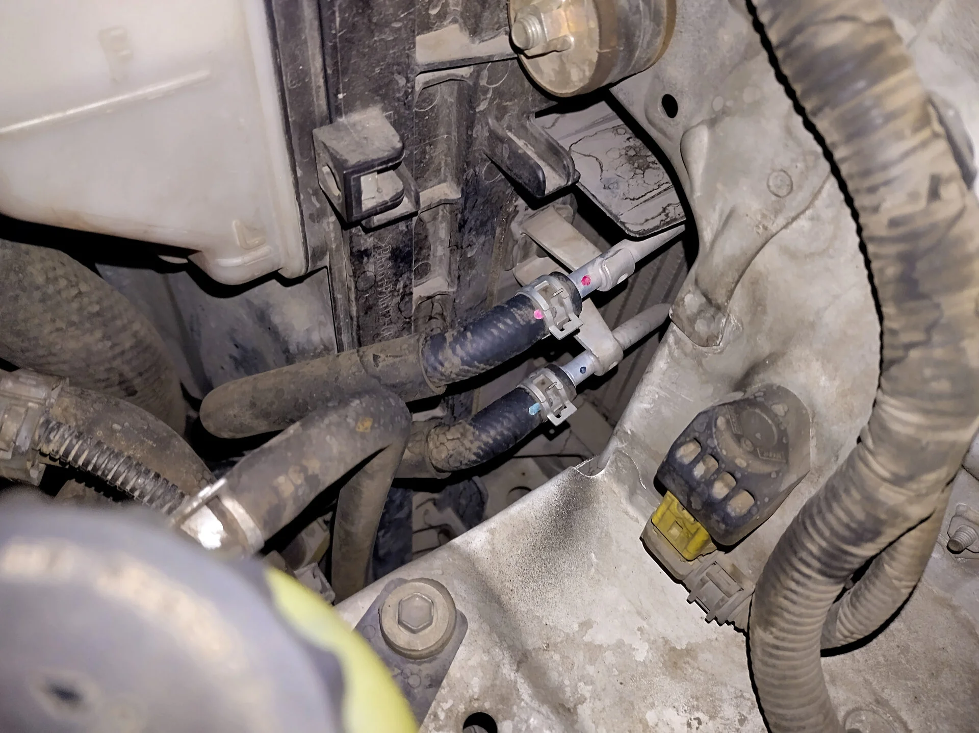

I still don't understand why you guys say to disconnect the upper hose with the pink dot (red)
If according to the scheme
The return line to the transmission is the lower hose with the blue dot. If We need to flush both coolers, then, why are you talking about the top pink dot hose?🤔
Hey Vasiliy, the lines you are referring to are not the lines you need to disconnect to complete a fluid transmission replacement since those are near the side of the radiator, rather than the bottom of the radiator.
You’ll need to remove the skid plates from the bottom of the vehicle and look from the bottom of the vehicle upward to find the “pink” marked hose (passenger side of the main radiator) which is the actual return line going from the main radiator back to the transmission.
Sorry for the stolen thread, but I recently myself got stuck in the flush step and wanted to create a similar thread.
That is the correct way. The lower hose with the COLD BLUE is the return line from the cooler.
This line is going into the transmission, and by the transmission is where you disconnect it.
BLUE = COLD and RED = HOT.
