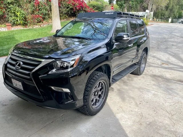

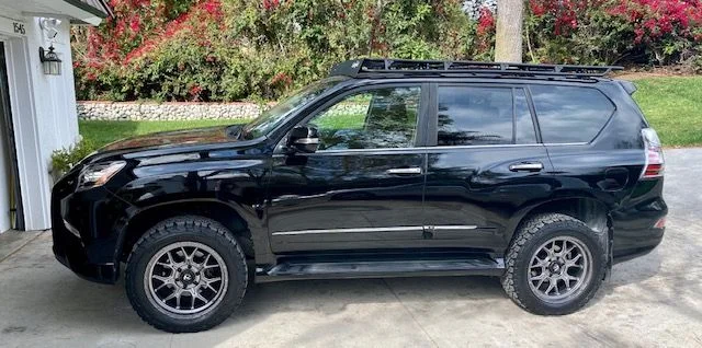

I just wanted to thank all of the contributors here at ih8mud for providing great information and inspiration. After much deliberation, I ended up going with Bilstein 5100 lift in front (1.75") and coil spacers ( 1.5") in the rear, with stock shocks for now. The wheels are 20x9 FUEL OffRoad Tech with a +1 offset. Tires are BFG All-Terrain K02 275/55/20 and I am pleased at how quiet they are. There is some plastic trimming I have to do on the innermost part of the step, but it is not too bad. I love the look, and the ride is distinctly less cushy but not brutal. The Gamiviti rack is perfect for my needs and looks sharp.
I also put on the Magnaflow Overlander exhaust to make it sound more truck-like. Next up: chrome delete and front window tint. My mid-life crisis will then be dealt with fot the moment...
Very clean looking! Just a suggestion, replacing the running boards with black solid sliders could be the final touch! :meh:
And with metal sliders aside from being far more sturdy, you can also use them as a jack point if you ever need to lift your rig with any kind of jack!
I guess I have to admit that would be a better plan. And, there are some nice sliders out there. I guess more decisions await...
