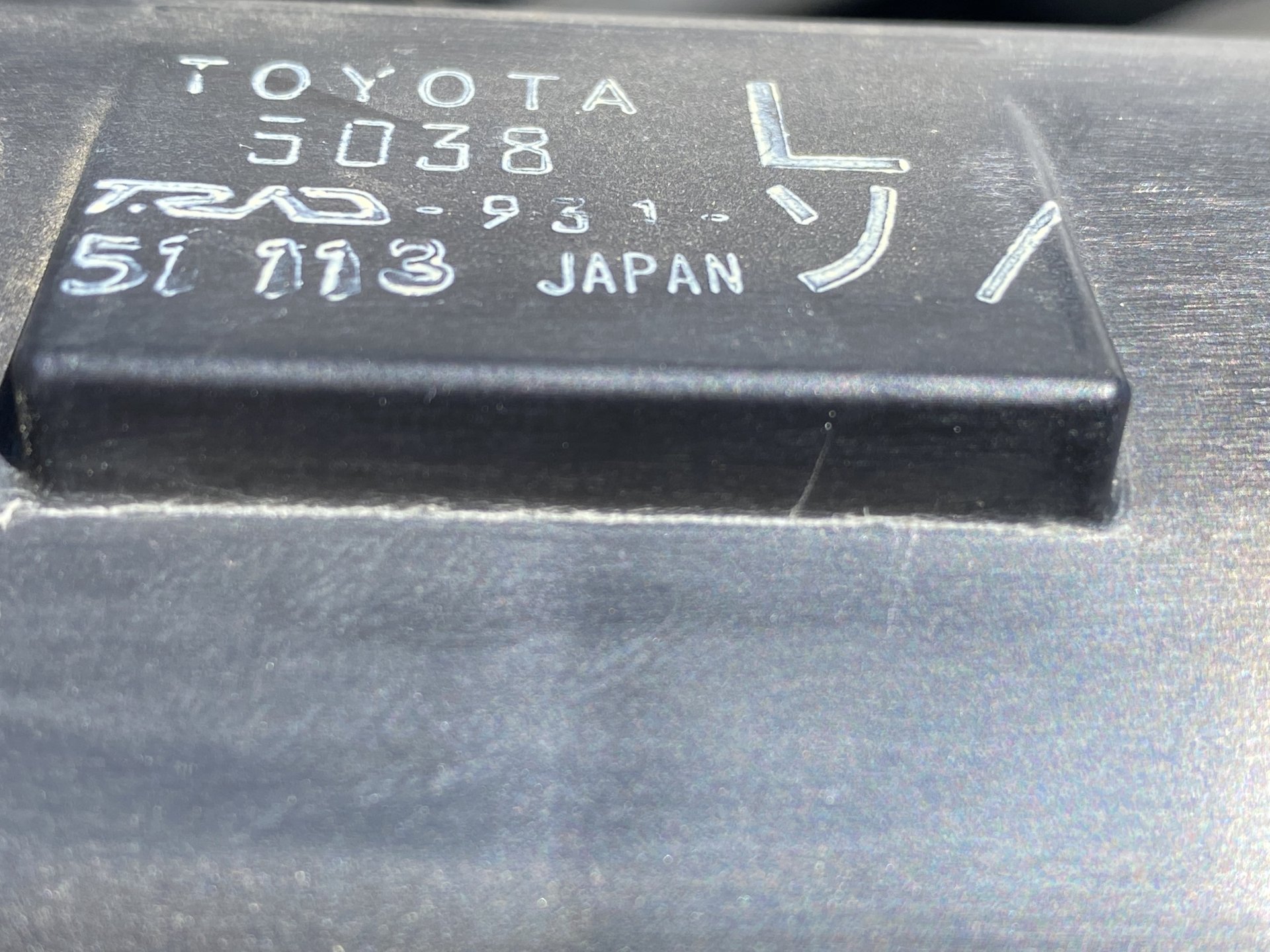

Hello everyone! I realize this is a fairly well covered topic, but wanted to just post a photo of my radiator to get some feedback. Has the hairline crack in the top of the radiator. No signs of leaking yet. Planning to drive about 500 miles to San Diego next month, and then going to AZ (hot!). My plan is to replace radiator myself once I get to AZ with my dads help. I do not have time to do it before I leave (military xfer and extremely busy getting house cleaned up and packed). I received quotes ranging from 1200-1500, which seems high but then again this is CA. So anyone have a magic 8 ball that says I’ll be ok to make it to AZ? Thanks for reading!

Well, here's what it looks like when the crack finally goes.
