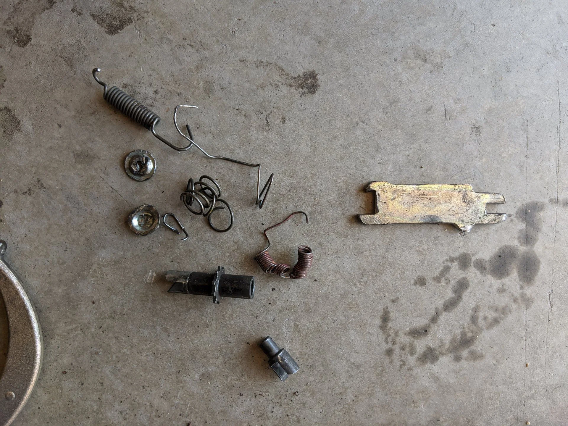

Didn't expect to spend my Friday off replacing the passenger side emergency brake, but life happens. I was driving down the road and noticed a faint whine coming from the rear of the car. It was only really audible with the window down. Jacked it up and applied the emergency brake to test if the wheels would spin. Spin they did. I attached a picture of everything that fell out like a pinata when I took the rotor off. Need a couple parts from Lexus, but got most of it back together with a hardware kit from Autozone.
  • Wow

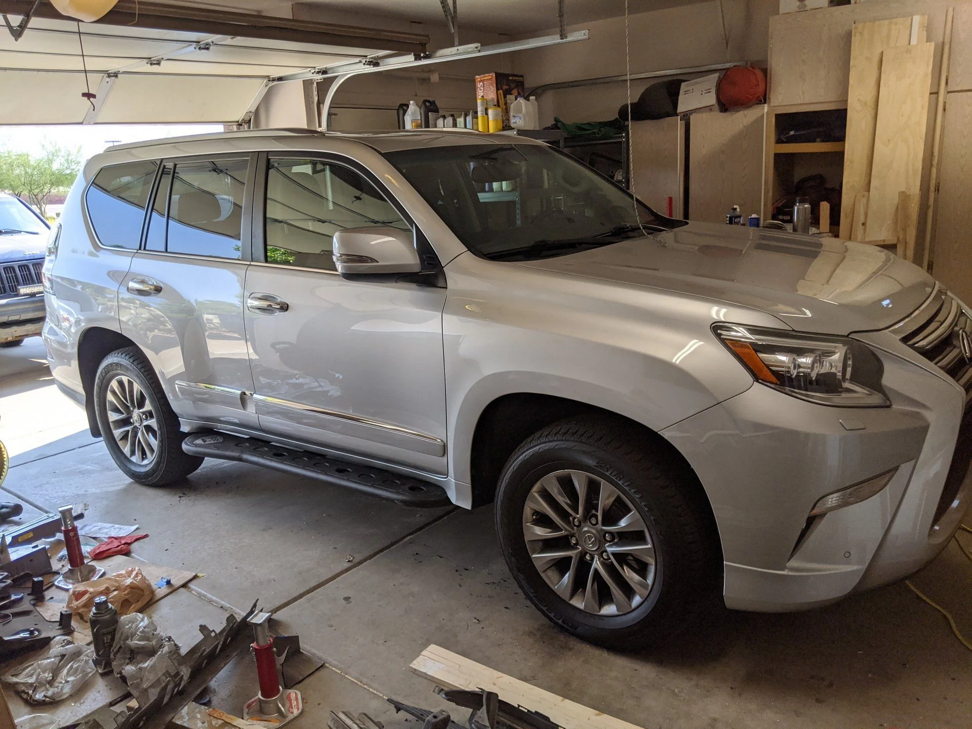

Got the RSG Sliders this weekend. There were dead on with their lead time estimate of 5 weeks. Powder coat looks great and no shipping damage. Installation took me a while, but overall it was straight forward. Hardest part was getting the lines right for cutting the plastic molding. I ended up using an angle grinder for the rough cut and then finishing using an orbital sander with 150 grit paper. Any one have suggestions for replacing the running board lights?
That's a pretty big gap behind the front tire before the slider. I can't tell if its the angle of the picture, otherwise I'd be worried about coming off a rock and catching the body.
I have the same sliders but angled up 20*. The gap up front is certainly larger than some would care for but the odds of something getting in there and doing serious damage with a lift and larger tires is slim in my experience, but it's certainly possible.

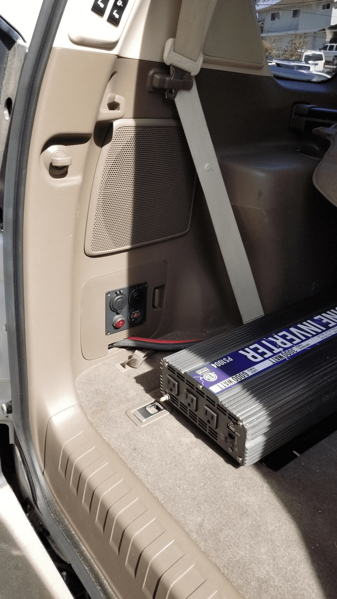

Have not had much time to work on the truck with the new baby. I finally got out and installed a new 12V socket for the fridge in the trunk area. I ran an 8 gauge wire directly from the battery and then grounded to the body on a stud in the jack area on the driver side of the car.

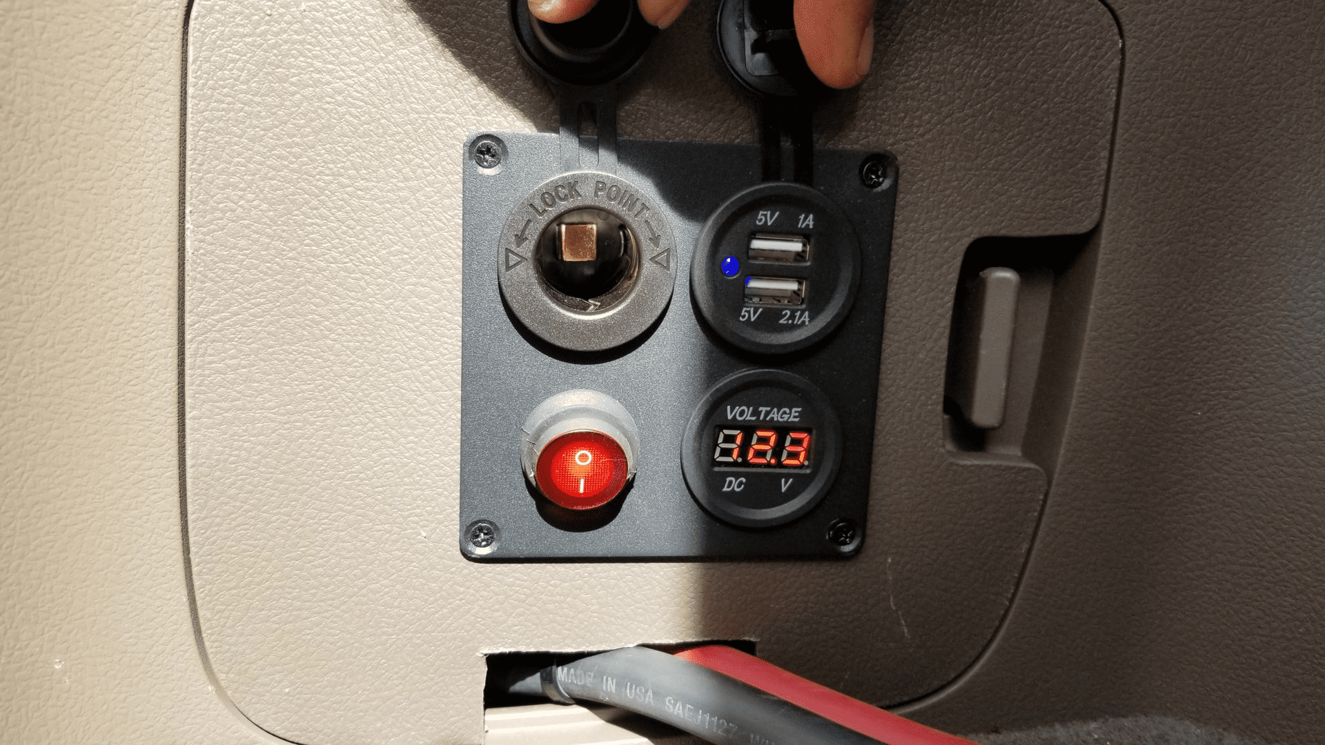

I also installed quick charge usb outlets in the rear for passengers right under the climate panel. At the same time I installed quick charge usb ports in the glove compartment for the driver and passenger. If anyone else is going to install using the cut out in the glove compartment, make sure you get the right sized usb. Fairly easy with an add a fuse.

Same place I put mine! Great location, I use it all the time, especially with my fridges.
Love it! Where did you end up grounding to? I am not in love with my solution of sanding around the only stud that I could find. Can you post a picture?
I have a massive 3000 watt pure sine inverter in the back also, so I ran 1/0 AWG wire (about the diameter of your pinky finger) of both positive and negative to my batteries up front. I ran the wire up and above my sliders so they were tucked up and way from any possible trouble I get myself into.
Then I just tapped into the + and - of that fat 'ol wire for my auxiliary power ports (USB and 12 VDC socket).
