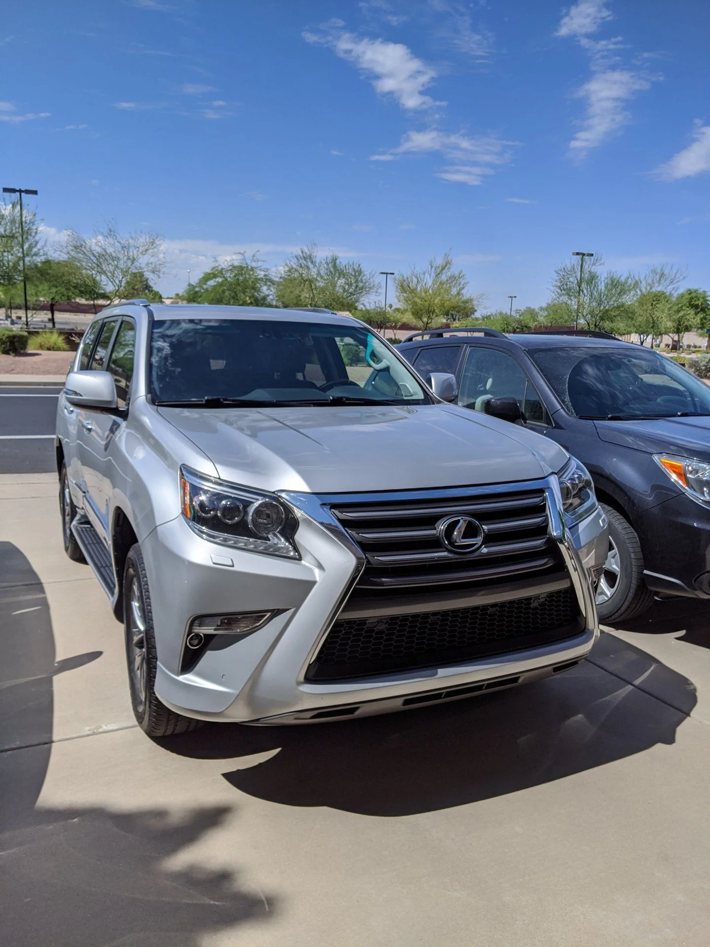

Hey Guys,
We just picked up a 2014 GX460 Luxury with 90k miles after 9 months of searching. We are coming from a 2006 Jeep Liberty which was an excellent gateway drug to off roading. We honed in on the GX platform very early in the process because of the capability with creature comforts. We decided that we wanted something that was larger and newer since we are also going to have our first tax deduction in November. This also means that I basically have 4 months to get everything situated!
Goal Of Build - Make a functional off road vehicle that is also an excellent daily driver. The off wheeling that we typically do is light to moderate and would probably be best classified as overlanding. We plan on using the vehicle to get to amazing places for hiking and camping. We have basically transitioned from backpackers to car campers at this point.
Goal Of Thread - Document the process of building the vehicle and provide the important/difficult things that seem to be left out of YouTube videos and posts. Also, contribute to an online community that I have been lurking on for at least the past year.
Without further delay. Here she is -
https://photos.google.com/photo/AF1QipPpm1J73CvXinbDAnD_f8z_hai9PPUXc1MUK_0
Congratulations and welcome aboard; great color and starting point. Thank you for not buying a 4Runner 😉
Congrats. This truck looks like members truck thats listed on Clublexus. Look forward to your project!
