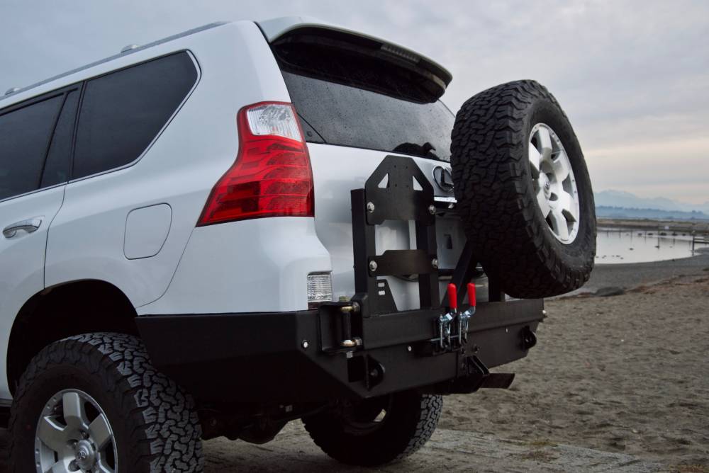

From my research we have three choices of rear bumpers, Metal Tech, Dobinsons and Kaymar.
I really like the Kaymar but the cost is rather pricey and is increasing tomorrow which doesn't make sense since the dollar is killing the Australian dollar . The Metal Tech is big and bulky. The Dobisons is an unknown, light weight? Both Dobisons and Kaymar have crap for pictures of the bumper structure and no recovery points. I have seen the Metal Tech in person and I'm just not a fan.
Am I missing a brand? I very much like the CBI Bushmaster II I had on my first gen Taco and would love to have something similar.
If you have first hand experience with the Dobisons and Kaymar please share and detailed pictures if possible.

I looked at all the options and the Kaymar was there only one out there that didn't completely screw up the look of the truck and I knew was the quality I wanted.

Regarding the Metal Tech rear bumper, I don't mind the style, although I wouldn't mind a little more departure angle and ideally being made of aluminum, but here's the good and bad:
Good:
  • When the swing-out is open, there is a huge step (almost a foot deep!). I've fount this to work like a tail gate (which we don't have). I love it!! One can sit on it, use it as a workbench or prepping food, of course a step for roof access, a rest before the final grunt on lifting something big and heavy into the rear deck, etc. I put rubberized traction tape over it so it's not abrasive to sit on but gives traction when standing.
  • I'm not a fan of dual swing-outs. Just more work to get to the rear door. So, for me I like the single swing-out.
  • I like being able to carry a lot of gear on it. e.g.: large ammo can with recovery gear in one of the jerry racks, water in the the other. Hi-Lift, made a simple attachment for MaxTrax and finally, least we forget the spare tire: LT285/75R17.
  • Shackles, 2x
  • Rear receiver
Bad:
  • Thin metal. Got caught up on some huge boulders of a "gate keeper" section on a trail and it did tweak my rear bumper a bit. Still functional and to 99% of the people who look at it, they would never notice it. I just chalk it up to battle scars. But I would prefer a heaver gauge material (either thicker or higher strength metal or aluminum of a proper gauge).
  • The swing-out does not align perfectly with the De-Sta-Co clamp when closing. I have to give it just a little lift to nest in there. I can just slam it, but I don't like being hard on my gear. When close, it clamps fine.
  • I have already sheared off the locking pin that is by the swing-out hinge. Note, it will hold the swing-out in place when open, but don't let it fly out or put a lot of strain on it, it will shear off. Metal Tech was kind enough to send me another one, no charge. :)
  • This may be a personal thing, but I'd like the spare and jerry can racks to be mounted lower on the bumper for a couple of reasons: a) more rear visibility, not blocking so much of the rear window. b) lower CG. (although with my roof top tent and all this may be a mute point :meh:)
  • The little "gas shock" for containing speed of the swing-out on a hill is useless. I can't feel a thing with it. I always keep a hand on the swing-out when opening and closing to ensure it doesn't slam in or out. With all that weight, that wee gas shock should be WAY beefier.
So, that's my 2 cents worth. Okay, it may be more like 2 bits...

In case you haven't seen it, I have a full installation write-up for the Kaymar on my build thread starting here: Builds - His and Her GX 460 Builds
For what it's worth, I first tried the MetalTech and feel the price difference for quality is 100% worth it. Much better made, more functional, and lighter to boot. Just my personal $0.02.
I have read on the Kaymer site about options for the bumper such as the wing supports. Are these supports not standard for the 3200 asking price? I am one that will use the bumper to its fullest potential.
