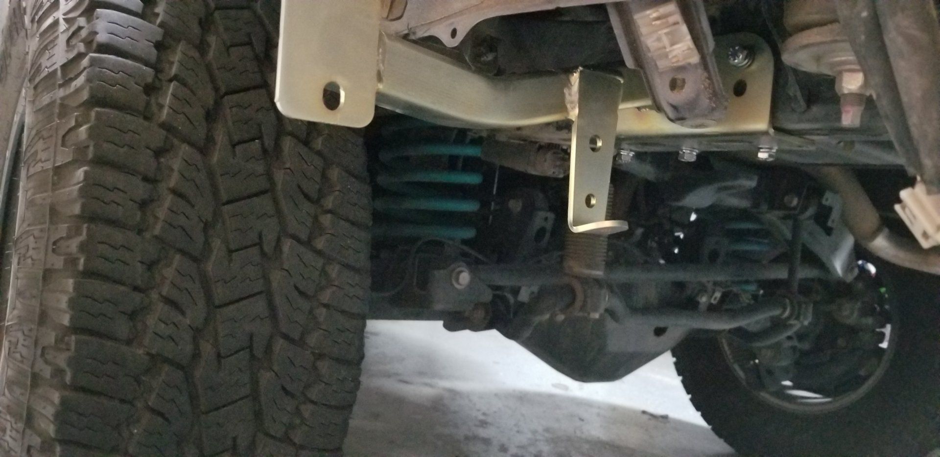

I have read on the Kaymer site about options for the bumper such as the wing supports. Are these supports not standard for the 3200 asking price? I am one that will use the bumper to its fullest potential.
If these are the wing supports you are referring to, then yes they are included.
