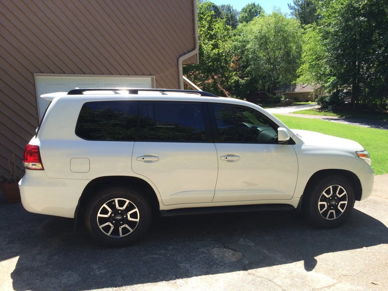

Can be done. Not my truck but I believe I found the photo in the forum.
They bolted right up, they were a set of take offs from. 2015 TRD Tundra, I believe they cost me $800 on Craig's list. The Michelin tires ride excellent.
