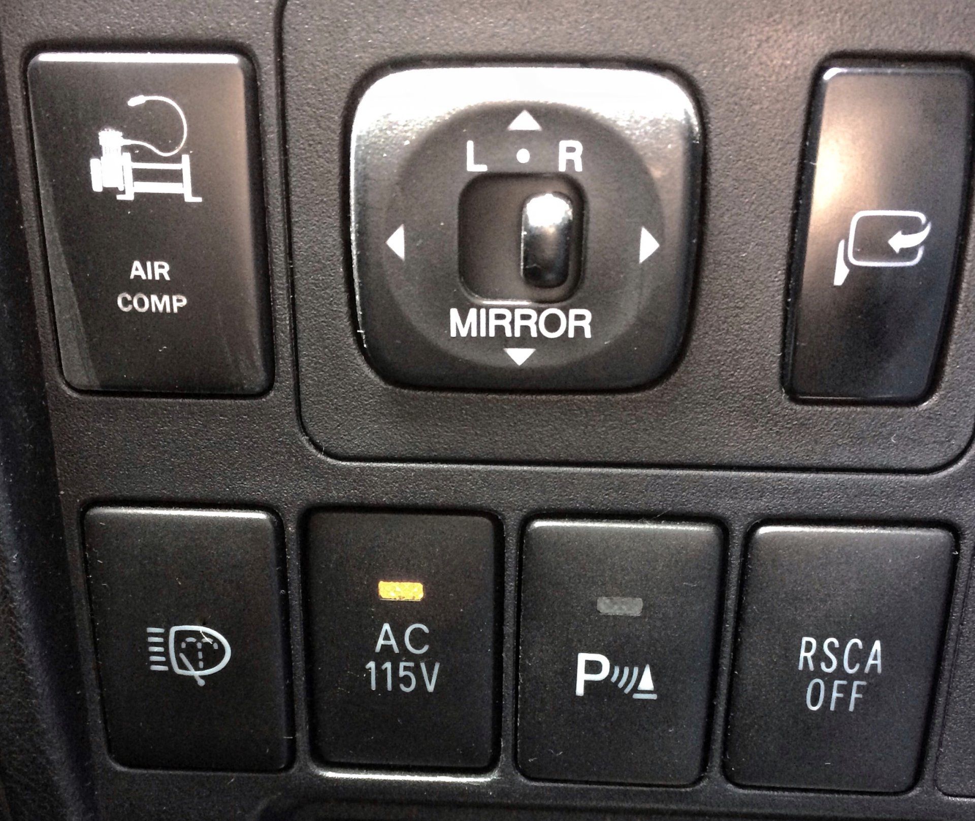

Next to my steering wheel. The headlight aiming and washers were swapped out for those AoB switches on the left:
Just saying there might be a way to toggle it in a menu if they stopped supplying a button.

For those who don't have it...it's this:
(Gotta take the opportunity to gloat, since it's rare an 08 has something newer 200’s don't...haha :hillbilly: On the other hand...y'all prob got some cool new feature that needed that button space. Oh well...;) )
Hard to tell - Toyota kept moving buttons around over the years.
2008-2009 Had the inverter button there.
2010- The button is blank.
2011,2013-2015 The traction (VSC) button is there.
2016-2017 The parking sensor button is there.
