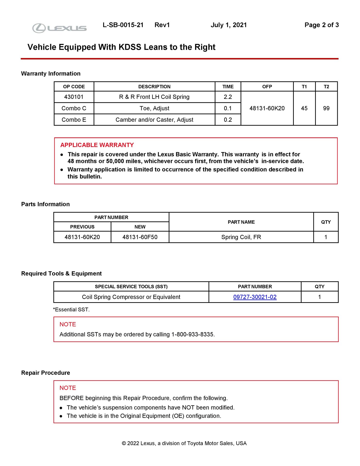

I had the dealer replaced the spring and that did not help in my situation. However, while trying to mount the bracket for my suspension lift, I had cut the KDSS hose. I had the system refilled and now it does not lean.
Just to be clear, you had the left front spring replaced per the bulletin and it didn't fix it?
Are you recommending a system fill or complete flush and refill?
I’ve got a 2013 GX that’s bone stock and is doing the lean. It’s only got 154k miles on it. We took it in to get the airbag TSB fixed and they never said anything about this TSB. Closest Lexus dealer to us in a 2 hour drive! No Toyota dealer around will touch a Lexus for some reason.
