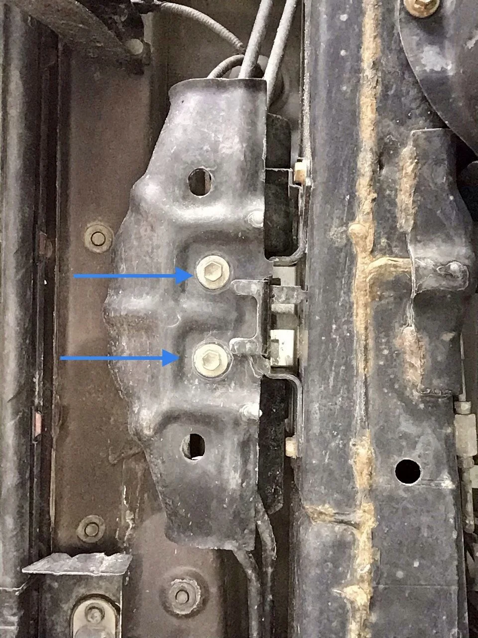

Hi There- newbie here. I have 2011 GX460 with the lean and the adjustment fix appears relatively straightforward. The one thing I’m confused about is when I look under to where the valve block is I see this metal shield With two bolts. Is it safe to remove the shield is anything attached to it that might cause problems. See pic.

You're fine, it's the skid cover for the KDSS unit, they are 12mm remove them, then use a marker, mark the two 10mm bolts and back them off a total of 3 turns

Got it! Thanks - I did the adjustment. I did some other research and the KDSS on my Lexus looks like the one on a four runner. It’s 2-2.5 turns of the bolt. Was able to raise the right front by 1 inch.
I attempted to fix my lean by doing what's in the Land Cruiser video. I live in Maine and the bolts were pretty corroded. Couldn't get one to close back all the way. Ended up blowing out my KDSS system after running down a dirt road. A connection popped off in the rear. Was $2,000 to fix at a Lexus dealer. My independent shop that's a giant business for Lex/Toyota wasn't able to do the repair. Luckily, insurance covered it. Beware! Just get those bolts tight!
