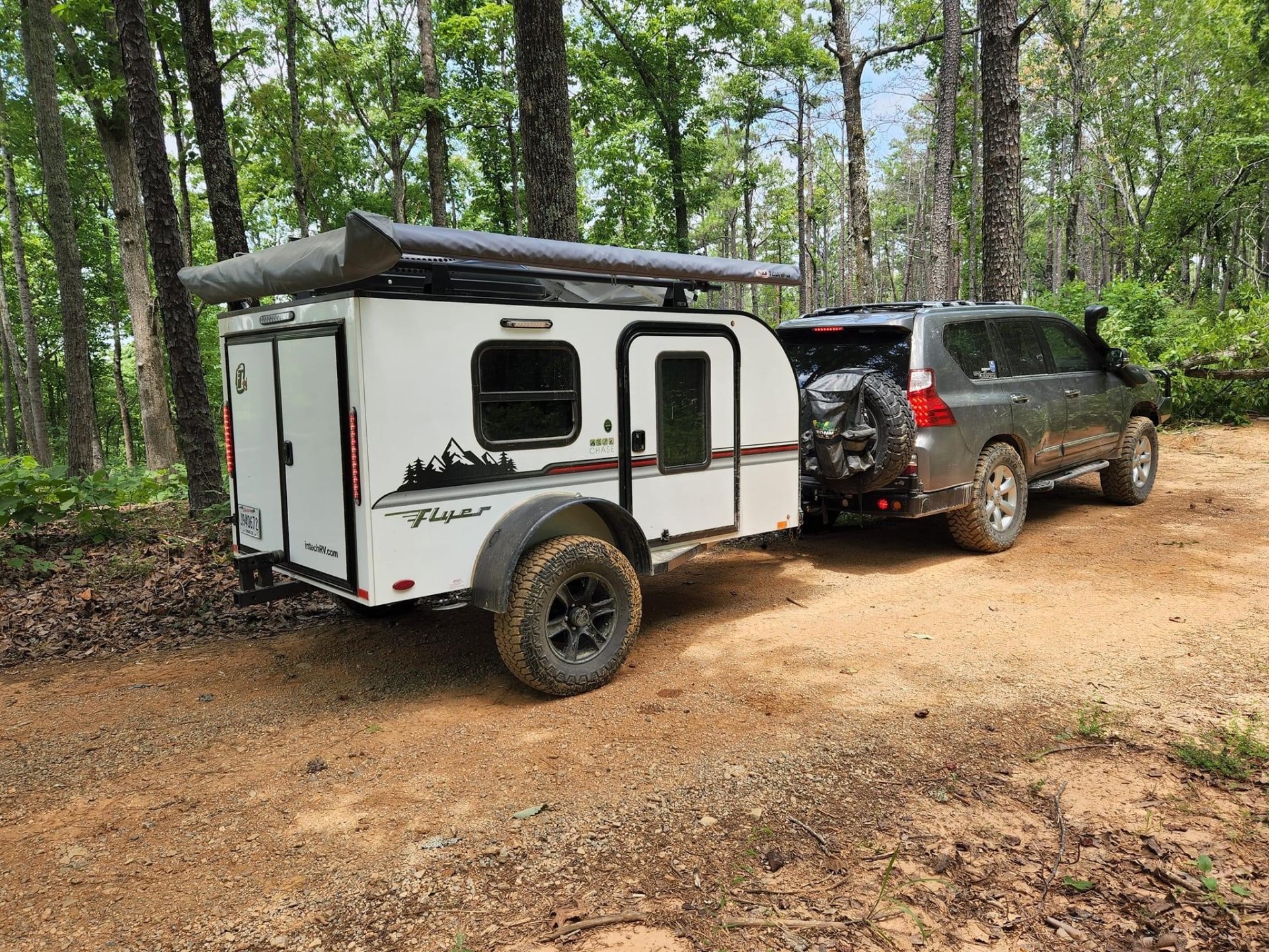

I pull my squaredrop camper (~1800lbs) for overlanding and have not seen the need for a t-cooler.
Ah yes, I've seen your trailer progression!
And yes, I won't be towing anything that heavy.

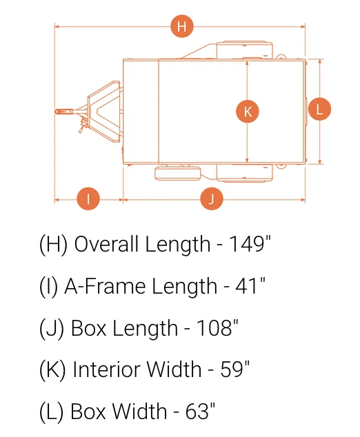

How long is that trailer to give me some perspective? I would love a cargo trailer that can do trails that is at least 6 ft long.
You will be fine with a 6' trailer........I would take it out a couple times and monitor temps. Guarantee, unless you're doing nothing but pulling hard inclines constantly you won't notice any increase. The only time I had any issue (and I wasn't pulling the trailer) I was in a trail I should have stayed out of and had to use the crawl control for an extended period of time. The dash beeped at me, gave me some warning and I shut it down for about 15 min. to cool. Continued on as normal after that.

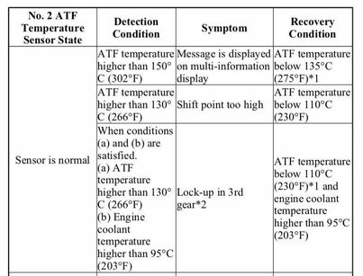

IMO..AT cooler is cheap insurance…will it prevent failure? nothing guaranteed but ATs are expensive. Cheap and easy to install…while I put in OEM ….3rd party setups are cheap. Also keep up on fluid maintenance. If one ever gets a warning about AT over temp on dash it means fluid has gone over 302 degrees
