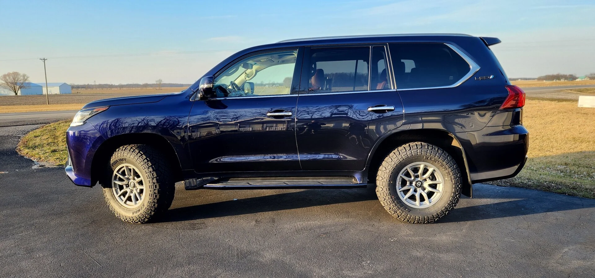

I own a 15lx and just bought a 2017 lx. The 2017 lx is super nice. I prefer the interior of the 2016+ lx. Both trucks are wonderful and capable out the box. I don’t care for the 21 stock rims. The 2017 has upgraded 2nd row screens with an hdmi input. The hood on the 2017 is harder to see over vs the 2015. I came from a 100 series and haven’t looked back.
