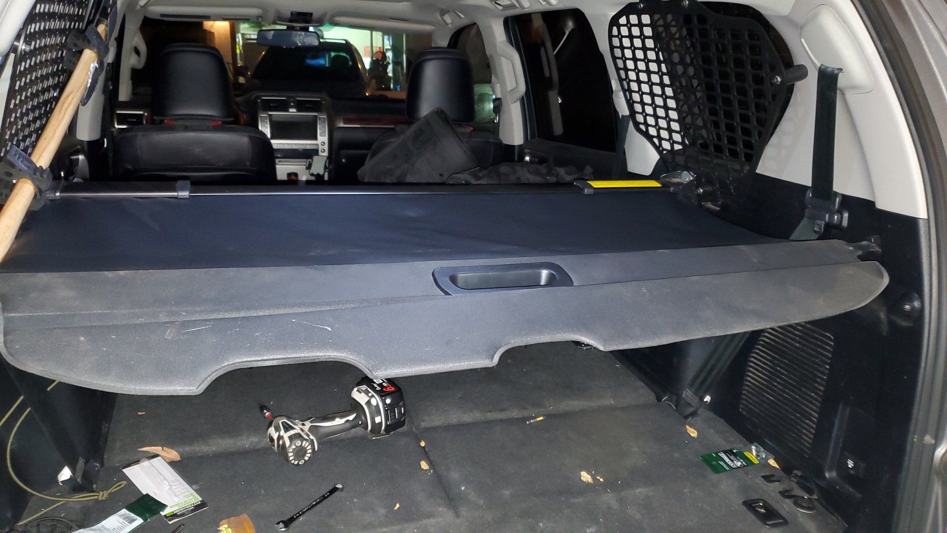

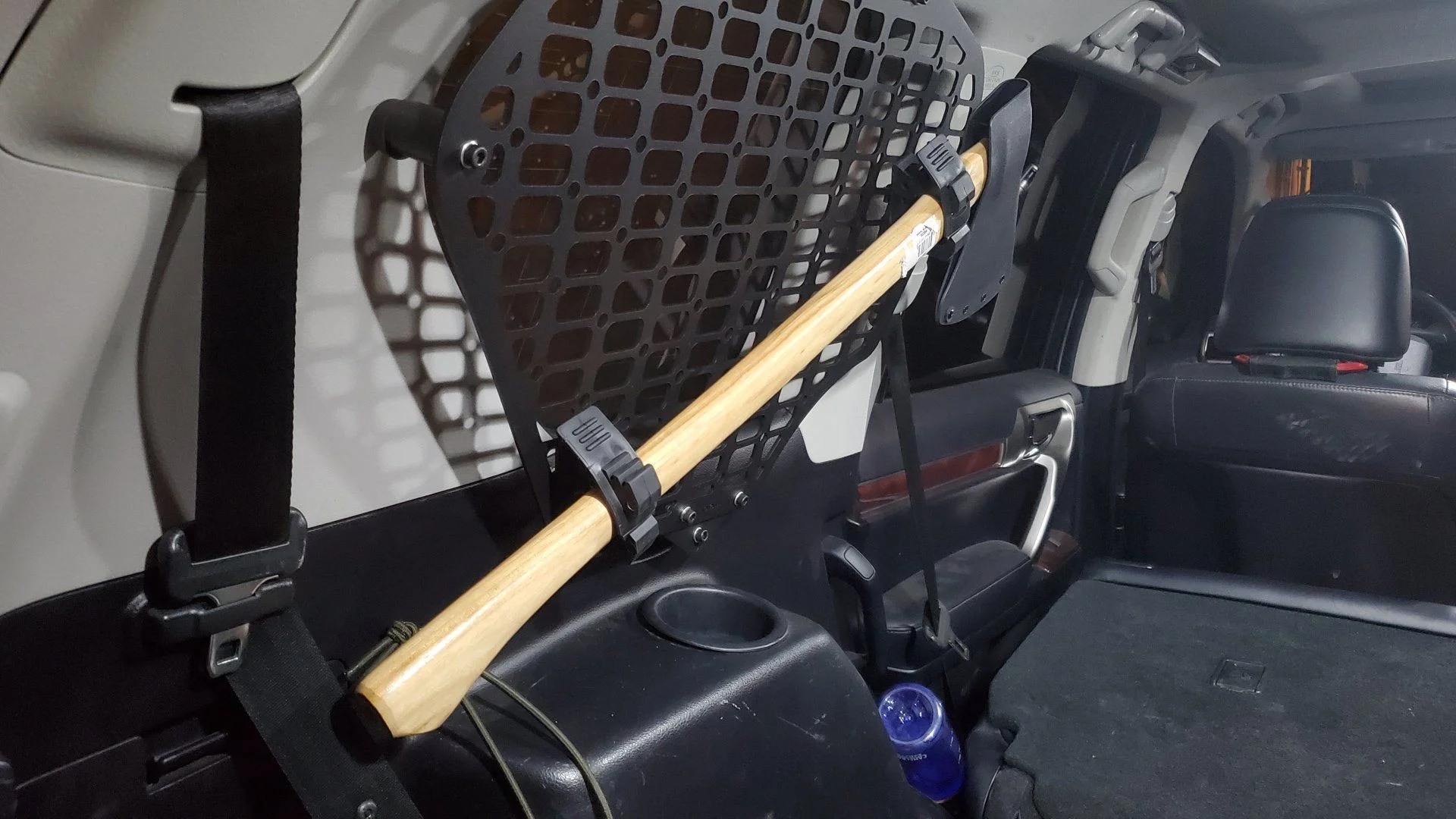

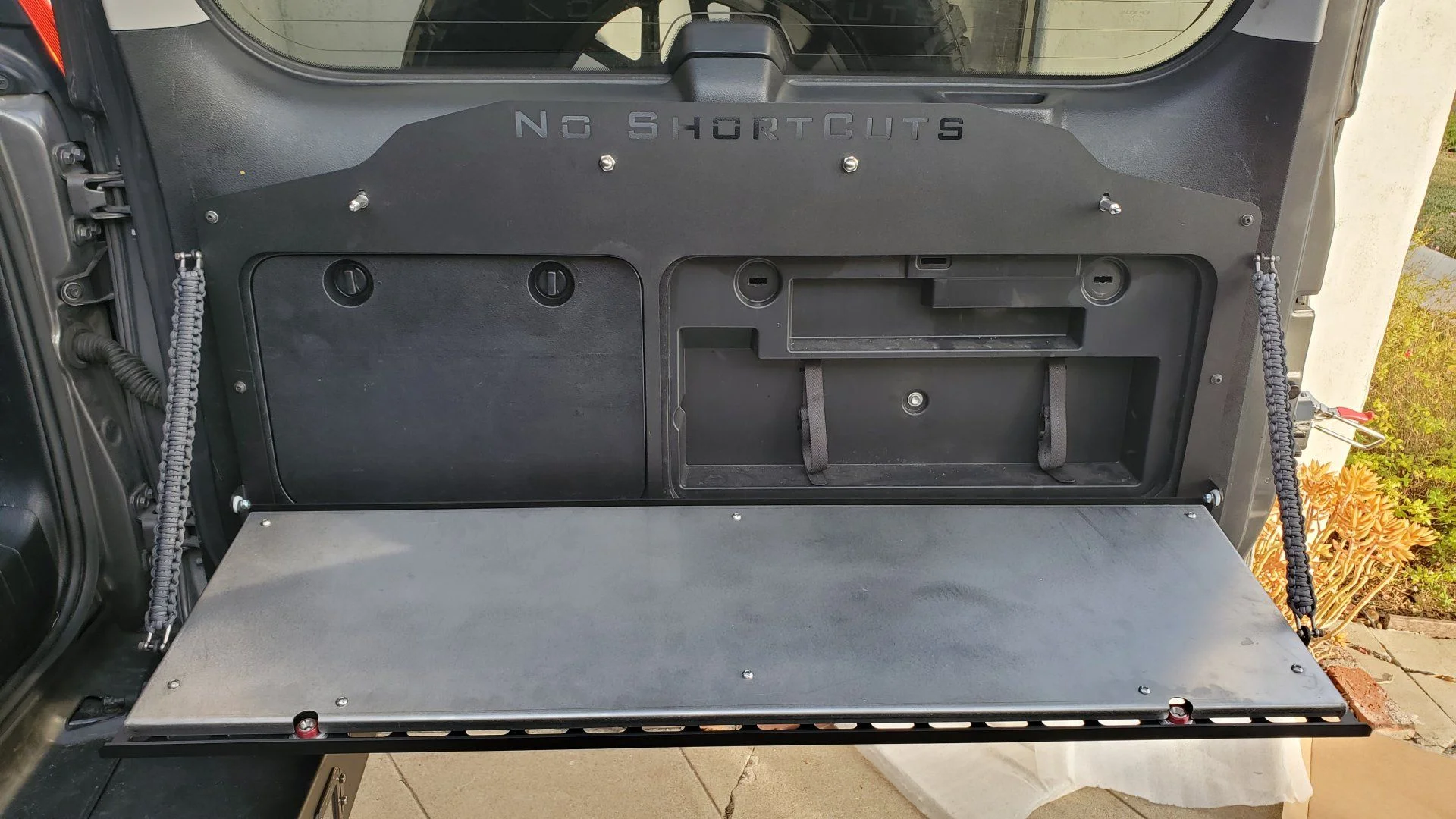

I installed some Orangeboxx Molle Panels and fashioned a bracket to be able to use the retractable cover. The prototype is going to made better soon.
I also installed Orangeboxx's tailgate table.
I love the rear table, I went with another make but I have found it to be extremely useful, especially for making quick meals or mixing drinks while at the ranch or when hunting.

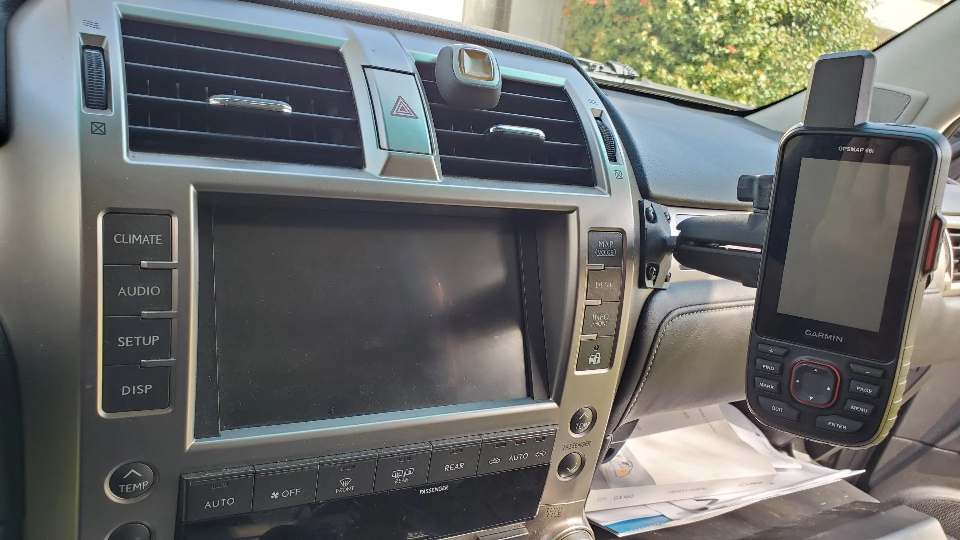

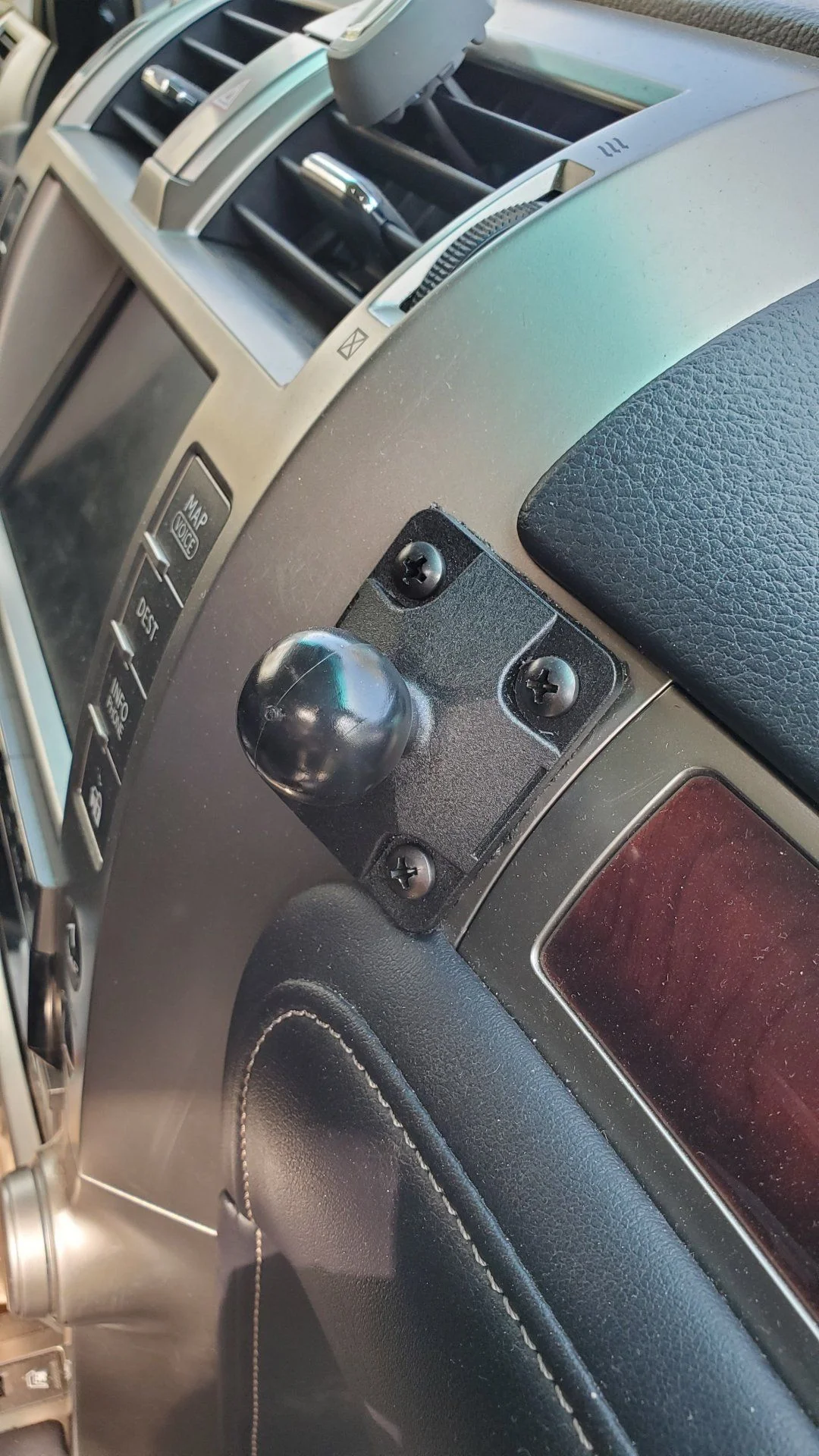

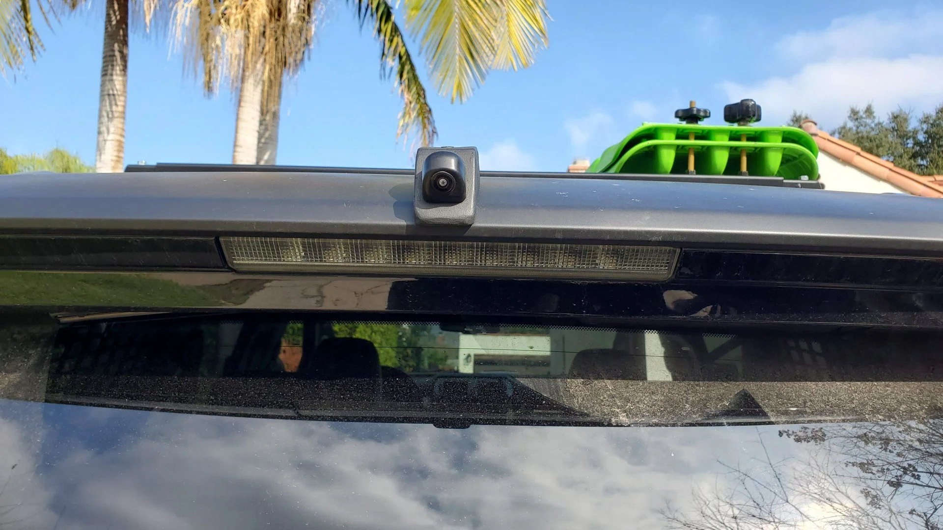

Added a few things to the rig's electronics, I added a mount for my gps, GROM's Vline, and moved the camera to the spoiler to get a better view when in reverse. With the Metaltech Lancer's spare tire mount being off center and in case I put a bag over the spare, the camera mount on the spare wasn't optimal for me. I will, however, be installing a second rear camera to replace the rearview mirror as the spare takes up too much of the rear window perspective.

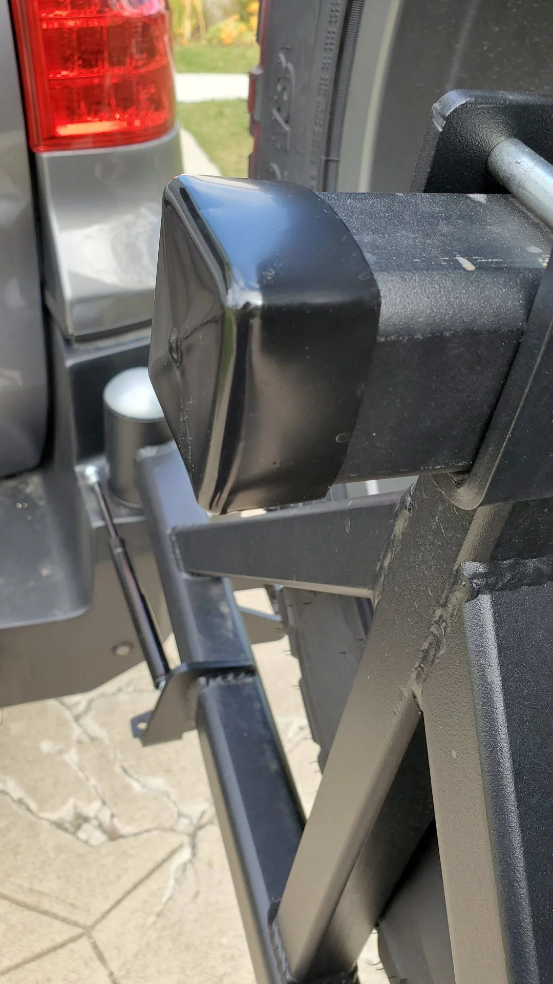

Added a rubber protector to the inside post of the Metal Tech Lancer bumper. I have found that when the swing arm can't be swung out to its full range of motion, the rear door can hit this beam. The rubber mount keeps the scratches at bay. I also have installed the LFD roof rack rails to the roof. I went with this rack over the more substantial racks because of cost and overall height. When my son takes this to college in the Fall he can remove them and store them easily when using it as a daily driver and getting into garages that have a 6' 4" clearance.

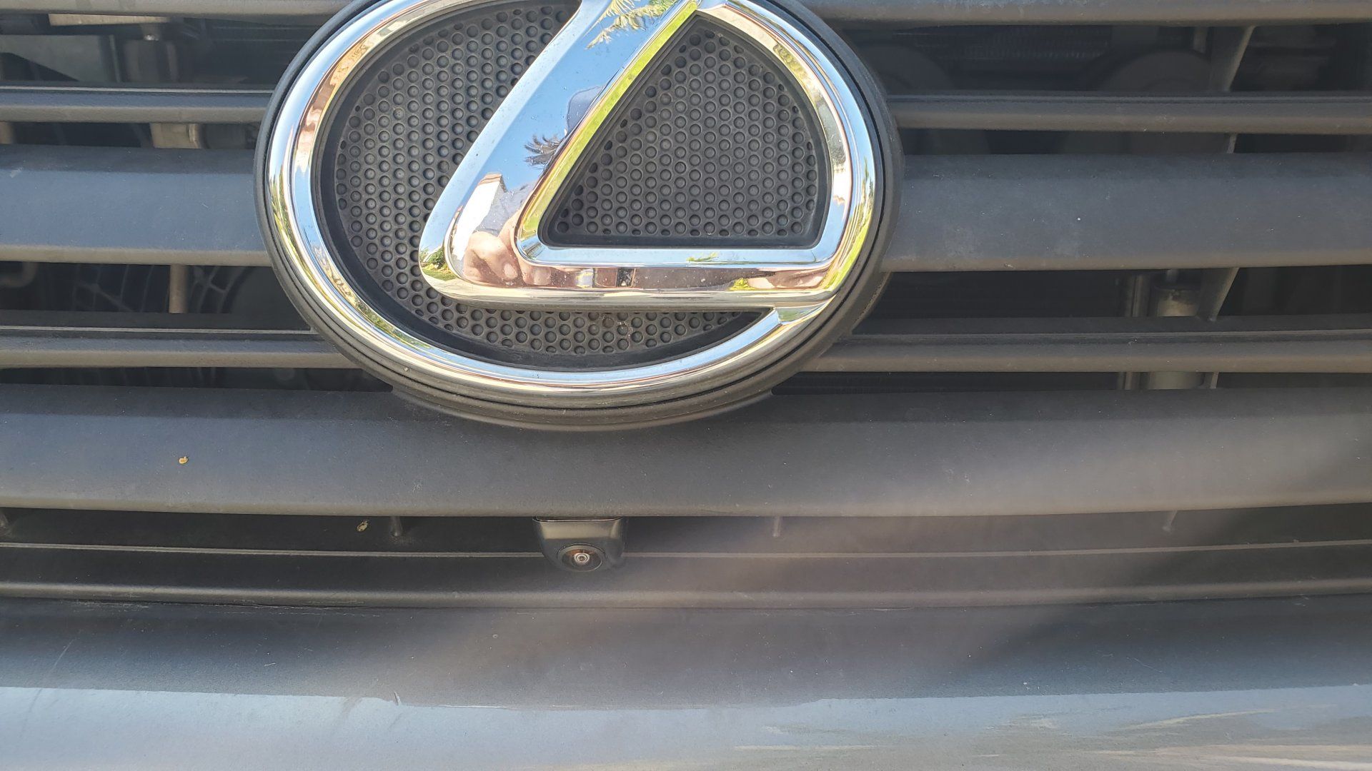

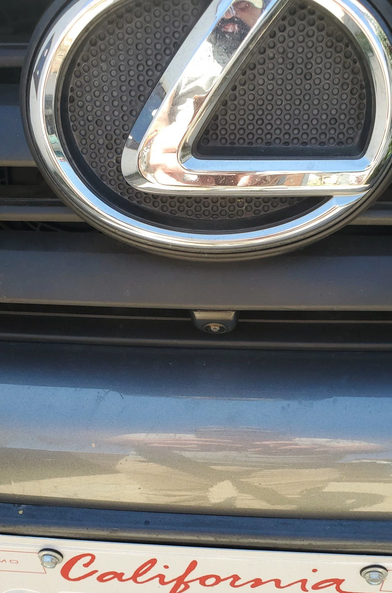

With the Vline addition, I added a front camera to rig. It really came handy when the terrain got steep and visibility over the hood wasn't great.

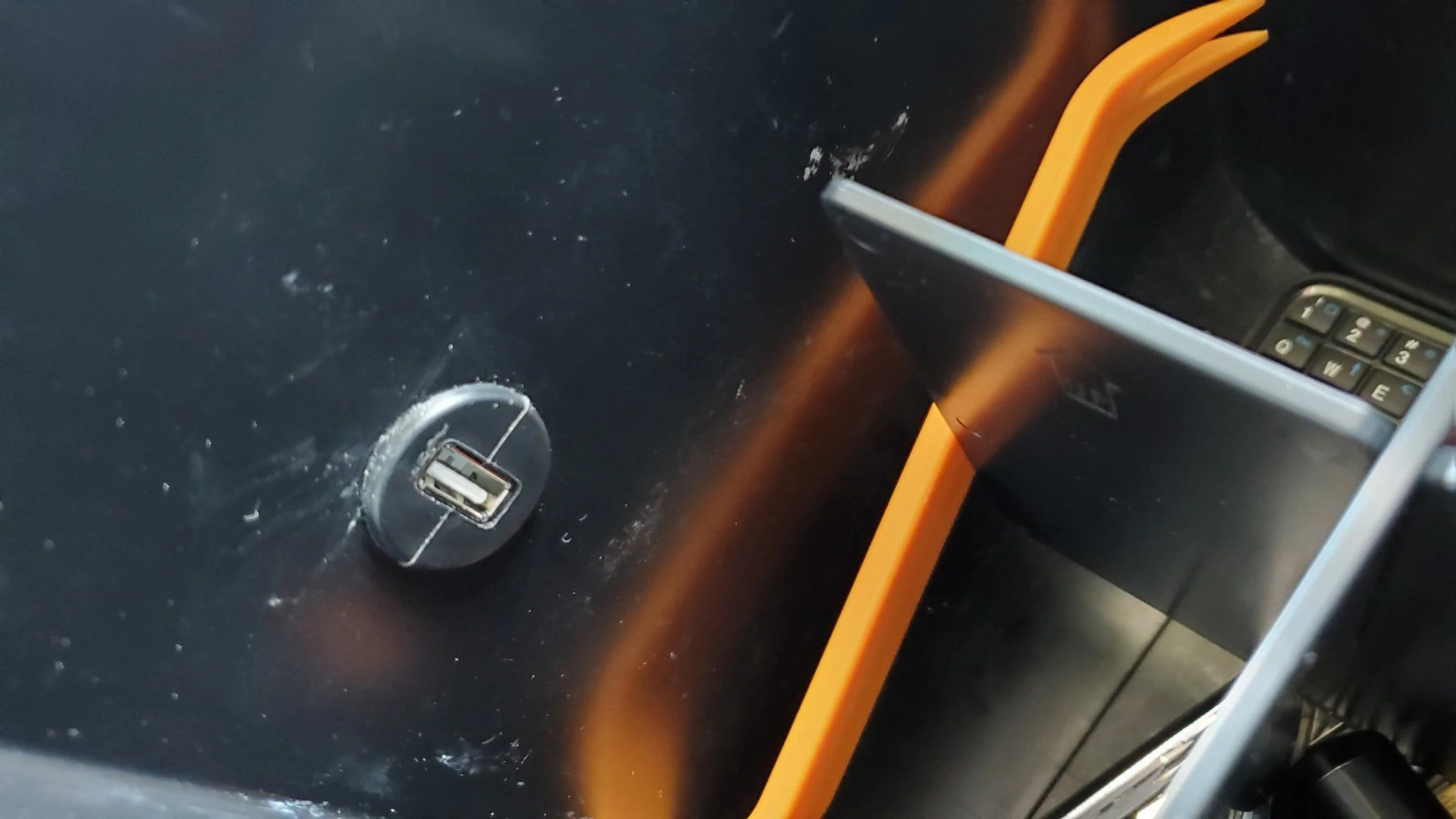

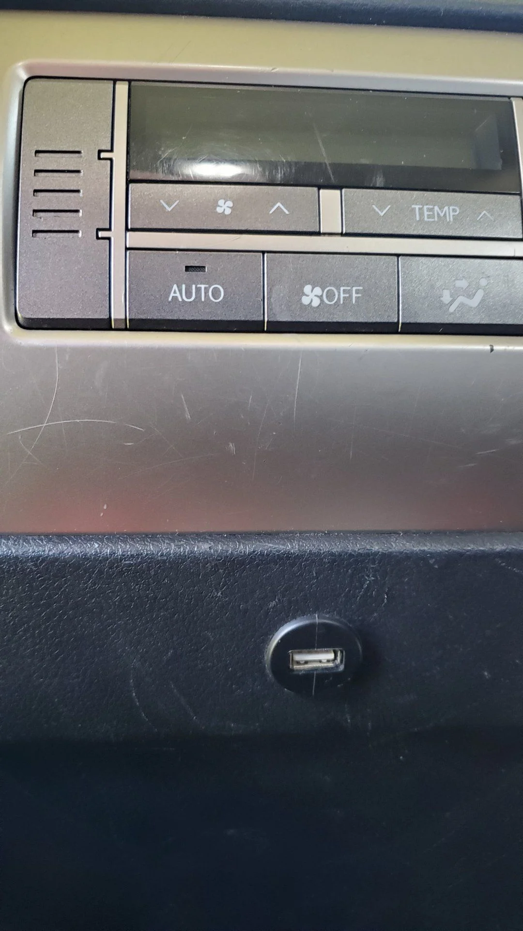

Since the Vline had me working on the electronics. I also added to charging USB ports. One inside the center console's armrest compartment and another at the back of the center console for the rear passenger to charge.

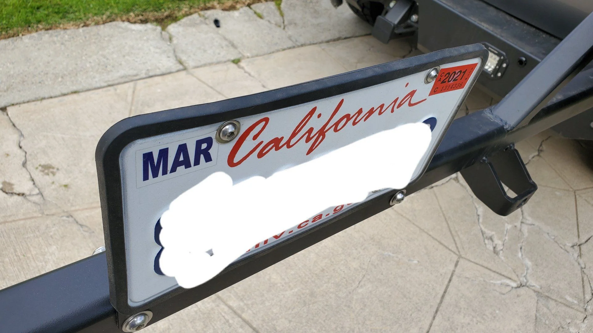

I also put a silicone license plate frame on the plate. It covers the sharp edges and keeps me from slicing my hand when closing the swing arm and not paying attention to where I grab.

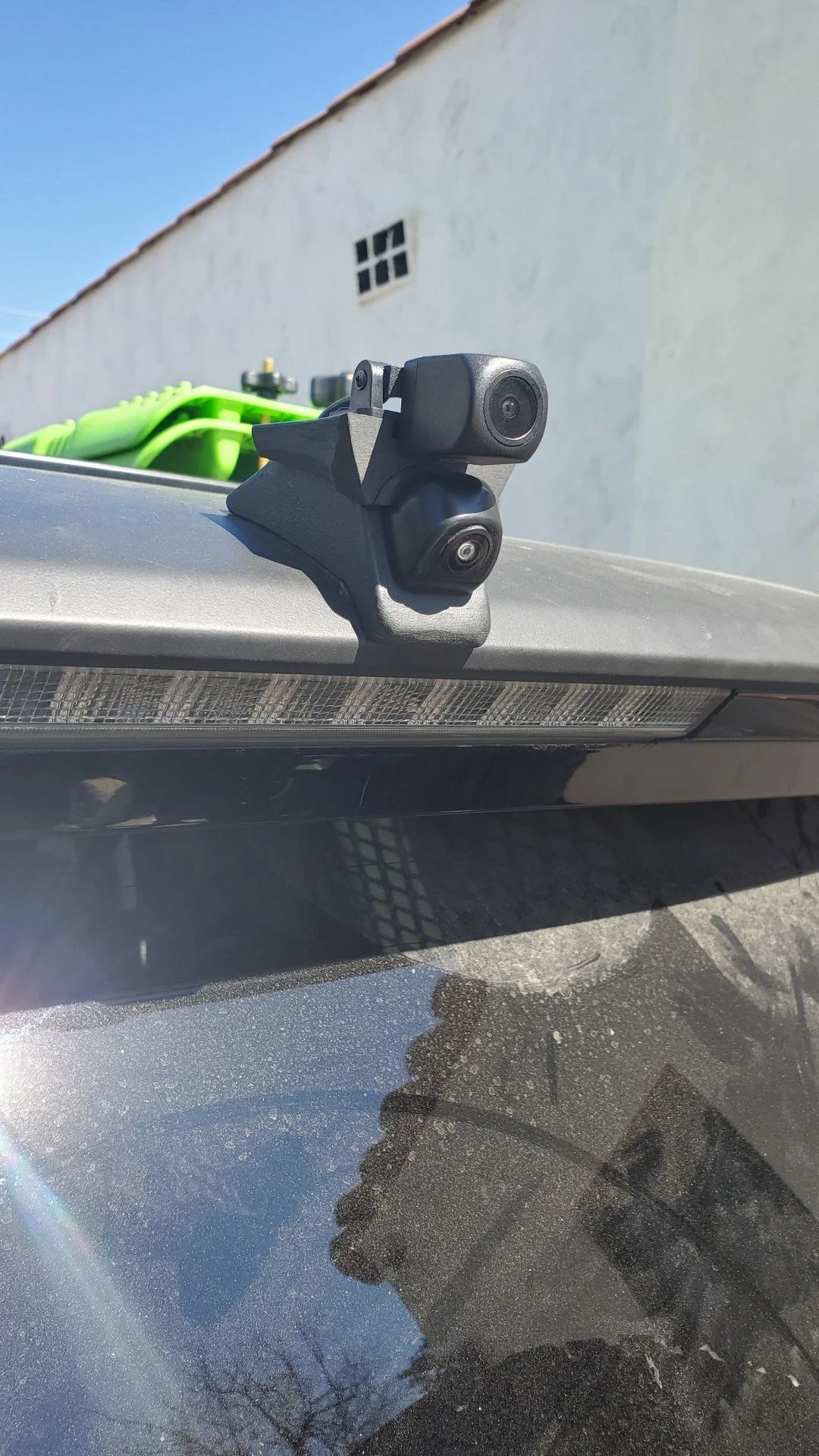

Went a little overboard with the cameras...the rig has four now.

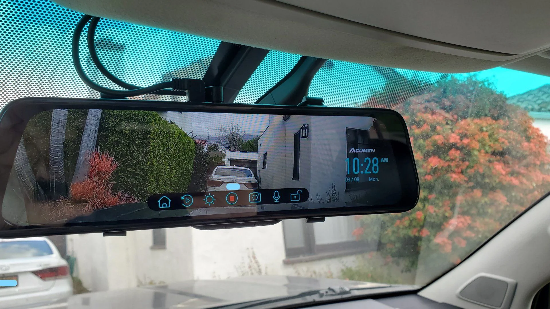

Two in the back- Bottom cam goes to the Vline and the top goes to the rear view mirror display
On the front - Lower cam goes to the Vline

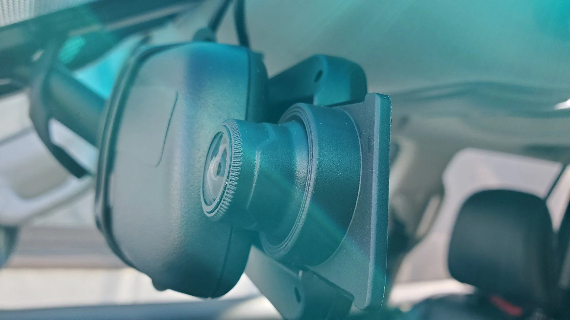

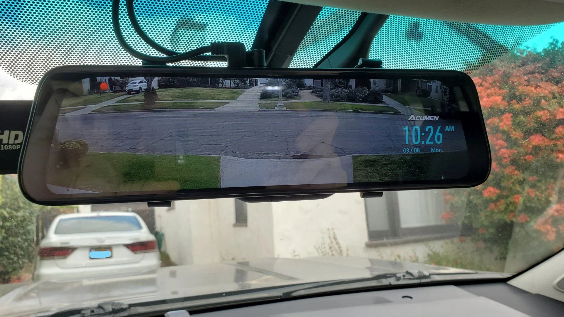

This camera is on the rear view mirror Dashcam

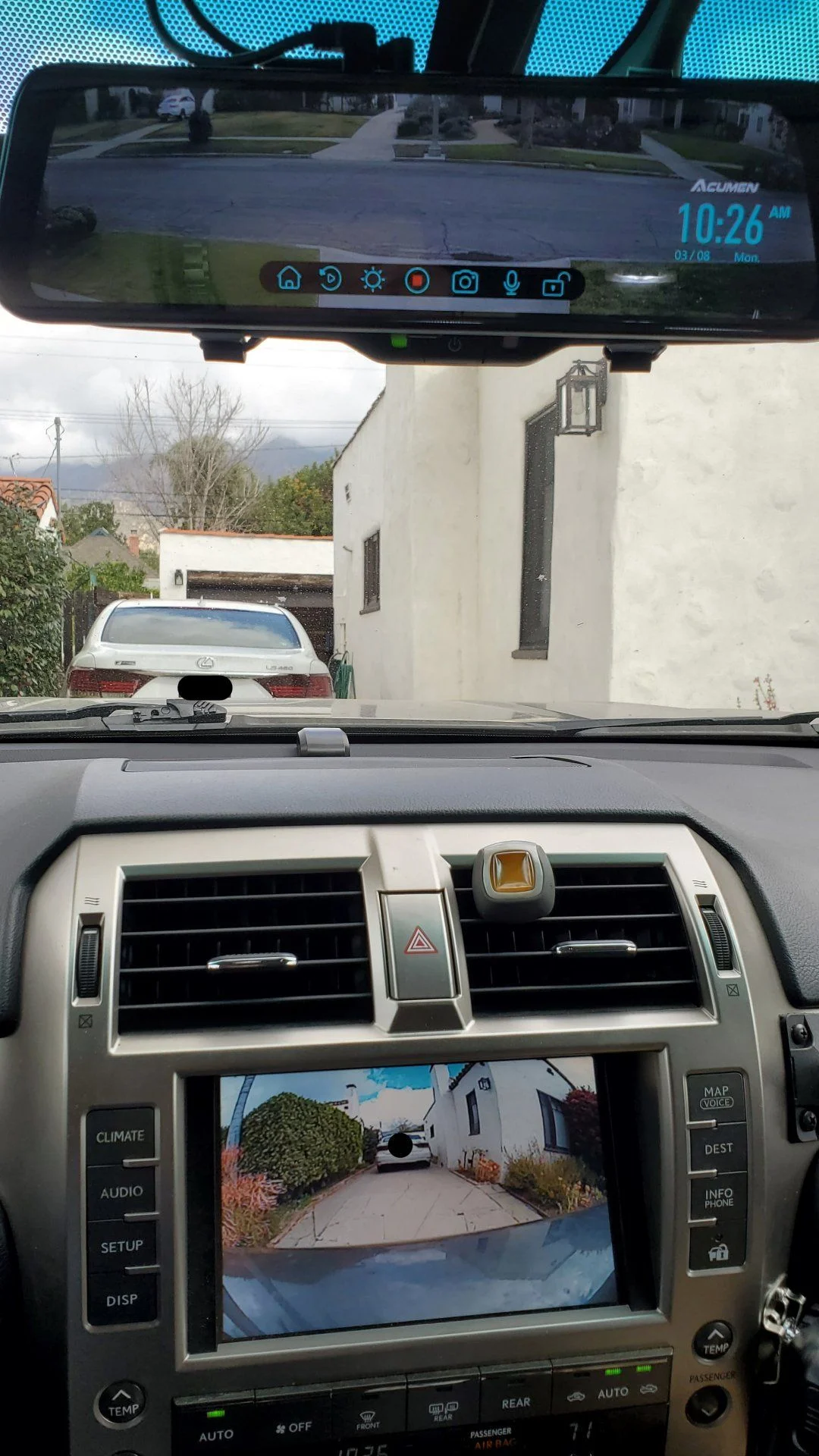

Top is the Acumen XR10 with looping mircoSD card recording feature seeing the back and the Vline front is on the in dash screen

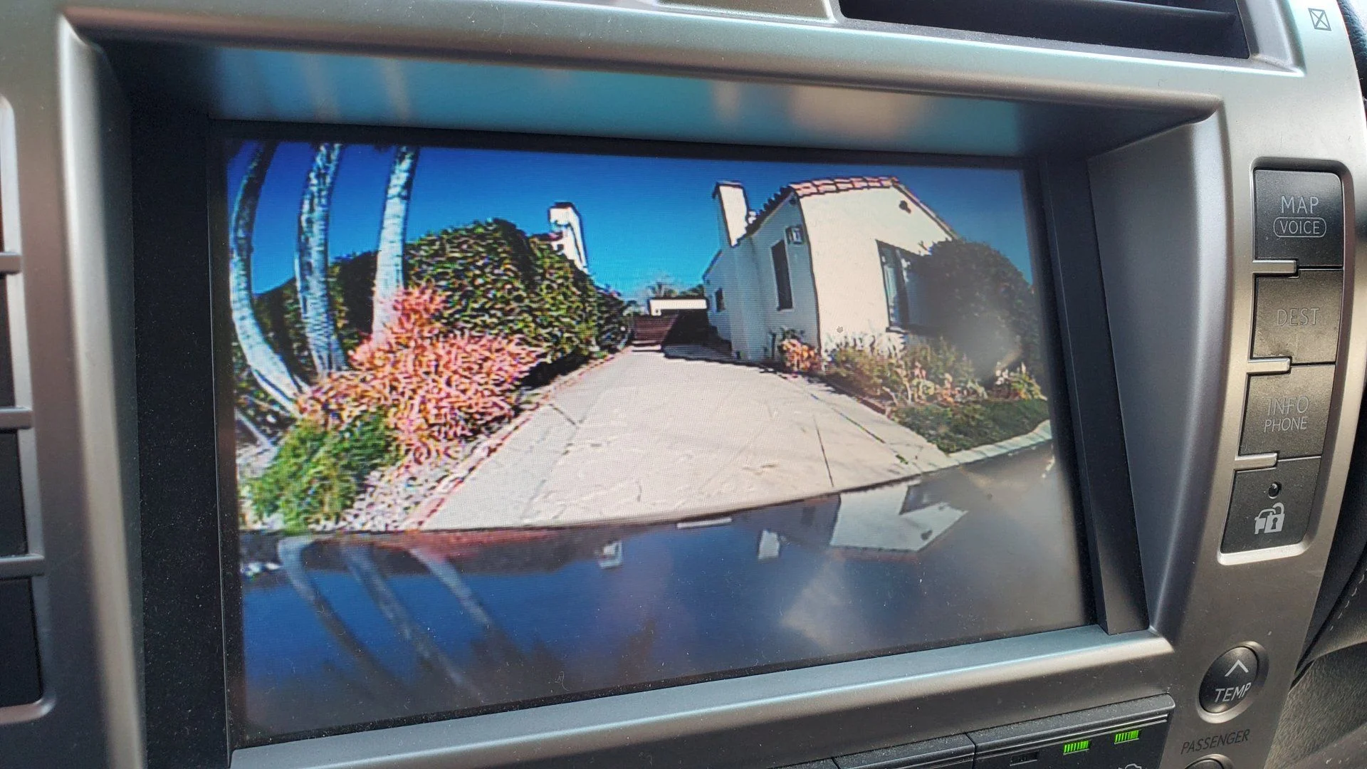

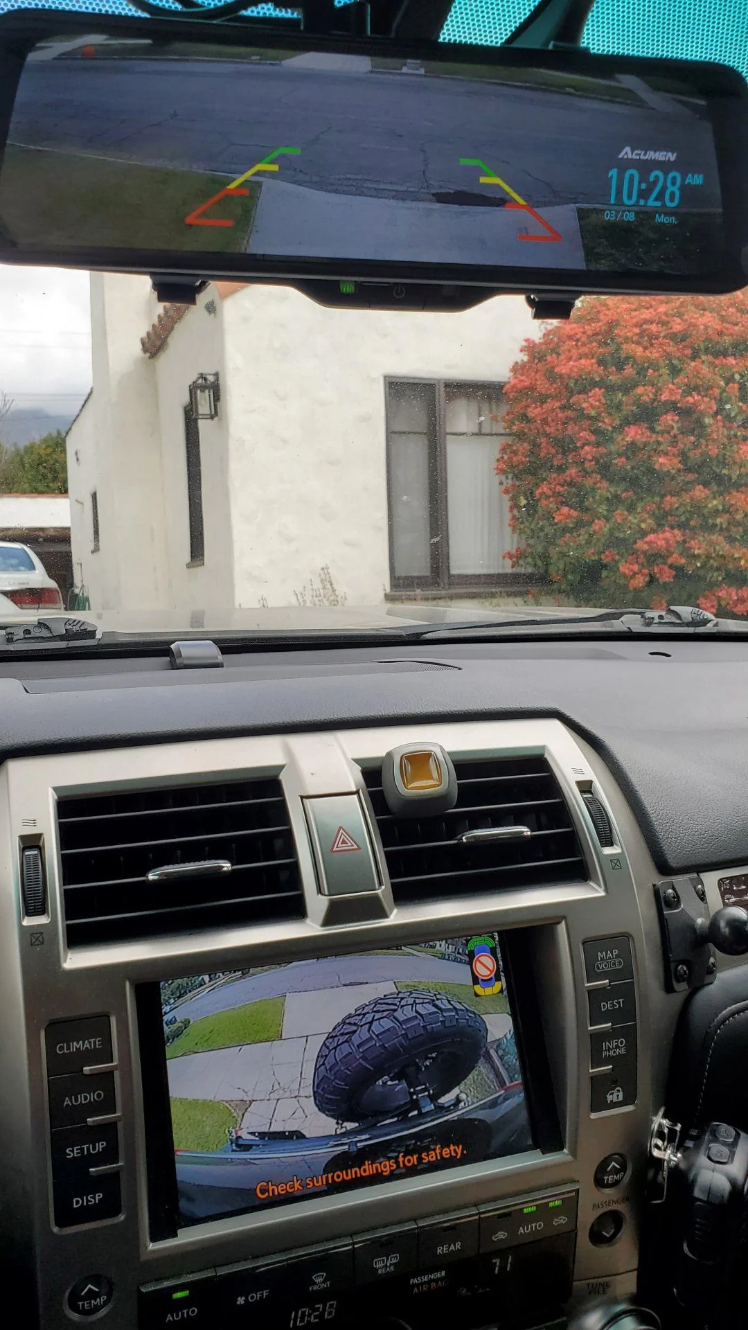

Rear view - can see without the rear tire blocking
Rear view when put in reverse
Front Dashcam in action
Both rear view and Vline engage in reverse with two different perspectives. Had to turn off the parking sensors as they pick up the rear tire carrier.

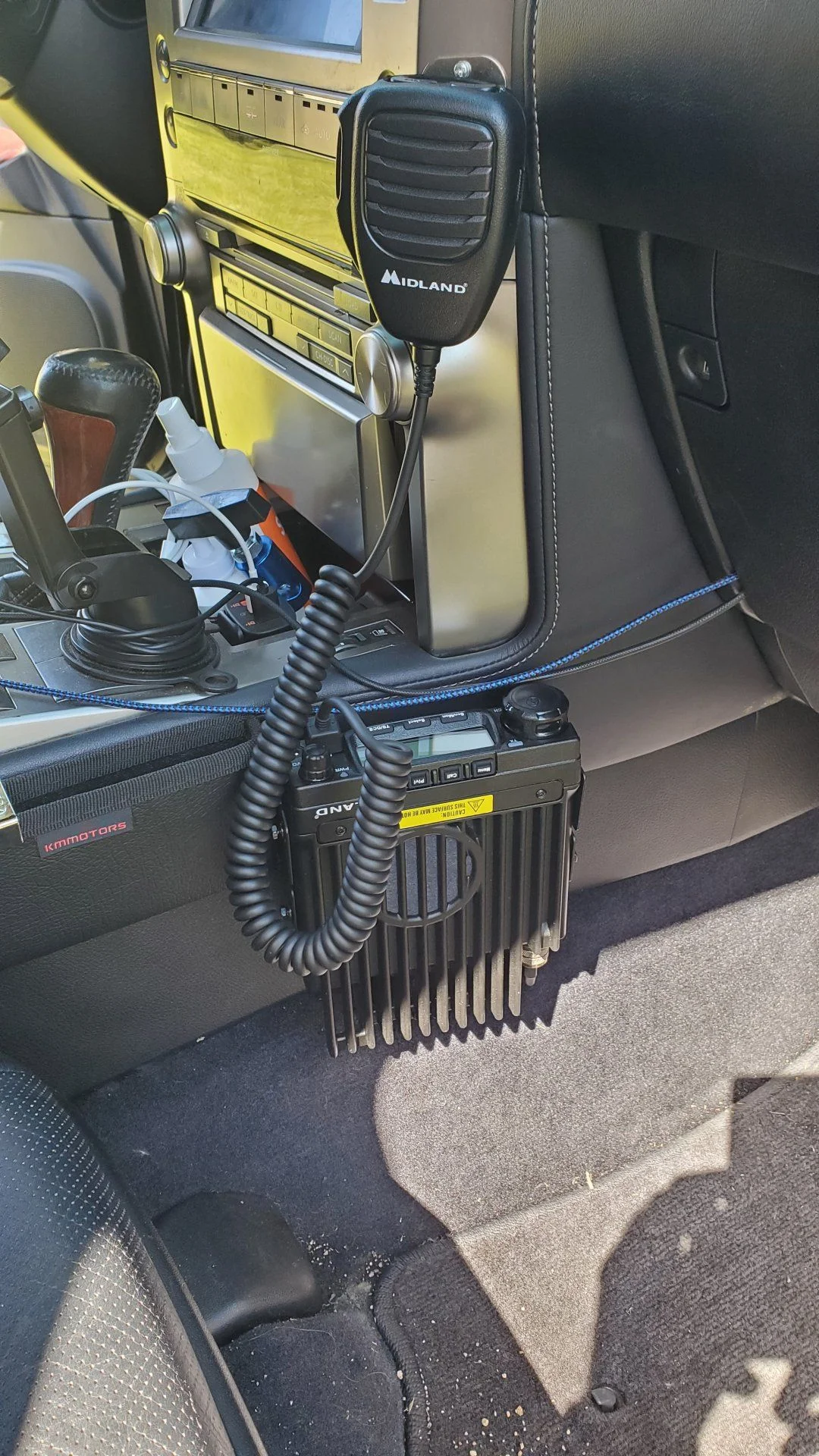

While I was adding the dashcam, I decide to add a Midland GMRS radio.

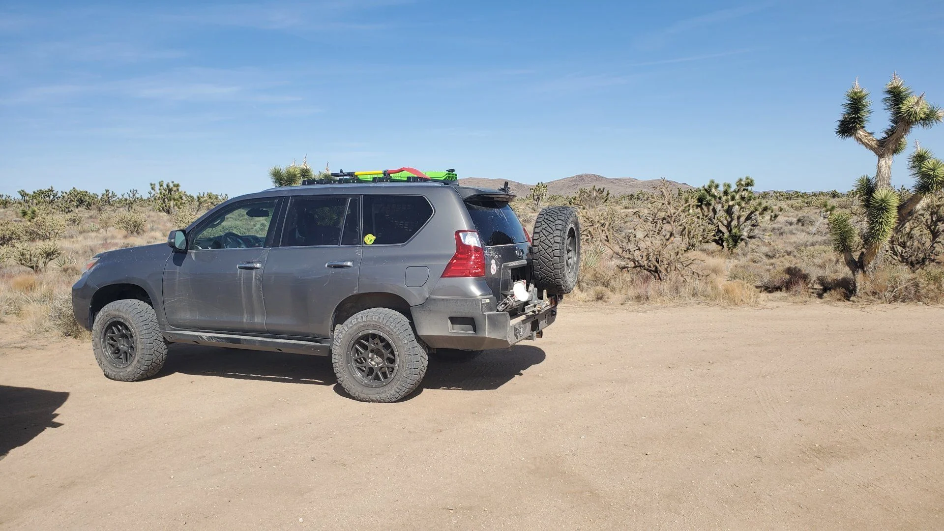

Need the constant load springs, bottomed out ten times in the rear. Sent out for new ones.
The rig handles great and can keep up with my Jeep buddies in most cases.
Impressed with:
The Ironman foamcell set up
The Metal Tech Lancer bumper
The ALL-TOP Heavy Duty Portable 12V Air Compressor Kit (only beat by my friend with a CO2 tank)
The Nitto Ridge Grappler tires

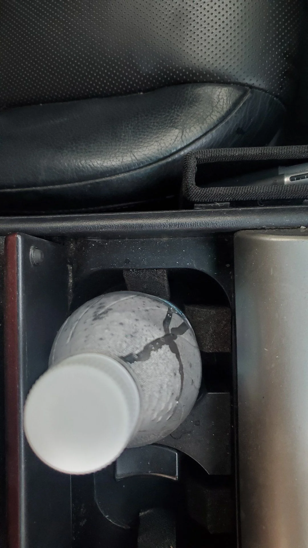

My cup holder hack worked really well for all the bumps. Didn't have a spill on the entire trip.
The FCP's perform better the faster you go in my experience.

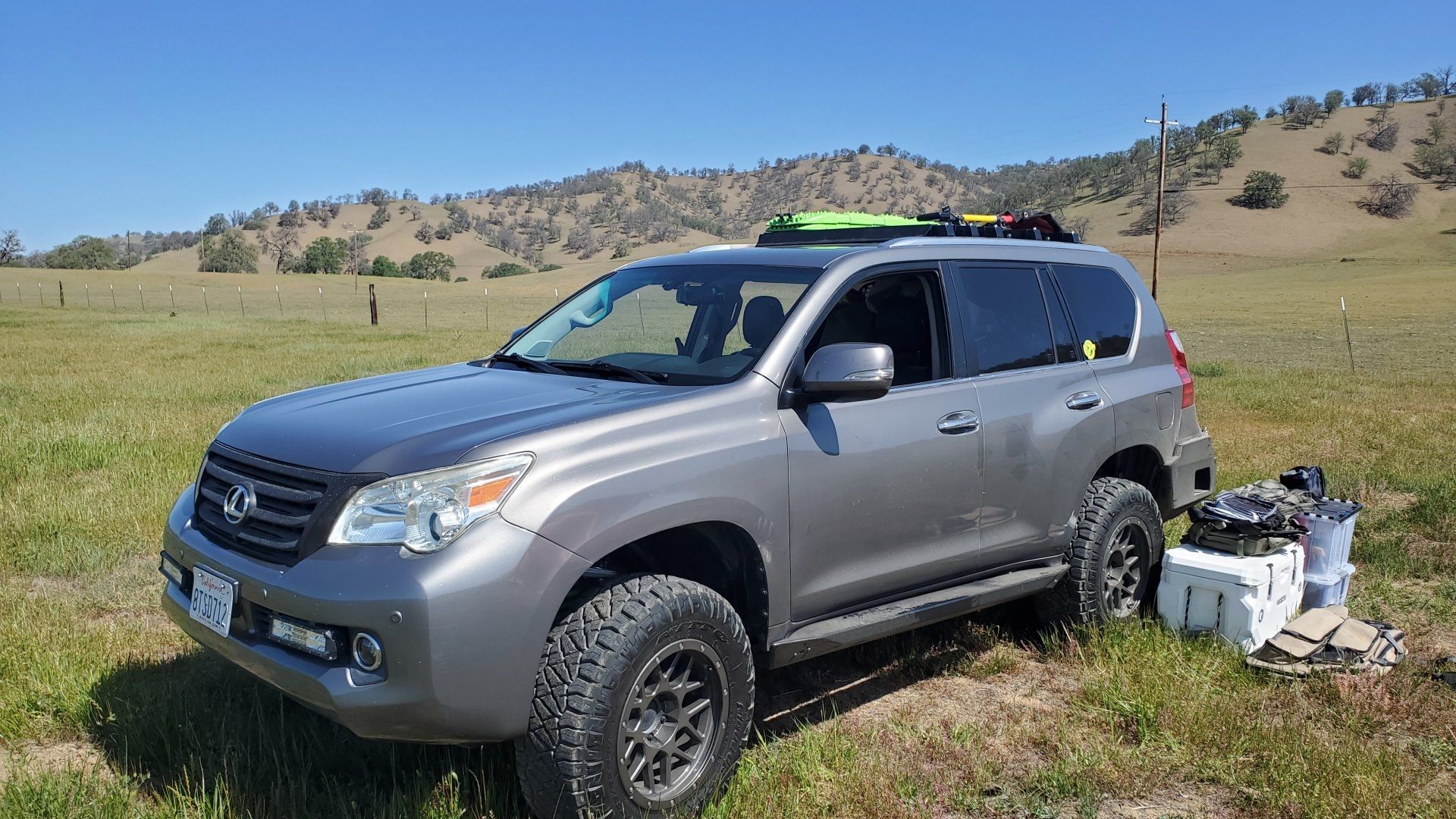

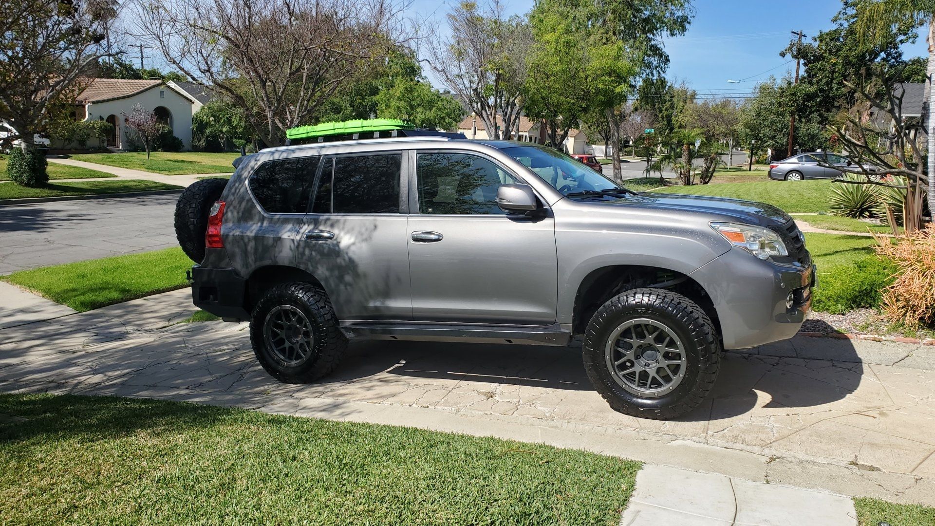

Cleaned up the rig before the trip to Napa.

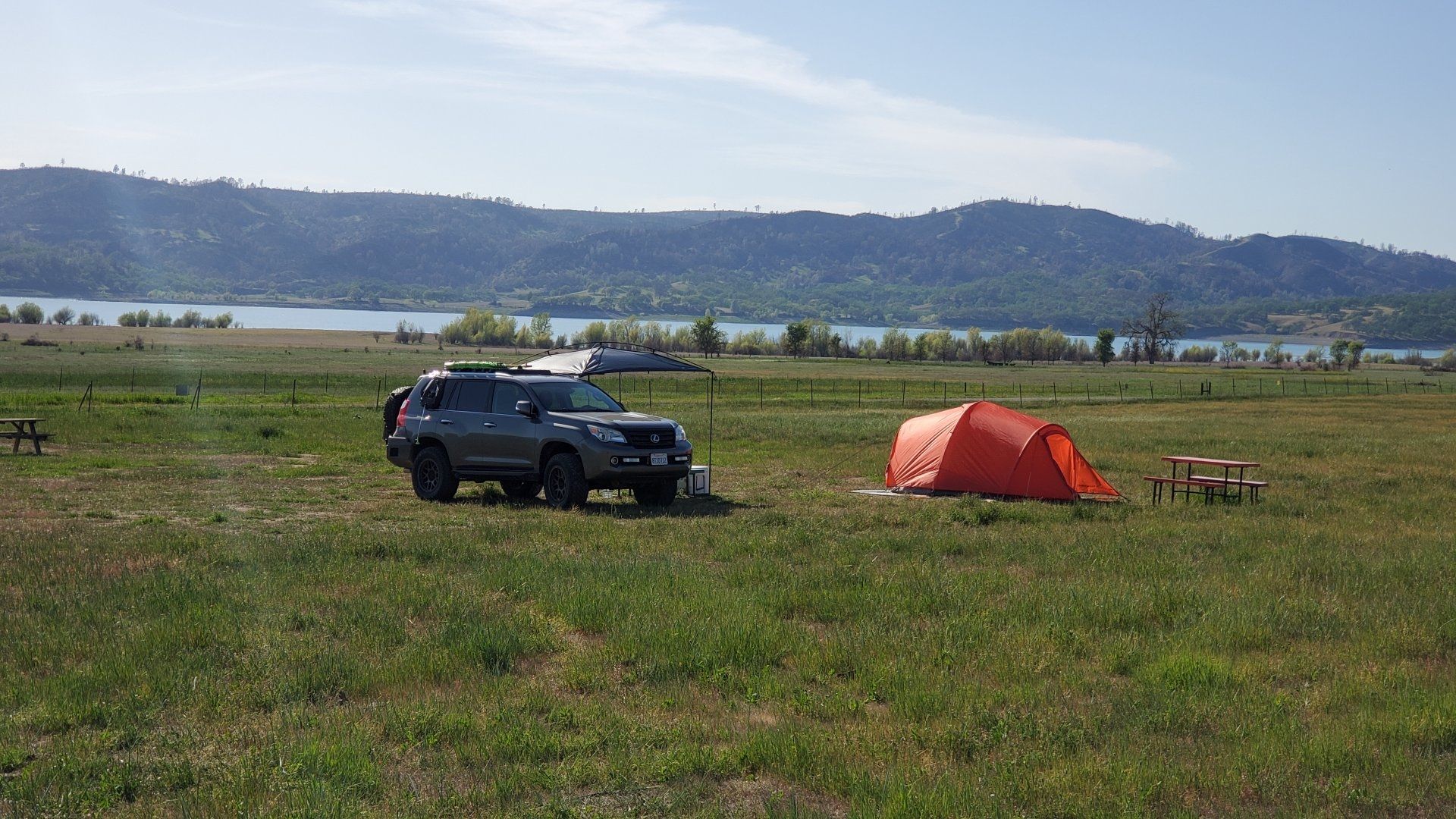

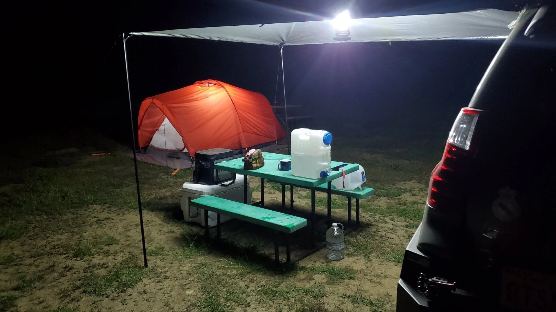

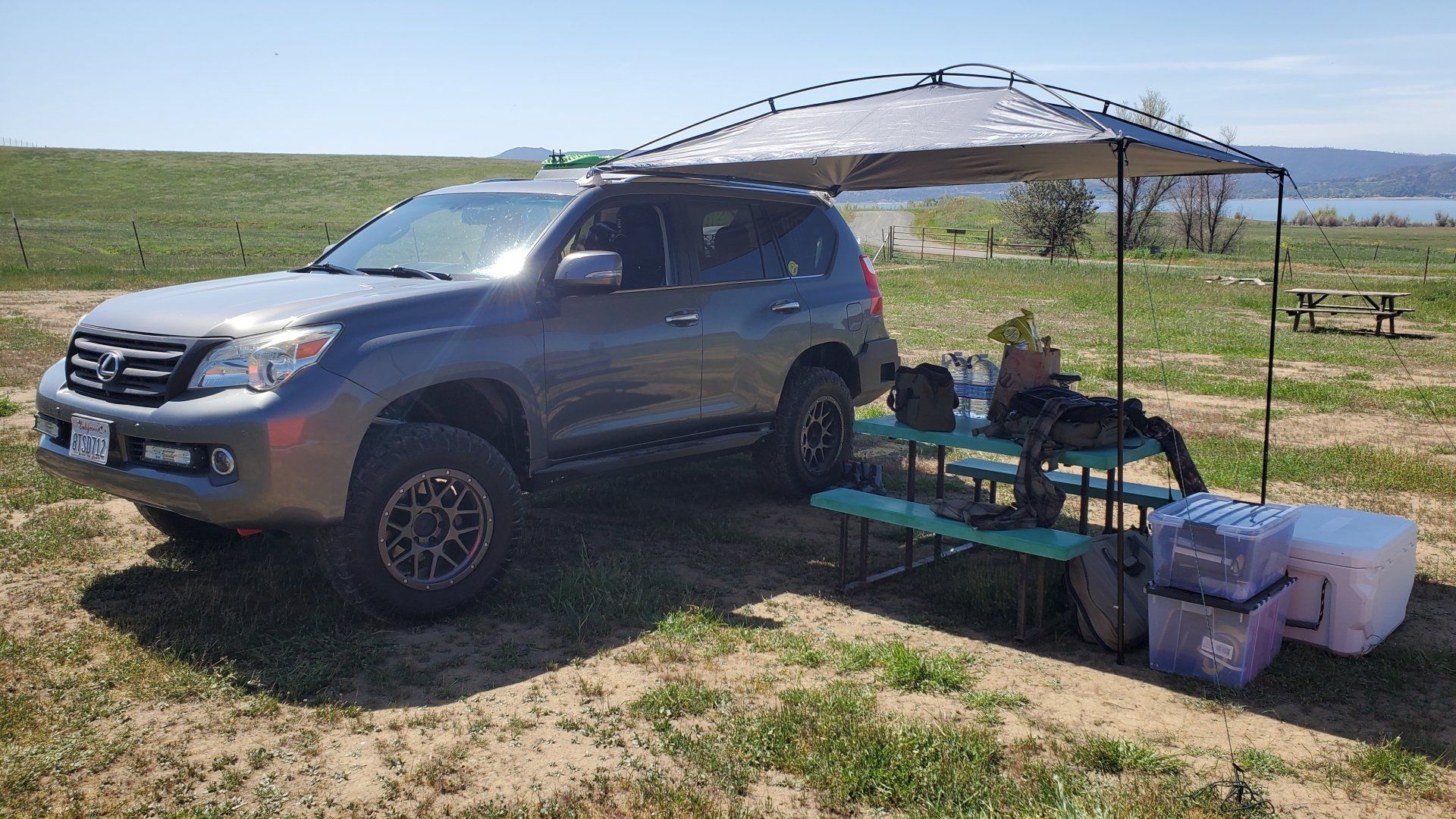

Finally was able to setup the Moon Shade awning and was very happy with its performance and versatility.
