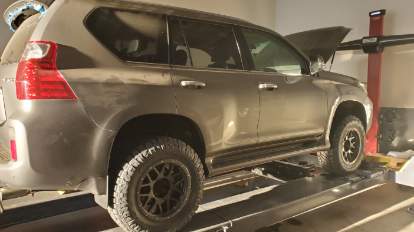

Got my wheel and tires mounted. Suspension lift to be installed in a few days.

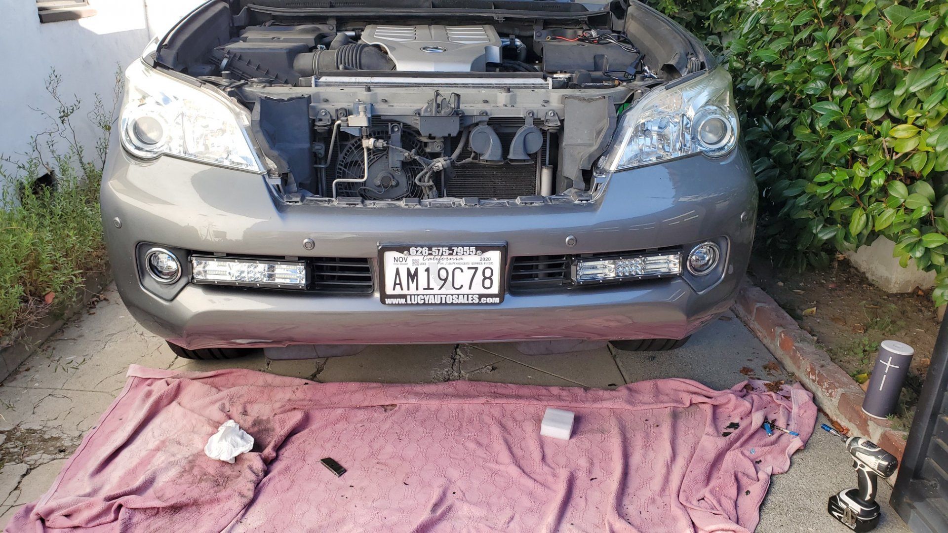

Installed Led in the projectors. Had to do some grinding on the fan's housing in order to fit. Couldn't get the HID kit to work with the DRL. Had the relay harness and the anti-flickering kit, but only could get the high beams to work. Switching to LEDs for the high beam/DRL.

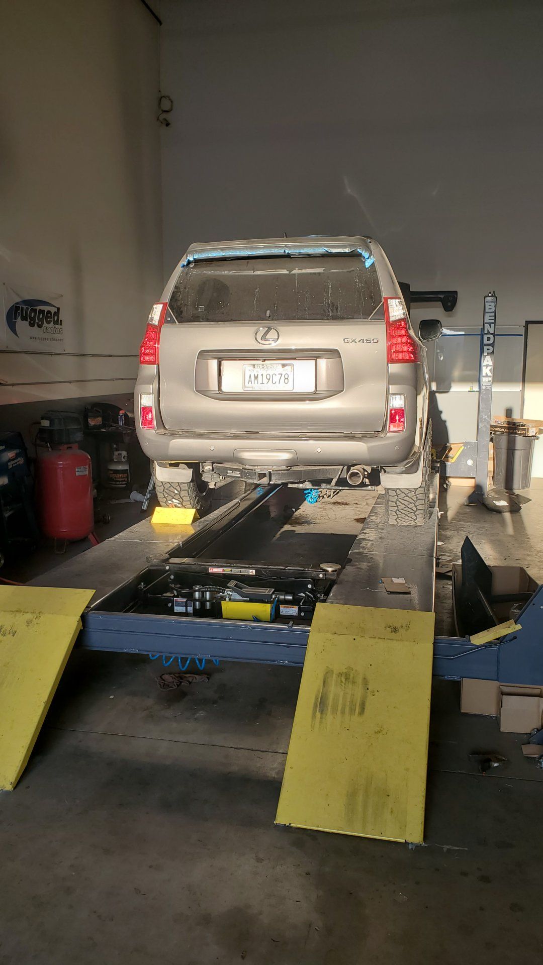

The shop that is doing the lift had some Victory Rock Sliders that they had miss ordered. They gave me a sweet deal, so that is getting added on before I had planned.
The blue tape on the fairing is because I plastic dipped it as the clear coat was gone. Hadn't had time to peel it off before taking it to the shop. Probably going to do the door handles too as the plastic chrome is cracked.

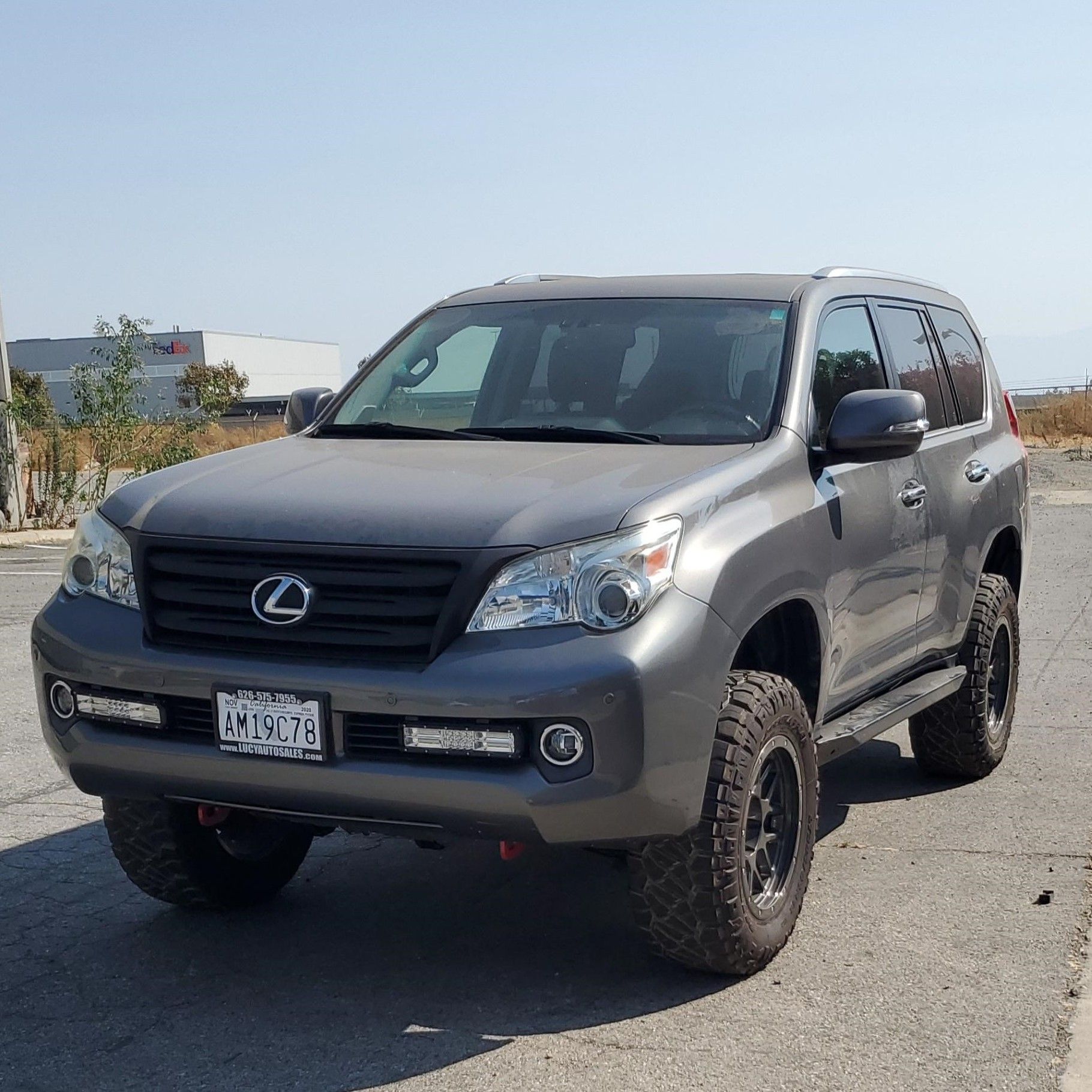

Things are little dusty, but the build is coming along. The lights have been installed and so have the Victory rock sliders. The lift is pretty nice and looking forward to testing it out next weekend.

Your rig is coming along! Cool/unique and integrated light set up in the front, and the sliders/tires have really transformed it.
I am not familiar with the Expedition One bumpers, but I have Metal Tech bumpers (2014+) front and back and love them. Crazy solid build with decent wraparound protection. The rear swing out tire carrier is built well and the jack mount and side steps add convenience. They were not inexpensive, but seem worth it. They do have specials occasionally and I would imagine would have some around the holidays. Otherwise, if you're not in a rush (difficult not to be when upgrading, ha!), it may be worth waiting and looking at the different options coming out and do the best apples to apples comparison that you can based on the information available.

Cool! You and I have very similar lighting goals. I've got some questions for you about that!
Why did you go with the DD Luxeon fogs over Fog Light LEDs for 2010-2013 Lexus GX460 (pair) or Fog Light HID Conversion Kit for 2010-2016 Lexus GX460 Did you ever consider going yellow/amber?
And really interesting mount of the light bars. I've had a handful pulled up that I've been deciding between. I've been looking at putting a pair of 11" bars in that same location- except mounted behind the plastic grills. Did you ever consider that, and did you mount directly into your bumper? I'm thinking about making those bars white flood, and going amber in the fogs. Which bars did you go with?
I used these LEDs for high beams. No drl flicker, pretty bright: Amazon product ASIN B07T1LCZB7
I went with the DD Luxeon fog lights because I really liked their pattern. I did have to reverse the polarity to get them to work, but have been really impressed with their pattern and how it compliments the projector beam's pattern. The only nit has been the color temp doesn't match exactly, but I really can't complain.
I installed LED lights for both the projector low beams and the reflector DRL/high beams with the anti-flicker. They are working really well. Will post pictures of the pattern and output soon.
I mounted the light bars directly to the bumper. I added some reinforcement with additional plastic strips and washers to minimize stress risers. The only thing is that adjusting the angle of the bars has been a bit of a pain, since I have to remove the bumper and unscrew the bars to access the adjustment screws. I also decided to cut out the screen instead of mounting behind for a few reasons. First, the part of the screen I cut out was the solid piece and thus I am blocking a portion of the original airflow and not all of it as when mounting behind. Second, the mounting area when I cut the screen seems to be more robust and decreased the leverage point the mounting bolt might have from the vertical potion of the bumper. I hope this offers less movement and a more secure hold. Lastly, I like the look of the light bar in the location and didn't feel the need to hide them.
As far as the bars, I went with these: Amazon product ASIN B07VHPJN4D
I found their flood/spot configuration interesting. They are inexpensive enough that if I have to change them in the future, I really don't mind. Additionally, next year I will probably get a new front bumper and might need to change the setup as allowed by the bumper.
