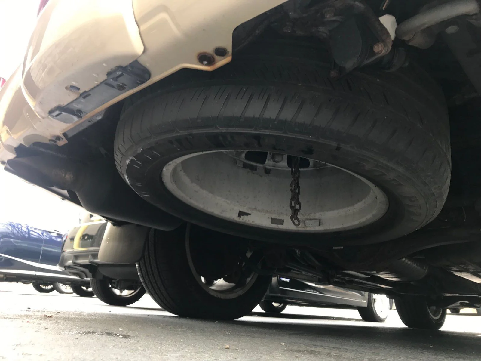

I'm hoping you kind folks can help sanity check this for me, as well as provide some commentary on the underside images as I realized I didn't really know if what I was seeing was bad or not.

    • This is my biggest concern at this point, and I realize I have no idea if what I'm looking at is bad or not
      • Underside pics are at the bottom of this post
      • Hoping to get some feedback on these pictures - should I stay away, or does it look manageable?

  2. How big a concern/potential deal-breaker is the underside?

Flushing the AHC fluid is not a big deal, an easy home project which costs about $150 in fluid and requires only a torx and a 12mm and a small open end wrench for bleeding. You're probably also soon due for new accumulators, which run about $800 in parts. It takes a couple hours, but is not complicated (side steps and then one bolt each on accumlator and some bleeding that is like brake bleeding but easier).
This forum is allergic to rust. However I have to say that looks manageable to me. Perhaps one of the NE residents could chime in? @CharlieS maybe?
Maybe you can budget in $1000 to have it remediated?

With that amount of rust I would be very cautious with AHC. Rust is NOT your friend. I have a hard time believing the AHC fluid hasn't been changed. It looks like the front pressure valve controller has been replaced (look too new), so AHC work has already been done.
Unless you are getting a "crazy" good deal or don't mind doing an AHC delete I would pass for another option.

If I completed this purchase, I would fully expect to spend some money dealing with rust remediation.
The price was $20,500, is that "crazy" good?
As far as the AHC fluid, I'm basing my observation on the fact I could not find it called out in the maintenance history. It's possible the previous owner had it done somewhere else or the dealer didn't note it, but both seem less than likely given the extensive visits to the dealer. I had noticed the difference in those parts from one side to the other (what I'm assuming @tincan45 named as front pressure valve controllers) and had been curious about that.

That's a lot of rust, and that would scare me off - there are a lot of costly bits under any 200, and AHC is a big ticket item - rust makes everything a nightmare.
Mechanically I'm sure it'd be great for another couple of hundred thousand miles, but the rust... I'd plan on big ticket spending if you ever have to deal with the suspension.
The price sounds fair to me, as long as you can live with the rust.

For a $20K+ purchase- that sure looks like a lot of rust.
I’d keep looking.
Try and find a truck out of FL or TX and avoid the salt.

I would also pass on that particular vehicle. That amount of rust is probably reasonable for the age, mileage & location, but if you plan to keep the LX long-term, that rust will be a constant pain.
I also did some rust remediation work somewhat recently; just to give you an idea of what might be involved: Builds - eatSleepWoof's '14 LX. Start at that post and scroll down.

I'm very rust tolerant, but this one is probably a no if you're planning on a 10 year, 100K mile ownership. You'd be starting with a lot of rust. In the second photo, near the top of the image, something is rusting through (exhaust component?) and will need replacement. These rusty trucks really bug me because with a caring owner it's possible to forestall much of that and it's such a shame to have that happen to otherwise great vehicles. You may be able to save this one, but it would be a lot of extra work/money/time and that doesn't fit with what you've told your wife!

As much as I personally wouldn’t want to see a clean southern 200 sent to the land of dissolving cars, I can’t stress what tincan said enough. If you plan to keep this thing for a while it will be well worth your time and money to find one that is a clean slate in terms of rust. One like in the pictures is already WAY behind the curve, and will present problems any time you have to loosen chassis bolts for suspension, exhaust, drivetrain, rear brake, or other work. Even if you clean it up, you just won’t be able to address the cancer that has worked its way into all those fasteners and nooks & crannies. I’m not saying the frame is compromised.. just that you are saving a little money now only to have headaches later.

I picked up a 2009 LC with 140k on it for about the same price. One owner and same area. The owner lived in Pound Ridge NY which is a stones throw from Greenwich. Insane overkill maintenance. The dealers paperwork was stuffed into the manual. It had 70% less rust than the pictures posted. Mainly on some bolt heads, KDSS, and general light surface stuff with the exception of the transmission guard that was completely rotted and the tow hitch area was in bad shape. Drop the factory guards and I bet you will see more rust/rot.
If your getting an older platform vehicle and want to keep it for a 10+ years expect to drop 2-3k replacing worn parts and fixing minor issues and maintenance. It might be under 1K but be ready for the higher side JIC. The LC platform is not cheap to maintain. Can someone remind me again how much oil for an oil change? More than a gallon?
My 2 pennies are stay away. Be patient. You'll find one.
If you can take a pencil and flake off chunks of metal and rust you have a problem.
