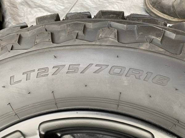

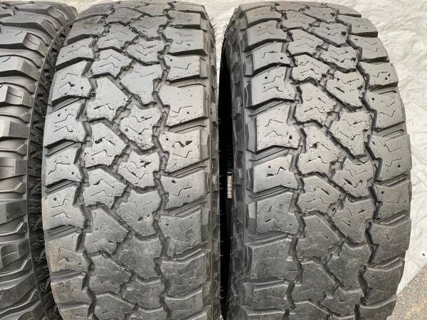

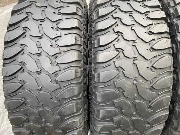

What about this set? Should I make an offer?

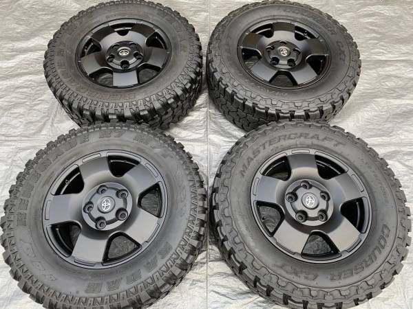

275/70r18s TPMS sensors included, asking price $600.
If I buy a set with sensors, how do I go about programming them in? Do I need tech stream cable and software?
I called to inquire, good guy.
He said $450 for set without lug nuts, 500 with lug nuts.
Let me know what you guys think.

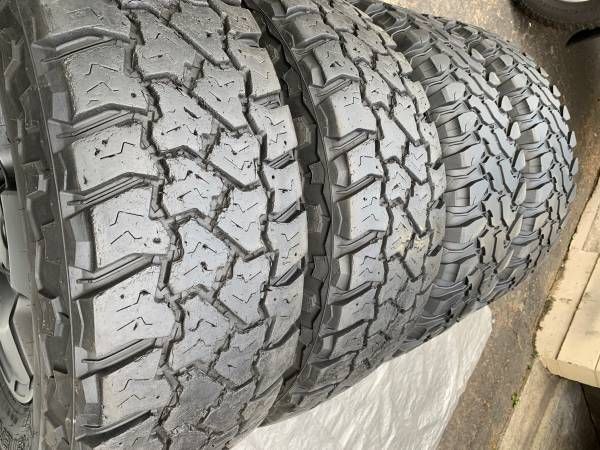

My experience with CL buys - check the DOT date on the tires. Verify the tread depth.
On these specifically -> Yes, you'll need to do something with the sensors, either move the ones you have, or get new ones that can be cloned. Tundra sensors don't work on the 200 platform. There are some sensor options, ranging from DIY (buy sensors, clone, break the bead and swap out) to go to a tire shop and have the swap, to go to a tire shop and buy and have them program. Costs increase with each option, but the cheapest will be $30/wheel for the sensor, buy/borrow a programmer, and involve Carista or Techstream
Be aware those rims look boss, but weigh 33lb each. Some of the other tundra 5 spokes are in the 28-30lb range.
Im glad I asked. I called discount tire and asked about moving sensors and they quoted me 16 per wheel (8 to remove tire get sensor out and 8 to put back on), so for 8 wheels it will be about 130 bucks to move my sensors. That’s enough to make me reconsider whether these rims are worth it.
Going to continue scratching my head on this one for a little bit.

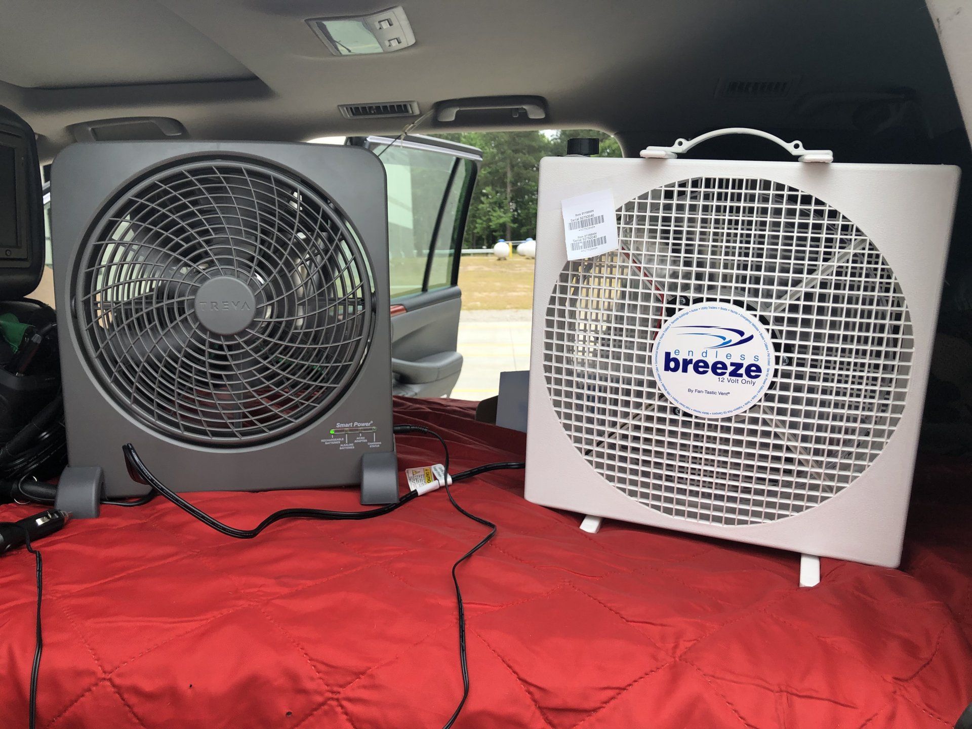

Both of Tigers fans are in. I will do a comparison video at some point.
Endless Breeze is about twice as strong, but costs twice as much.
The O2Cool has a built in 1000mah battery and can run on D batteries as well. You can also plug it directly into wall or 12V outlet.
Basically the O2Cool is nice in that you can run it without an external supply, so it is truly portable. If I was going fishing or away from the car and don’t feel like carrying my power banks, I’d bring the O2Cool with me.
If I had my power bank with me and only had 1 12V outlet, I’d plug in the Endless Breeze.
My plan is to get a Jackery at some point (maybe now because Mother’s Day dale, but it might leave me with not enough for tires so I’m thinking), and run both (O2Cool on 110v and endless breeze on 12v). Tiger will need quite a few fans to keep cool this summer. I also have a few small USB fans as well.

I wouldn't get those tires. The brand doesn't come off as a well known. Personally wouldn't want my only contact patch with the road being a brand I didn't know much about. So that guy is probably looking to make a profit with those tires.
Also they are 2 different tires, which would be another pass. Look for a matching set of tires.
Thank you for the advice. I started leaning away from them when grinchy informed me of the incompatibility with tundra TPMS sensors, so I will keep holding out for a set that either has compatible sensors, or one that is worth justifying the price to add and program new sensors.
As far as 2 different types, as long as the price is good I can live with them. I didn’t want to be too picky at my price range, but at the same time these aren’t cheap now that I factor in sensors. The biggest reason I’m not picky is because even 2 diff treads will be a good upgrade from my current tires, pictured below for reference. Mud is from getting stuck 2 days ago.

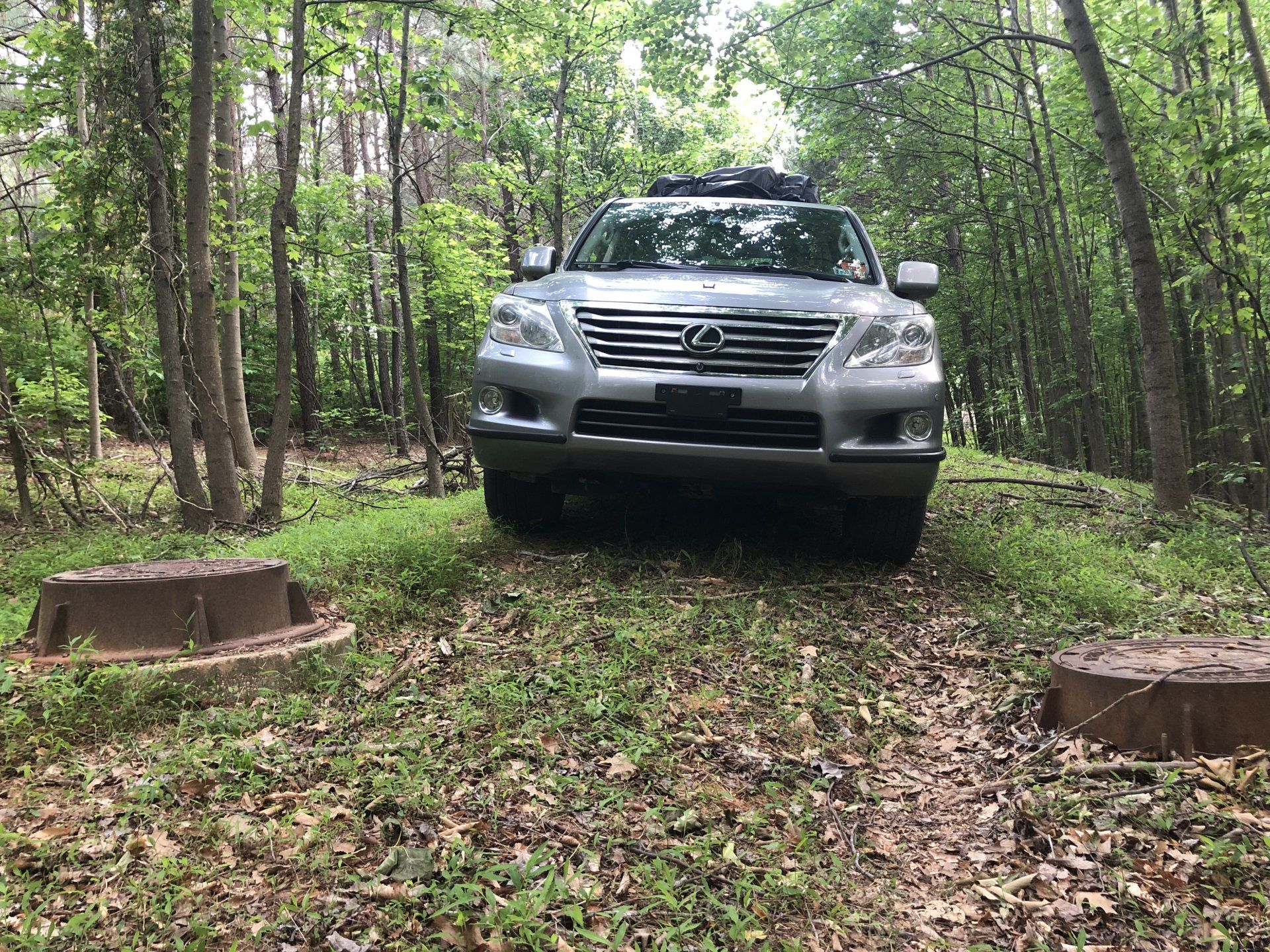

Gonna stick with an easy, mud-free trail today. Found a nice spot along it where I can park off the trail and camp for the night. Also dropped off the bike for a few days so I can access my cooking stuff from the back again! Haven’t cooked since I loaded up the bike lol.
1) The off road/front and side mirror cameras are useful for narrow crossings.
2) Almost had to put away the carrier due to departure angles again.
3) there is a little creek that I can see from looking out the back of where I’m parked.
4) that fan makes a HUGE difference in how it feels in here. If only it was rechargeable then I’d return the O2 fan and get another one of these instead. I’m using the 12v output from the Renogy 72000 mah power bank to power it. Would love a Jackery so I can charge my power tool batteries and run the O2Cool at the same time. I’m just in love with how nice it feels In the car right now with this nice strong breeze flowing through!
I also forgot to get dinner first smh. Back out we go!
Good thing this trail is in the middle of civilization.
