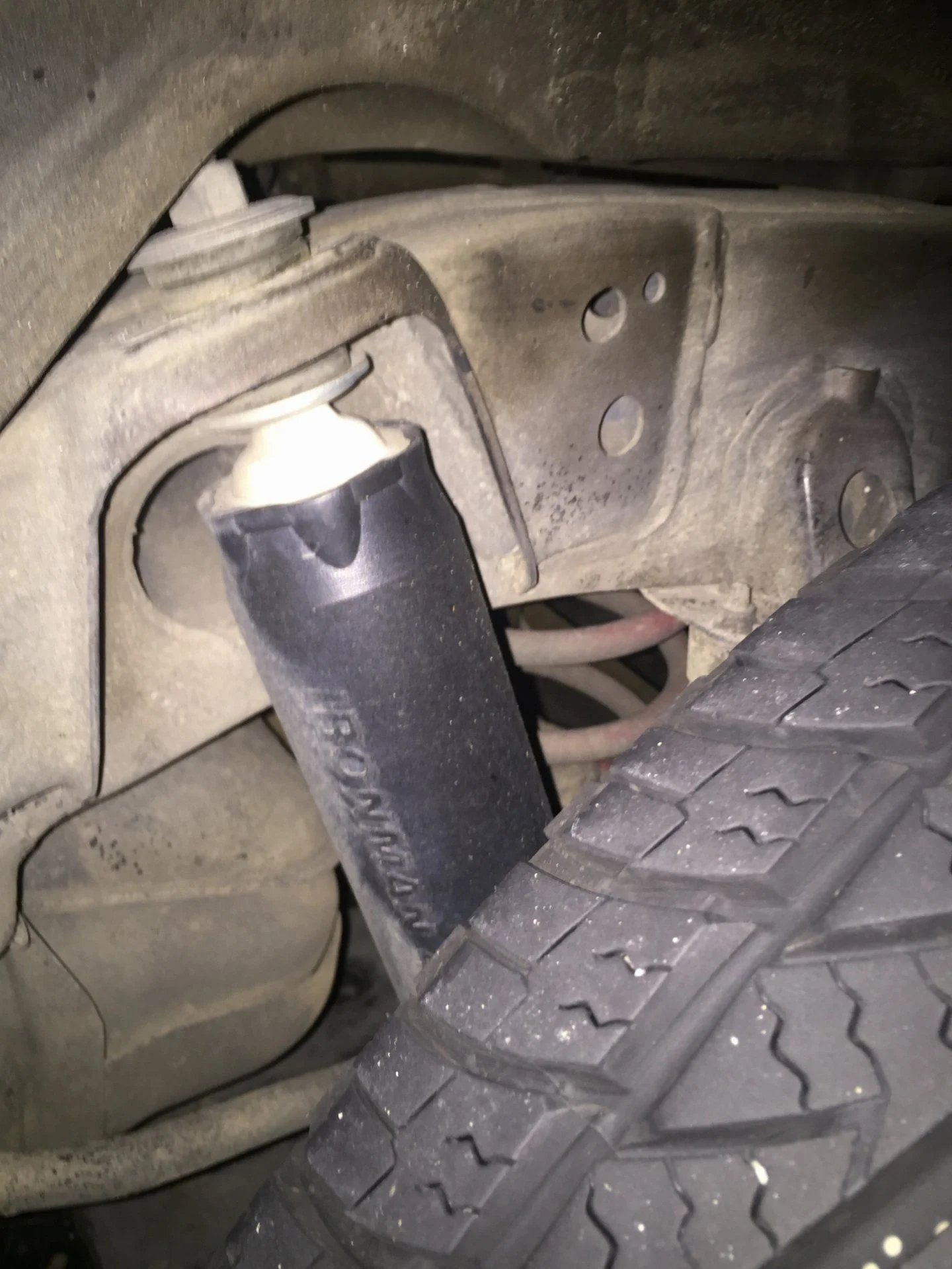

I was told by the previous owner that my vehicle is installed with Ironman 4x4 suspension shocks.
I find it quite stiff but has great road handling abilities and it's rattle free.

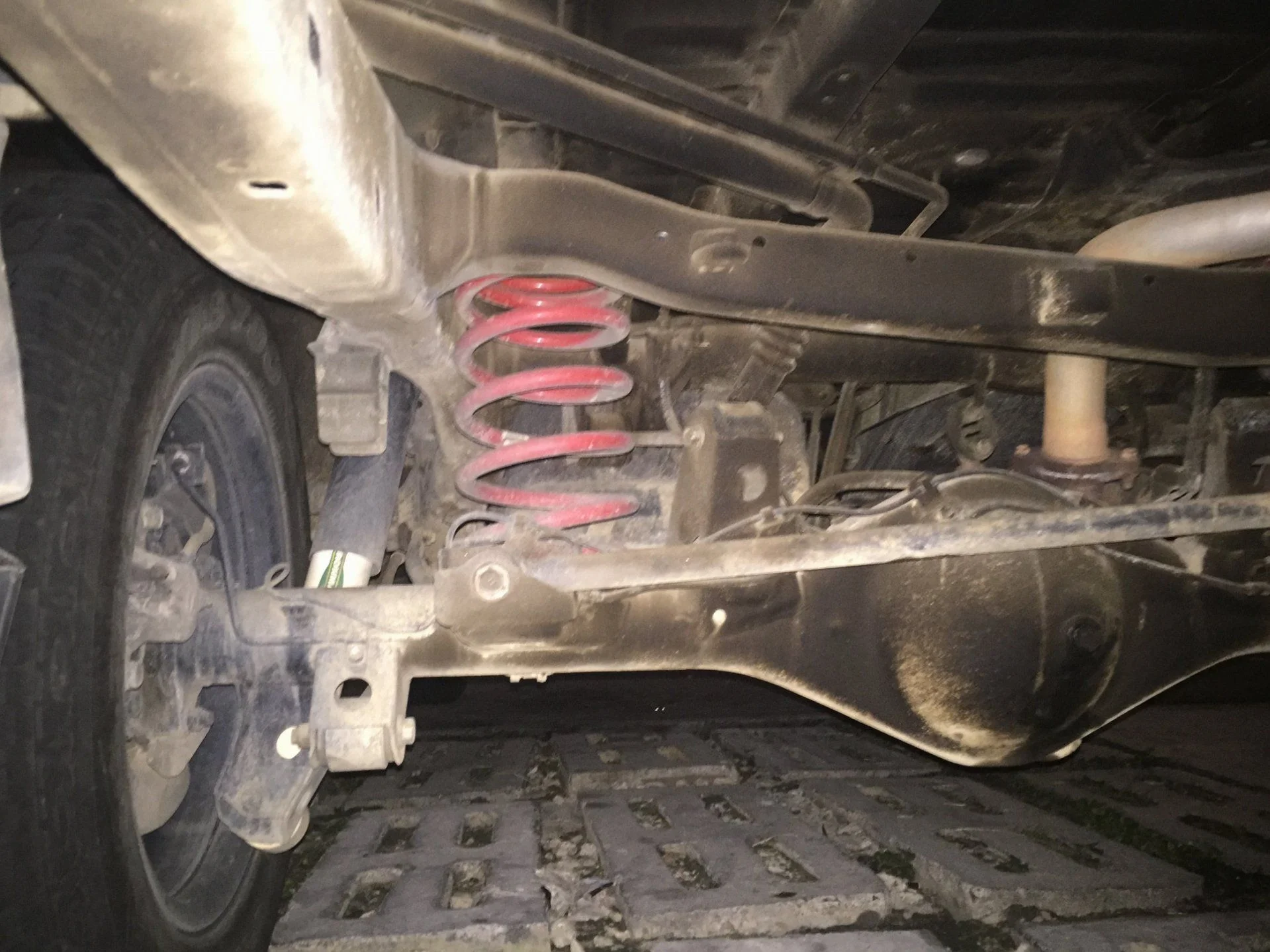

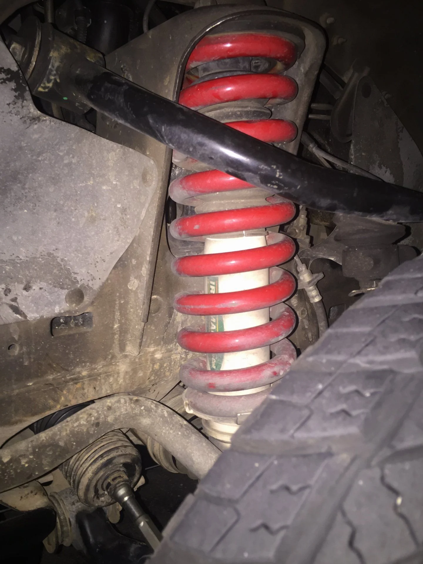

Can you get a close up of your front coils? Can confirm. You can change the spring rate in your lift (Iron Man sells different springs) to make it less harsh.

Your spring rates definitely look too high. Zero compression at rest means they "bounce" over bumps vs down travel.
